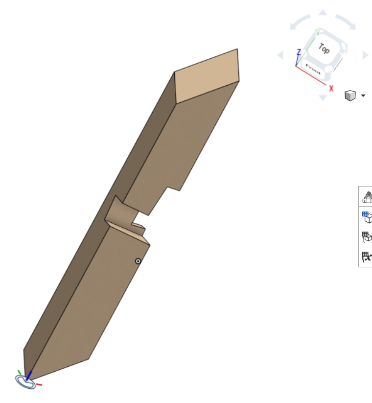

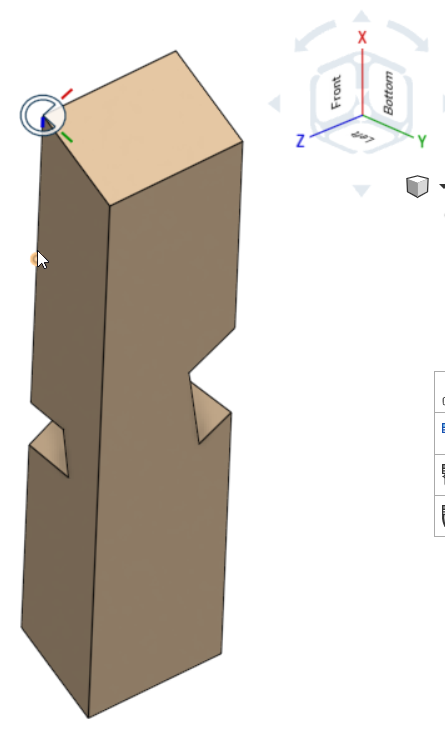

I'm facing an issue to create a drawing of an object (an inclined wood beam with cutouts) whose the 3 axis of reference are not aligned with the reference axis system of the part studio (see illustration below). (https://cad.onshape.com/documents/ebf002a1ff45a52d801e6eed/w/3359f17212fd50a58f7a11c7/e/439f195de9388e3e90acbabc?renderMode=0&uiState=694bc2c3dea6cb1314780a89)
What I need is to create some auxilliary views having the axis of reference definied by the mate connector (see pictures below) . The auxilliary view option of the drawing interface does not seem to be approriate for that (Normal or In line).
Is there any workaround solution or any hidden features in Onshape to allow tracing these drawing views ? (Two possible solutions : to duplicate the part and rotate it along two axis to have it aligned relative to the 3 axis of the part studio or to align it with mate connectors in an assembly and then create a drawing from the assembly…quite a pain)

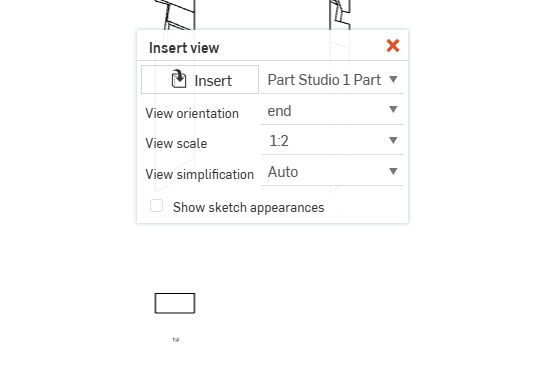

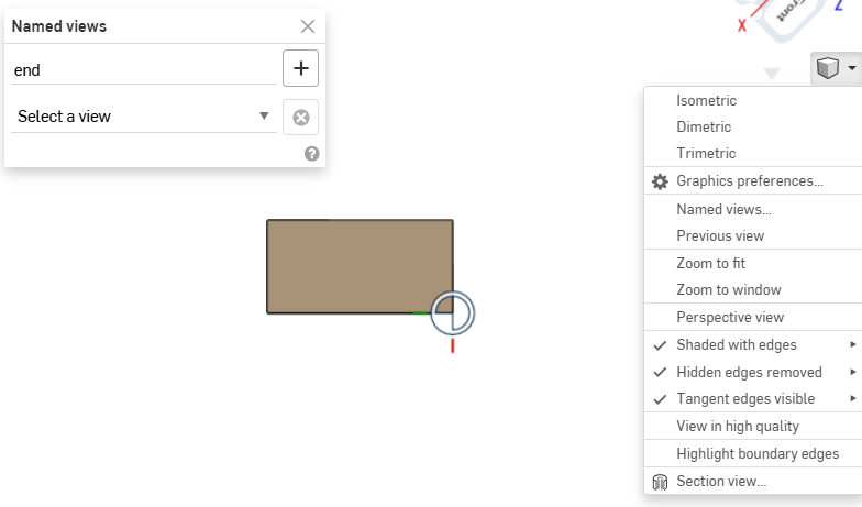

    You could use named views for this. I used the mate connecter to set view normal to end then turned it into a named view.
    Called up the 'END' view in the drawing to see the end then added auxiliary views.

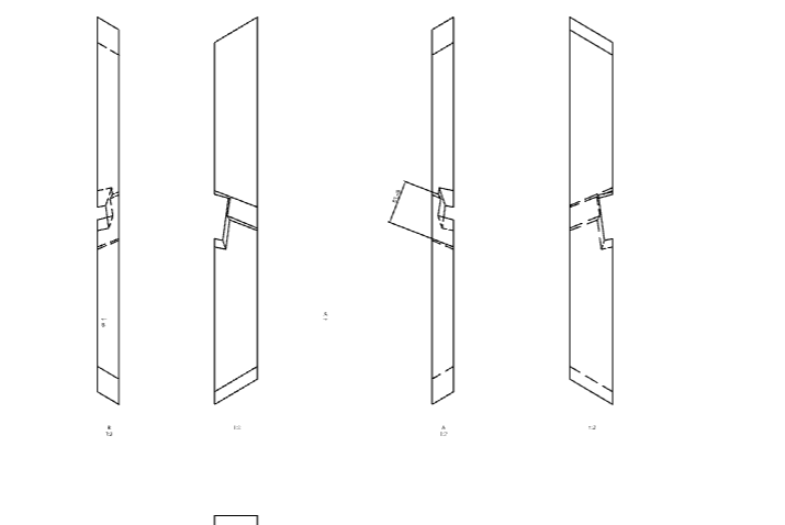

    I've just figured out that your method fullfill my need, however, I found out one drawback : each time you modify the part (eg. its orientation), then you need to save a new view (so far so good). Then, when you open the drawing and update it with the new view reference , all views on this drawing are superimposed and cannot be rearranged properly and are not correclty projected. Any hints to solve that ?

    Yes, that is true. When you reorient any part in an assembly, however, and then open the drawing which is drawn from that assembly, all views of the part are always no longer aligned as before. That is just the nature of assemblies. To get around this, if possible, always make part drawings from the part studio or (if you need the part together with say fasteners in the part drawing) make suitable subassemblies for the drawings.
    Taking this a step further, one could come up with the idea of making view orientations parametric: Say place a mate connector on the part to define the primary and secondary view direction and make that MC selectable in the drawing view menu. That's one for the developers, though.
