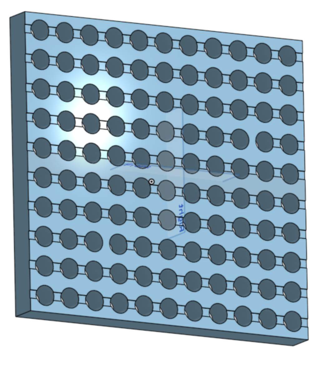

Helly, i have basicly an plate 500 x 500 x 10 an like to bring ist in 4 items and paste it together like an puzzle.
is it possible?

    Hello Benjamin. Not sure of your intent. The title of your post uses the word 'cut' suggesting a 'take away' action, yet the text of the post used the word 'paste' suggesting a join operation.
    Yes, it is possible. If the 4 other 'items' (parts) are created in the same part studio, use the Transform tool to locate them into the position you like. If the parts are from elsewhere, use the Derive tool to bring them into your part studio and use Transform in the same way. From there, use the Boolean tool, selecting the Union option to join (paste) the parts together or Remove to 'cut' one part from the other. - Scotty
