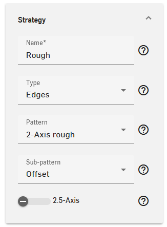

When I create the toolpath "Rough" for the 0.25 inch endmill, I select the bottom loop of each part and set the strategy up as follows:

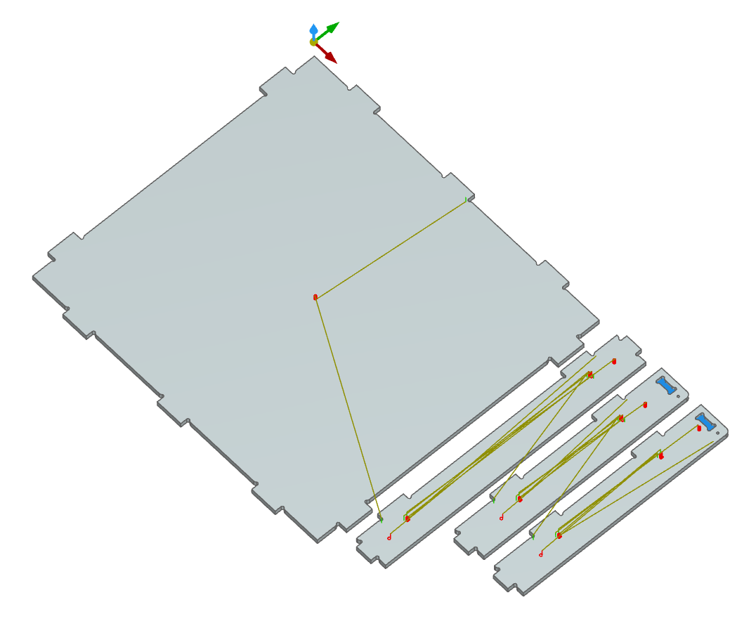

After generating the toolpath, though, I see a toolpath for completely unrelated parts that involves drilling pockets, not outlining the parts selected.

Also commenting to note that this has been reported and acknowledged as a bug, since, you know, that's definitely not my geometry in the second image I posted.

@jeremiah_peschka840 2 axis rough will always try to machine within the 2d containment. The only way to force the tool to machine outwards is to enable re-machining + job stock. Or, you can use bodies+ rough to achieve a similar result for multiple Z depths.
2 axis rough. Enable re-machining based off of stock.
