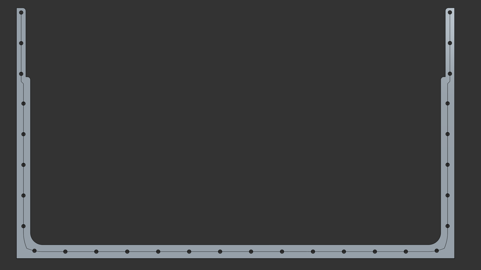

@Caden_Armstrong public now. and yes, for my intended use case, my script lets me make a line of holes with one feature, and fewer clicks, at the expense of some functionality that I rarely use. Also, making the line of holes automatically go to the end of the part means it updates if the part changes. I plan on doing something like a second direction, but it will be more of a "clone row" so you can just have multiple rows at multiple MCs.
For our robots, almost 100% of our holes are 0.200" and the majority are spaced 0.5" along a straight line.
I've been meaning to develop the generalized version of this that handles arbitrary face shapes for some time. We draw a lot of weirdo spline geometry that needs a hole pattern up the centerline of the parts, so Flange Warlock will one day come out of the backlog and see the light of day.

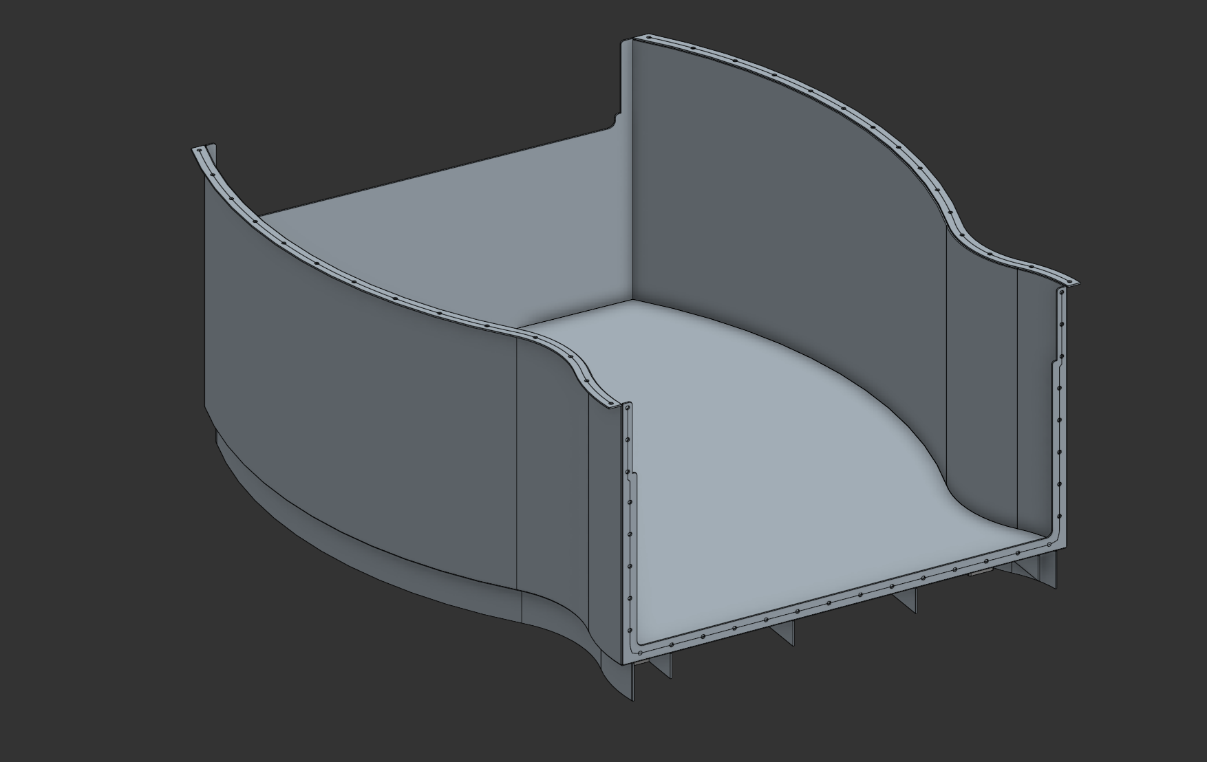

@joshtargo without showing off anything too proprietary about the construction of some of these projects, here's a sample reservoir section from one of our builds. Most of these table sections have these bolt flanges that are wiggly shapes on the handrail sections and the table segments bolt together with a flange that varies in thickness from the top to the bottom of the part and around the corners. Ideal bolt locations for these connecting flanges would be placed on the exact medial axis curve for the flange. For simple rectangles or paths with a consistent cross section it's no biggie, but variable thickness geometry presents a much more non-trivial problem to be solved.
Specifically these flanges are the challenging ones

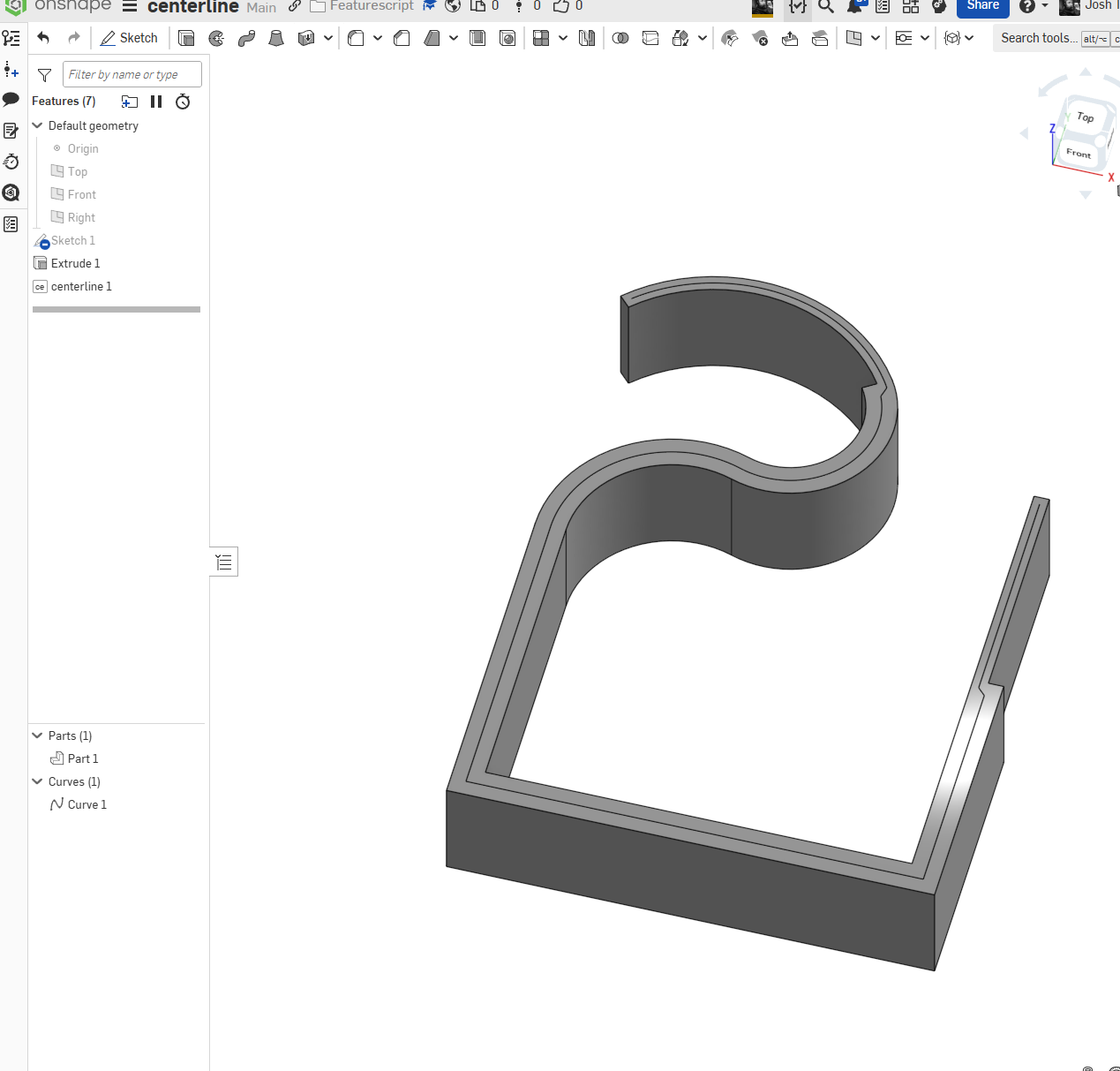

Offset curves from one edge or the other are necessarily biased towards their side, so the development of a better medial axis function is the first step. I've done it 3 different ways now without being satisfied enough to publish my methods. Delaunay Triangulation was one route but it's slow. Tween Curve is pretty solid but requires knowledge about edge chains that I'm trying to avoid the user needing to input. There's the rooftop method where you extrude a face with a draft and extract the peak curves and project them back to the face and that's what you see being used here, but it has a lot of failure cases to resolve.

The medial axis method I'm currently using sort of takes care of the first and last hole distance by placing the hole directly on the end of the curve, which should by definition be equidistant to all of the things at the end it's supposed to be equidistant to. Then the spacing in between would be some flavor of spacing chosen by the user. Maybe the holes need to be precisely 3" apart or maybe it's by number or maybe it's as close as you can get to 3" spacing while maintaining start and end conditions. The hole spacing is the easy part, really. It's the medial curve generation that's been doing my head in because I don't live in a world with nice rectangular profiles or consistent part widths.
Yeah I've been attempting to find a way to handle the extrusion distance intelligently and gracefully handle the cases where the draft step fails but it's been nontrivial.
I need a largest inscribed circle function to do the distance properly with this method, or an iterative solver if that doesn't work and then try to plug the final distance into a cache0 -
Tried another 2 whitepapers, still no luck finding a robust and performant medial axis method. Starting to think I might need to do foundational research myself which is never a great place to be.
