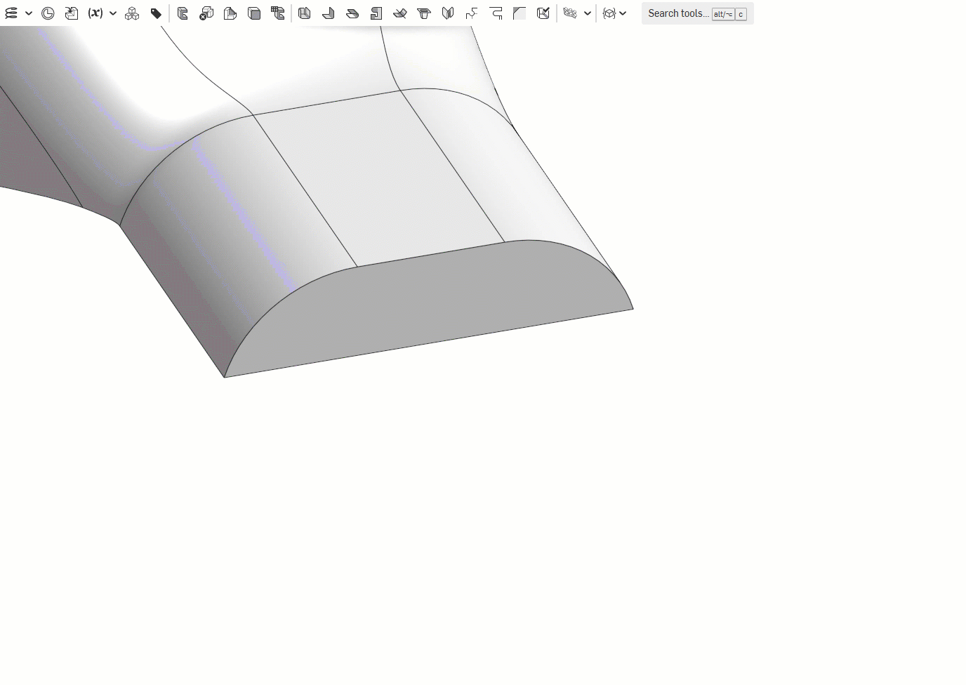

Here is a short tutorial on how to get REAL textures in Onshape.
Let's see what you guys can make! Post your cool textured models below. 😎
Example Document to get you started.
Shout out to @EvanReese for creating the mind-blowing Displacement Map feature + Image to CSV app.
Also thanks CADSharp Spin (Onshape Summary Image) - No background.gif CADSharp for sponsoring this tutorial.

  • MichaelPascoeMichaelPascoe Member Posts: 2,736 PRO
    That elusive update for the Texture feature is under way. Should see some easy "1 click" texturing soon.
    This update will not only allow it to texture multiple adjacent faces at a time, but will also have the option to use some preset displacement maps like shown above.
