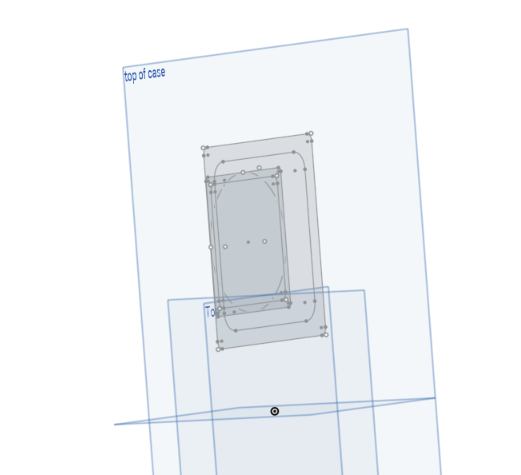

HI folks,
New here though been using and loving Onshape for a while. I am making a fan mount with the larger base being fixed to the casing with threaded inserts. The problem I have is that I want to loft between these 2 shapes. They are similar simply creating the 2 planes and the doing a solid loft then shell won't work as the corners in the base I want to add the threaded inserts will be to thin.
Any ideas on how i would do this?
thanks
  • martin_kopplowmartin_kopplow Member Posts: 1,302 PRO
    The limitation here is you can't currently loft a ring (or any face with an inner shape). So, You'd need to do that in two steps:
    • loft outer shape as 'new'
    • remove-loft inner shape
    Or you could
    • fill the two ring faces of your 2 sketches (thereby creating two ring surfaces),
    • then loft-add the inner and outer surface of the body.one by one
    I see no reason why this couldn't already be automated, but ther apperar to be logic issues and so it hasn't been done yet.
