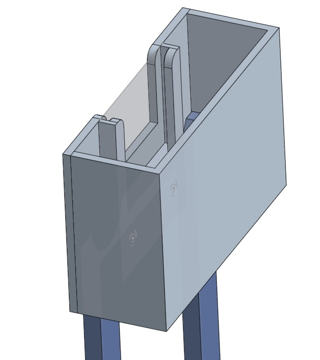

Hello,
I want to design a holder for digitising slides; the iPhone will serve as a light source behind the slide (as seen working in a video) and there will be a removable slide holder in front of the iPhone, removable to accommodate the different thicknesses of the slide frames.
I first designed the part to which the slide holder is attached using two screws as a whole, and then splitter it afterwards. The problem with this is that not only is the slide holder separated from the frame, but also the front plate.

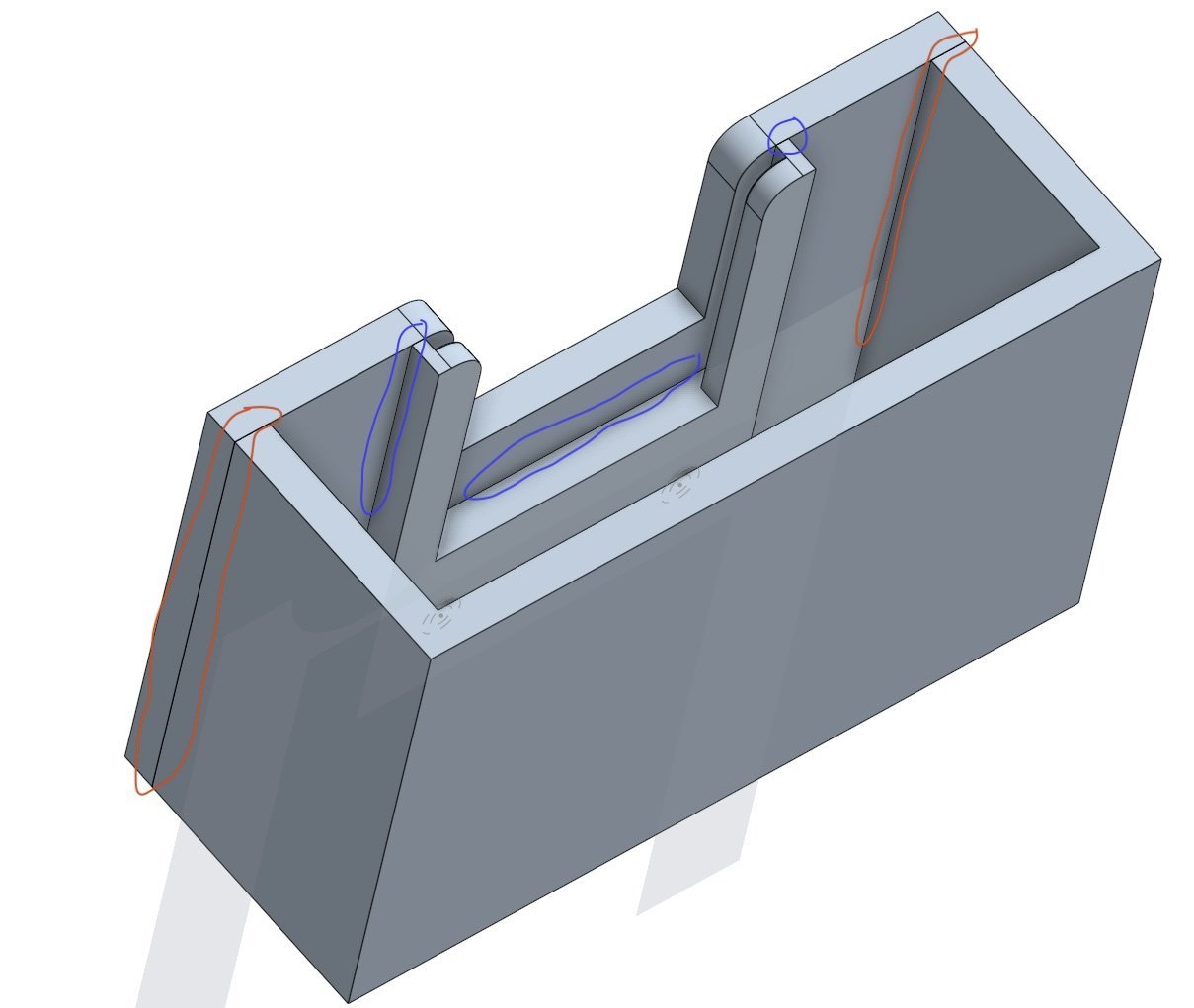

How can I split it so that only the slide holder is separated?
In the attached screenshot, splitting should be done at the blue markings and not at the red markings.
Another question: how can I use a constructed slide holder to construct others that are suitable for thicker frames?
The only option I have found is to duplicate the whole part studio and delete everything else, or possibly export the slide holder as .stl, then enlarge the space for the slides and export again.
Kind regards
ProApe

  • Matt_ShieldsMatt_Shields Member, Onshape Employees Posts: 899 PRO
    You could create a surface to split with. Then make sure you select "Trim to face bounaries."
    As for the second question, maybe configure your part, so you can select different configurations to export.
  • ProApeProApe Member Posts: 226 ✭✭
    Unfortunately, creating a surface to split with exceeds my knowledge of Onshape.
    But I have just found a solution: I split the slide holder, which also separates the front plate. Then I add the front plate back to the rest of the frame using a boolean operation, and it works.

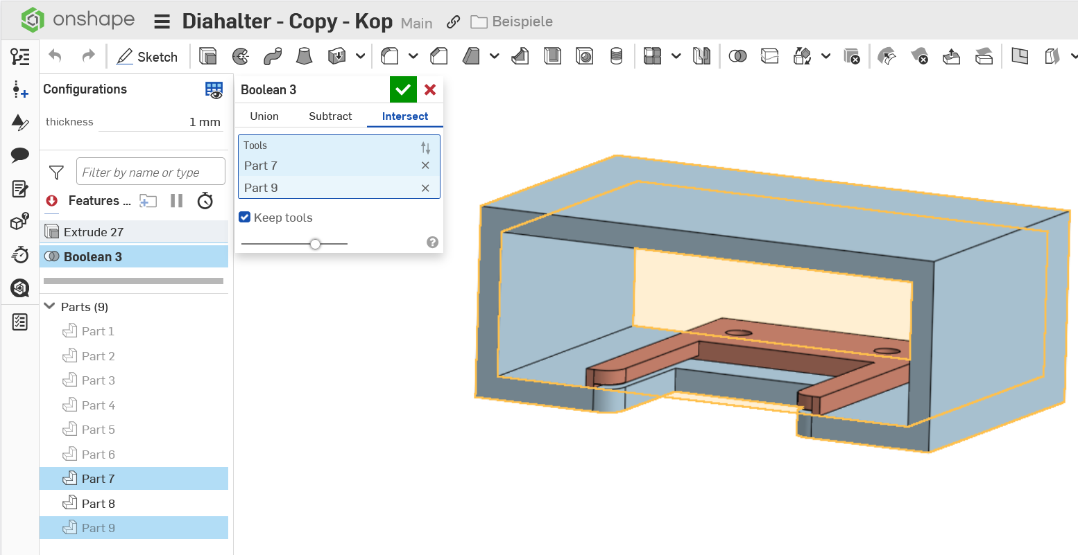

    Du könntest einen Klotz im Inneren erzeugen und dann eine bool'sche Opearation mit Überschneidung anwenden, um einen separaten Diahalter zu bekommen.
    https://cad.onshape.com/documents/20e06b031fc6c325155a6d3b/w/25130bda3ac53740f6ce0130/e/155fccf3a562fc500c890872?configuration=thickness%3D0.001%2Bmeter&renderMode=0&uiState=696a17666ceb04d49a12374a

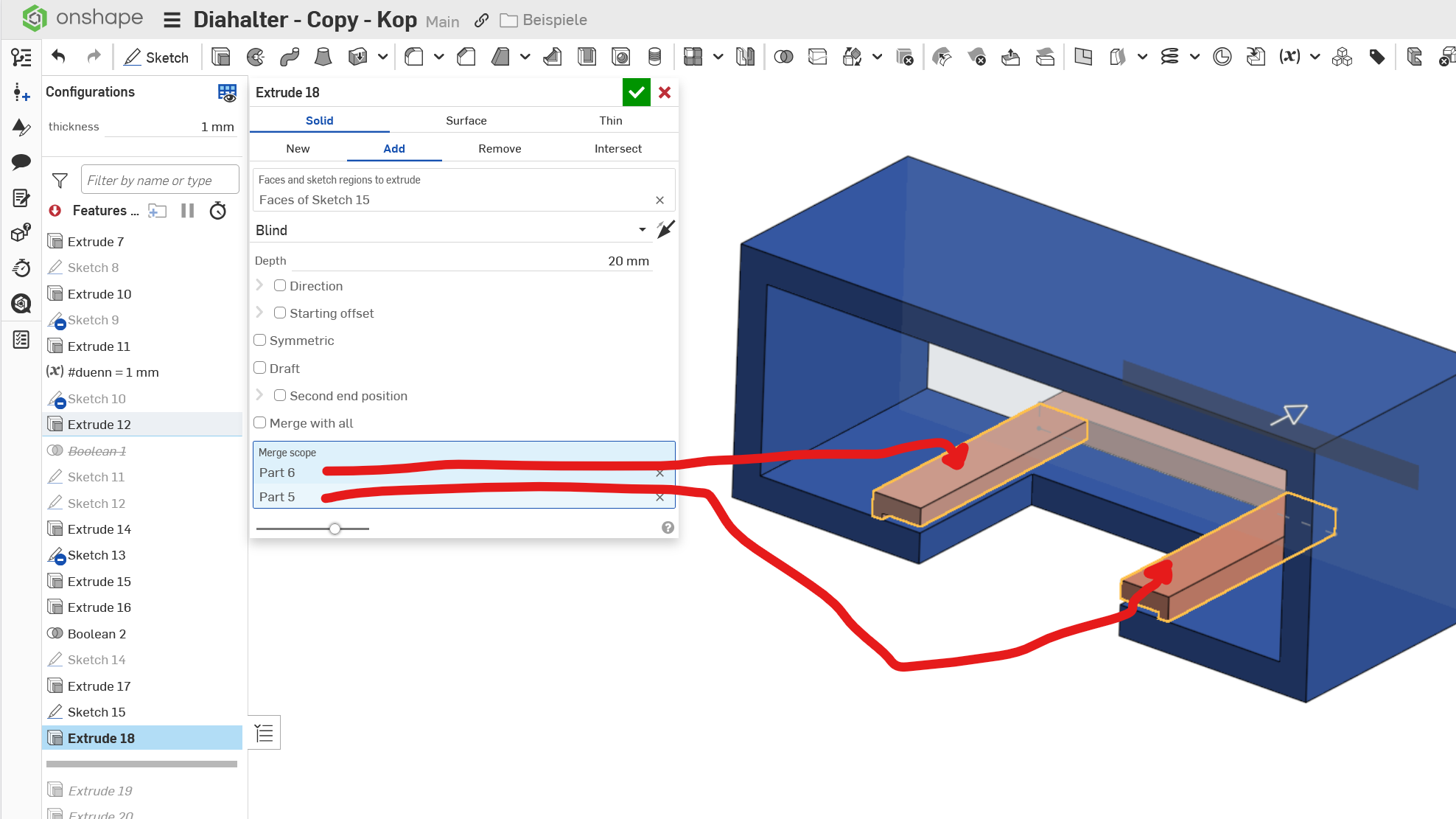

    Naja, wenn Du die einfachste Lösung gesucht hättest, wärest Du zu dieser Stelle (Bild) zurückgegangen, an der der Dia-Halter noch einzeln war, und hättest bei den darauffolgenden Schritten (Extrusionen, etc.) nicht die "Hinzufügen" Option benutzt. Dann wäre er einzeln geblieben, und die erneute Trennung nicht erforderlich gewesen.
    Dann hättest Du bei Extrude 18 mit der richtigen Auswahl bereits einen einzelnen Dia-Halter gehabt:
    Ich habe den Eindruck, dass Du von einem Direct-Modeller CAD kommst, kann das sein? Das ist nichts schlimmes, nur Deine Strategie sieht danach aus. Wenn Du etwas mehr in die Parametrik reingekommen bist, werden diese Dinge ziemlich naheliegende Lösungen haben. ;0)
    Du baust derzeit eine Änderung auf die vorige. Es ist aber (fast) immer sinnvoll, zu der Stelle zurückzugehen, an der ein Teil, das man ändern will, ursprünglich entstanden ist und die Änderungem quasi im Augenblick der Entstehung vorzunehmen. Es ist wie eine Zeitreise, in der man seine Eltern als Teenager trifft. Das macht die Sache aber robuster und übersichtlicher. Der Feature-Baum wäre vielleicht noch 1/3 so lang, und hätte vermutlich keine einzige boole'sche Operation.
