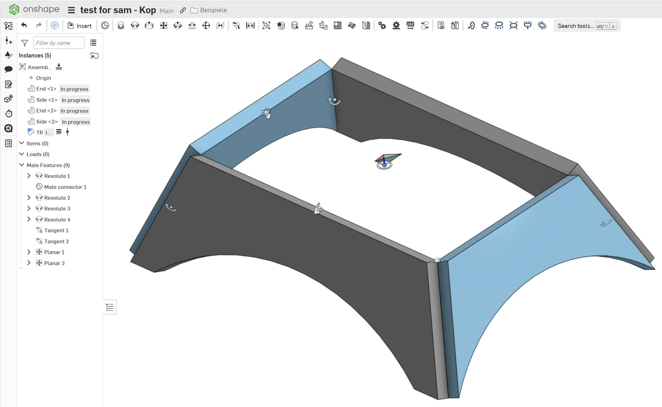

The Assembly in this folder has two parts that I want to join along the end edges resulting in both parts leaning inward, like two sides of a pyramid. I have tried Fasten mates at both the midpoint at the edge and at the top of both parts. The midpoint is close but does not want to slope both pieces. Any suggestion or solutions would be appreciated.

Maybe you want to try this.
You need to let the system find the lean angle for you. So, it might be a good approach to use the rotate instead of a fixed mate.
Hey William. Is this what you are trying to achieve? - Scotty
If it was me, I'd start from scratch with something like this - everything lined-up and centered - much easier to work with - https://cad.onshape.com/documents/7885295bd717be1d6d77bac0/w/5aa7a21ad83164edaf634126/e/c297158cde7ffef96d0e6cba?renderMode=0&uiState=696bd20b3404320170626327
You could keep the central 'construction body' and hide/show it as needed.

Yes, this is exactly what I am trying to do. I will have to copy your and look at it for a while to completely understand exactly how you did it. Question: what is the Triad and what is its purpose?

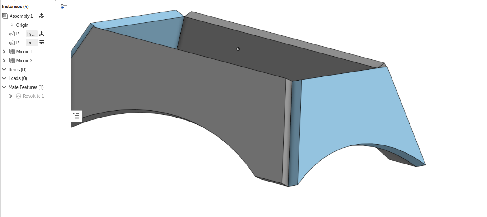

This is one of my thoughts are how to position and accomplish your assembly.
Sure wish 3 point plane was available in sketch mate connector.
https://cad.onshape.com/documents/e113f7eed3c72dc9f3b890ac/w/cbfed826a209d1451d332c0a/e/5ddef27306fb1beaabfb1d0b

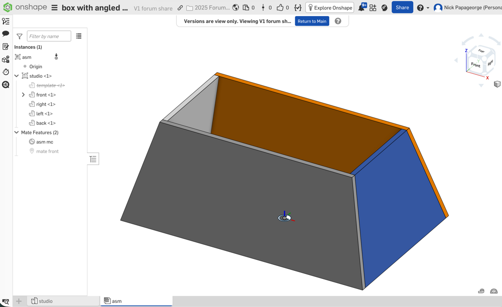

William: What are you planning to do in the corners? What type of joint will be there? Are you building this for real? Is it 3d printed, wood, or something else?
Here is fine tuning what CADNurd started. This is for a butt-joint corner style. Notice extending the bottom is required before the split. The splits get the whole design flat on the top, flat on the bottom, and make the butt joints.
The assembly is just a rigid insertion of the part studio, with the template part supressed. Or, delete-part of the template could have been used in the part studio before the asm was made.
Now, if you want to change the size of the box, or the angles of the sides, everything will update easily.
