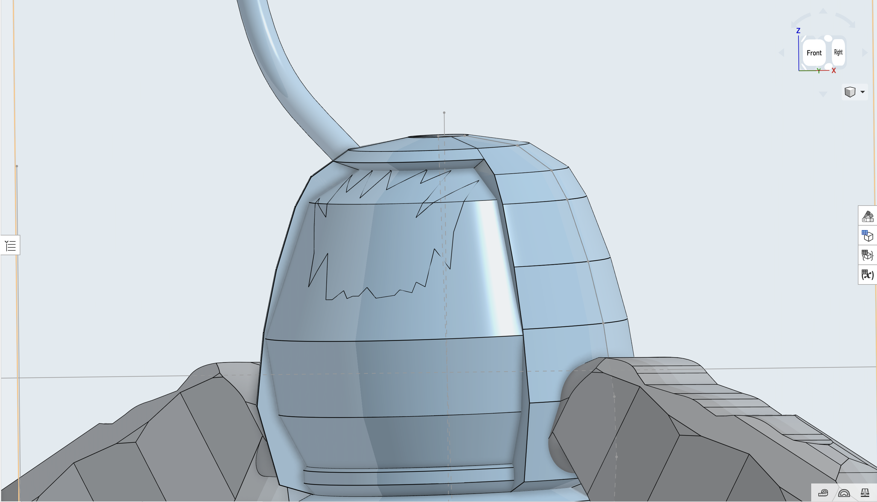

My remove(extrude) isn't working as it is supposed to be.
jenny_hong859jenny_hong859 Member Posts: 4
https://cad.onshape.com/documents/11345f4a5361f90db812257f/w/e9e2df1f086e7edc1ab99be9/e/3fcfecf97621c4e5d380eca6
This is the link to the document^^^
Hi guys. I got a problem with my remove and I have never seen such thing before. What I did is first make a new plane, make a sketch on it, and extruded it. However, the part wasn't removed and it only left border line(?) of the part. I have no idea what this is. If anyone have an idea can you please help me?
(This is what it looks like)
  • wayne_sauderwayne_sauder Member, csevp Posts: 651 PRO
    @jenny_hong859 You will need to include part 10 in the merge scope for that extrude.
  • jenny_hong859jenny_hong859 Member Posts: 4
    Thank you for your feed back! I had no idea so I just selected merge with all and it is fixed now. Thank you for your time and consideration!
