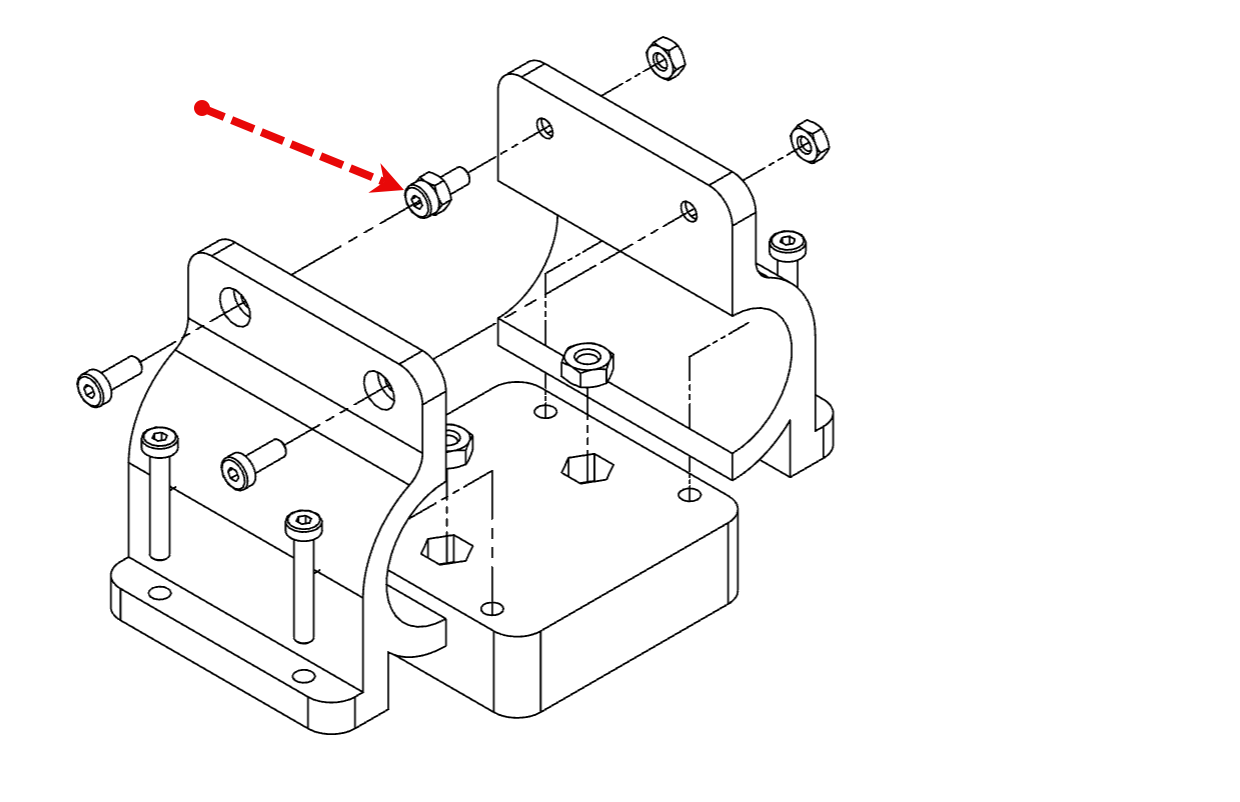

I have an extra screw apparently in my assembly's exploded view, and it is hidden on the assembly (good) as you can see:
However in my drawing with that view inserted the screw shows back up?
Have you updated the drawing?
Do you need/want the extra screw in the assembly? Hide/show is not a great way to manage a BOM.
Agree with @S1mon, however, if you need the screw for some reason and just want it hidden in the drawing, you will need to look into display states.
