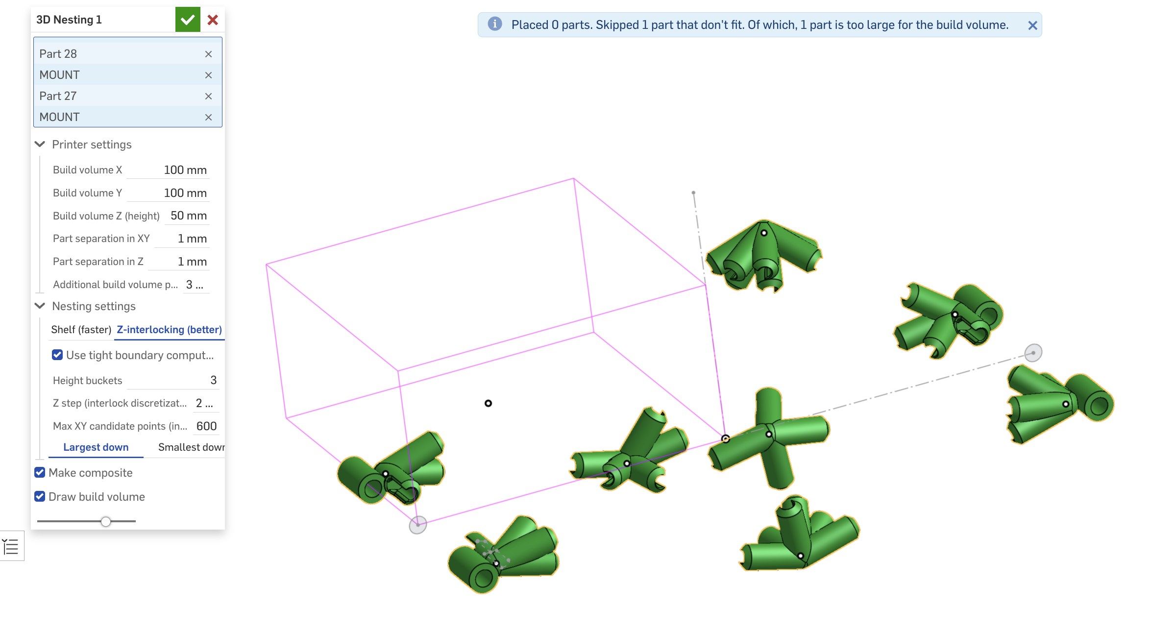

  5. Nesting (shelf-based with optional Z-interlocking)
    And finally, the nesting tool itself.
    This feature arranges all selected parts and composite parts within a user-defined build volume according to specified nesting parameters, such as spacing, height bucketing, and optional Z interlocking.
    Parts that cannot be placed within the volume are explicitly reported, and the resulting arrangement is generated as a single closed composite to support efficient single-file export for downstream operations such as slicing, simulation, and build preparation.

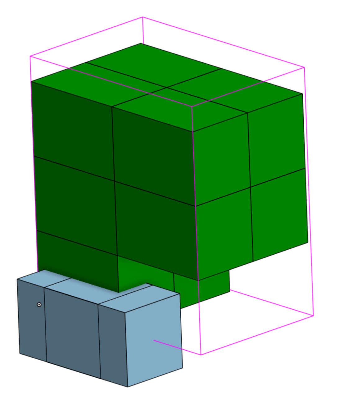

    I'm trying this out - see if it can be helpful with pallet layouts.
    In this example, it will not place all of the parts in the volume. I have created a rotated copy (since I know that my layer needs to be 3 boxes in 1 direction, and 2 boxes in the other direction for a GSM pallet layout) but it will not place them all.

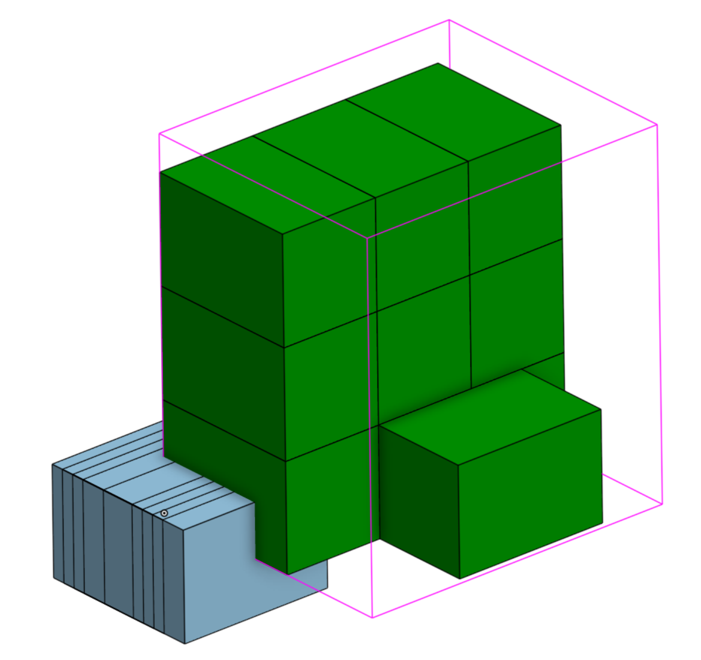

    In another example, it won't place 2 of the boxes (simple 4 boxes on a EUR pallet) on the bottom layer, but will place all four boxes on layer 2 and 3:
    If I make the length of the volume 2 x box length +1mm - it works! All spacing values are set to 0mm.
    It does not seem to rotate the parts - which is why I manually created a part rotated 90deg in my first example.
    I know this was not developed as a palletizing FS, but it's kind of close! Any known issues you've found that might fix my issues?
    Thanks!
    Romeo

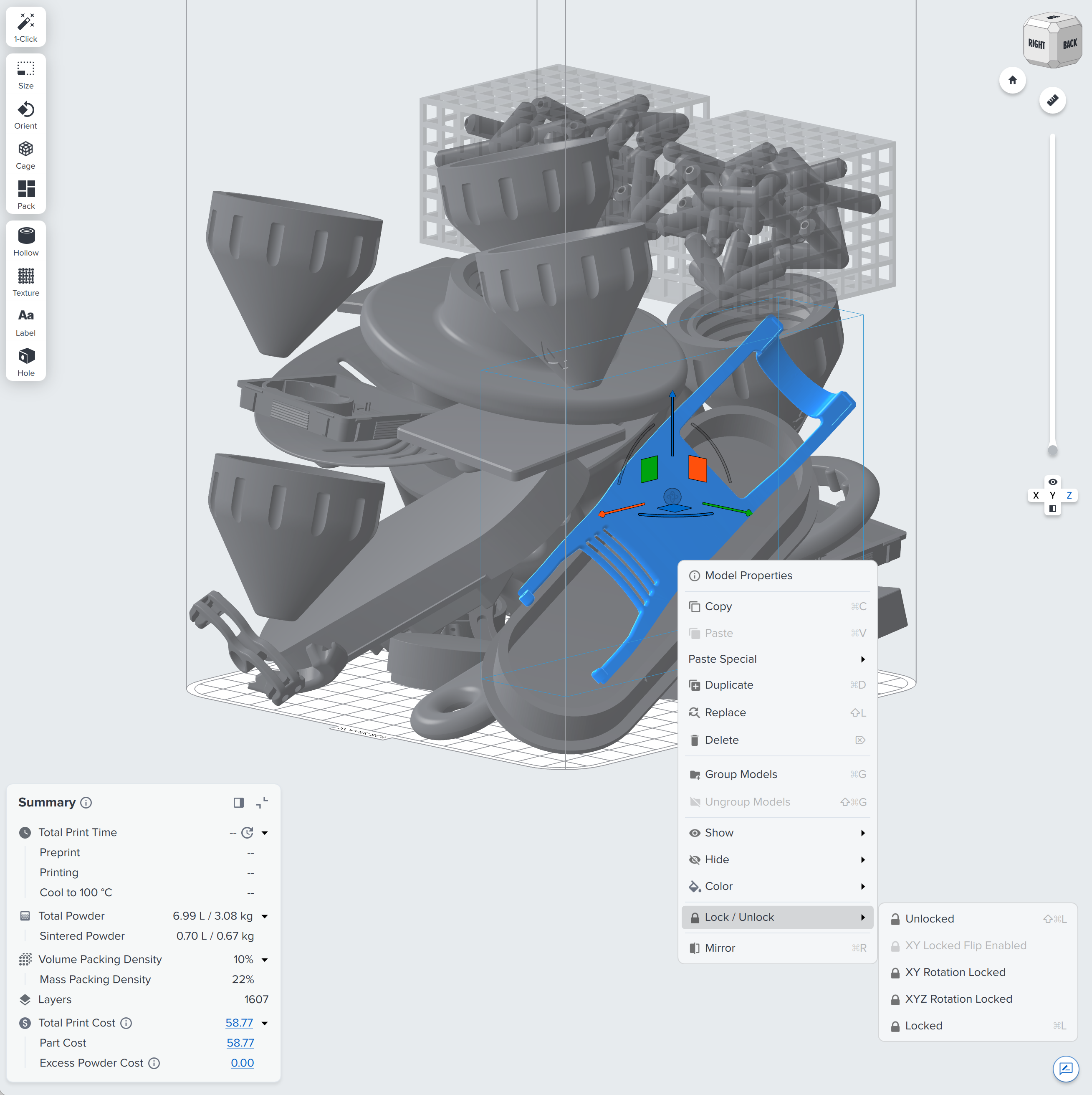

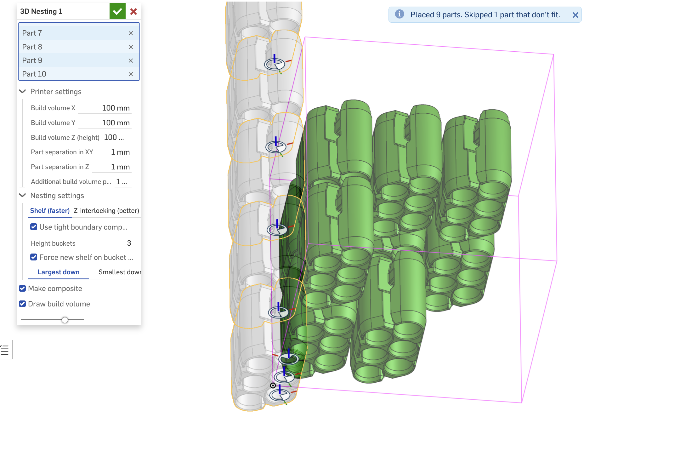

    Hey! Cool initiative! I'm using the built-in nesting tool for our Formlabs SLS (Fuse) printers daily... For me, the ability to rotate parts freely and the ability to lock them – or give the software some freedom in rotating and placing the parts – is quite important.
    I ran some tests, and it seems the more freeform objects did not get placed. The objects with flat sides did get placed, but even when there was space, some still didn't make it... maybe have a look there :)
    Bildschirmfoto 2026-07-08 um 13.21.17.png Bildschirmfoto 2026-07-08 um 13.14.31.png Bildschirmfoto 2026-07-08 um 13.07.06.png
    but keep up the good work!
    ps: this would be so nice to have in an assembly… maybe one day:)
    pps: the Formlabs Preform Software is free - have a look for inpiration, if you like. of course they dont let you export the nested parts:)
