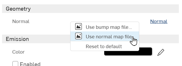

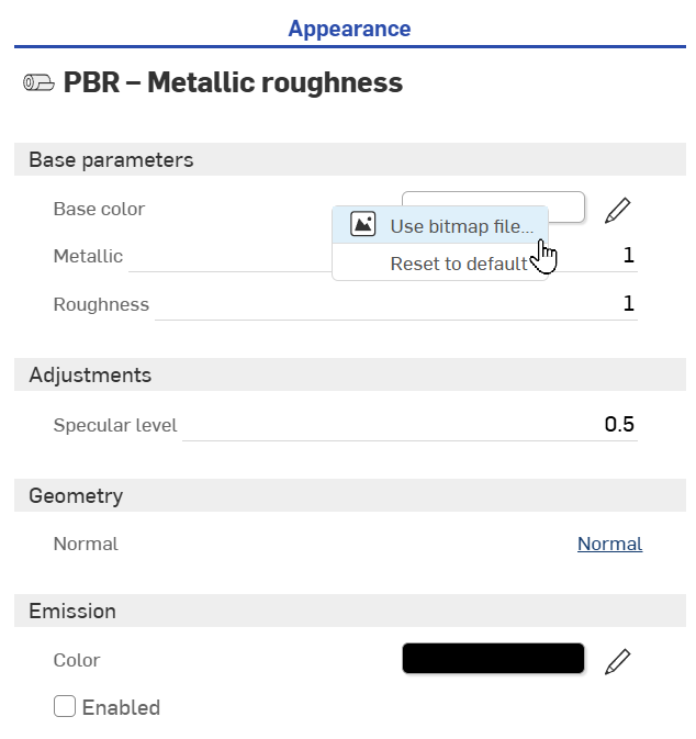

Onshape's additional resources for render studio lists Poly Haven as a resource for free textures. I can't seem to figure out how to upload a new texture or appearance into the render studio. Is that something that can only be done with the render studio upgrade, or am I missing something silly?
1
You can use textures from these sites easily by uploading them to an Onshape document, then right clicking on any compatible appearance and selecting the "Use bitmap file" option to attach a texture to that parameter.
If what have have is a PBR style set of textures you probably have a base color, metallic, roughness and normal texture. If so you can search our appearance library for PBR and use the "PBR metallic roughness" appearance which has these parameters. If you just have generic textures you could also attach them to the "Flexible material model" appearance as a base if you prefer.
You can then go into the textures to adjust their tiling and clipping parameters. You may need to use the projectors feature (on the toolbar) if you want to change the placement.
