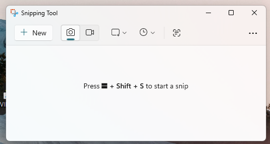

    Now that I have my new computer set up with Win 11. I see the snip tool upgraded to record video as well. The issue is trying to post. It makes a mp4 file that won't post. What's the best way to convert this to one of the file types listed below.
