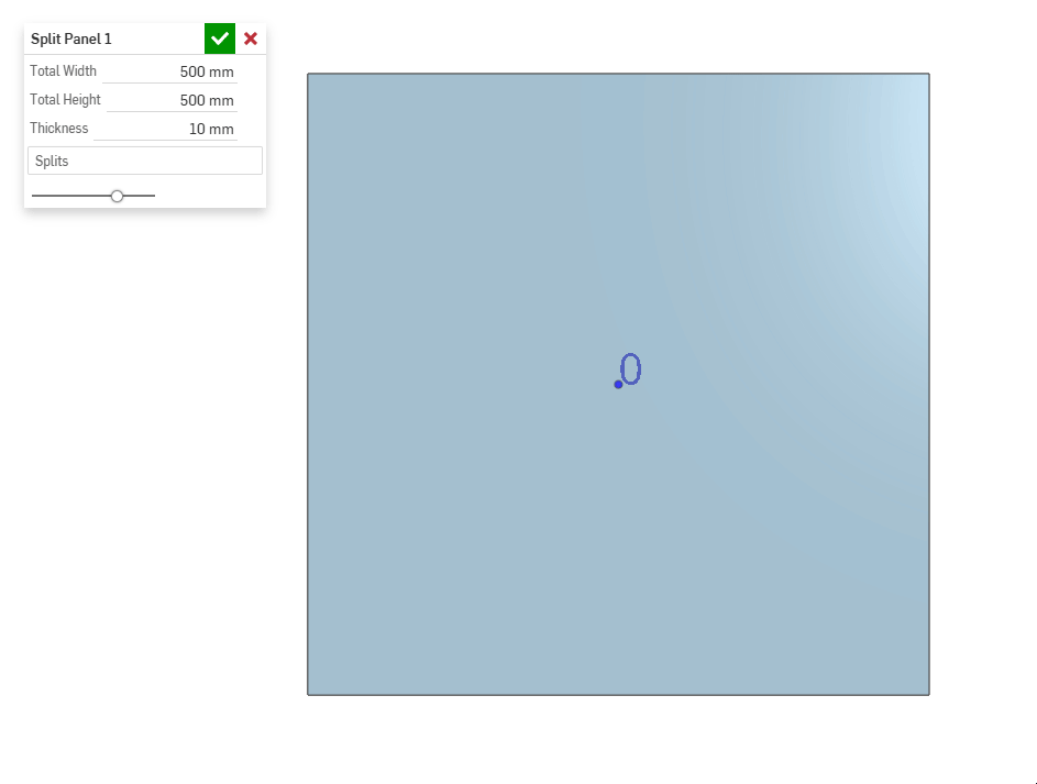

This split panel feature has been one of my favourites of the past year to work on. The combination of a really cool data structure, and an interesting implementation of point manipulators have resulted in a feature I would describe as "playful". Clicking a blue dot adds a split, a red dot remove the split. The extra cool part? The splits aren't limited, you can add as many as you want - with any level of complexity. This feature made me rethink the options for user experience in a custom Onshape feature.
One thing I have struggled with is how to rewrite the feature into a generic use case. I'm not sure how it can be helpful to a wider set of users. So I'm just leaving it essentially as a demo. Hopefully it will inspire some new workflows, or you can use it to show your team the great potential in Onshape.
Try it out here
  • MichaelPascoe
    Using the point manipulators to activate an operation looks pretty responsive.
    I could see something similar being useful for curve splitting or even a quick part slicer. @EvanReese's ffs has something similar.
    S1mon Member Posts: 4,588 PRO
    This is a cool UI.
    I could see a version of this where instead of dimensions, there's a ratio.
    I could also see wanting to have a gap added at each split for tolerance reasons.
    For cabinetry (and other things) being able to quickly split a panel into multiple equal pieces with equal gaps would be great.
