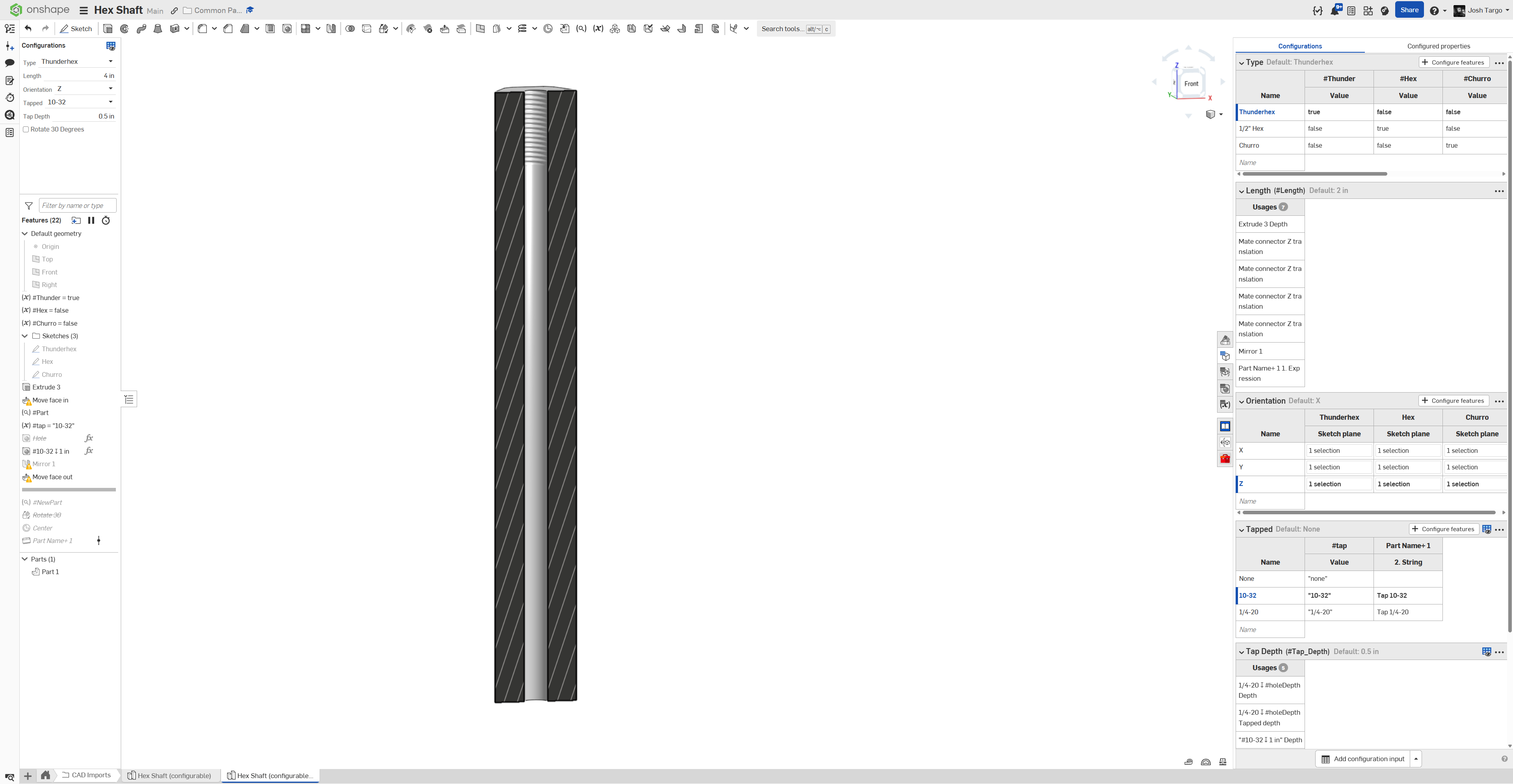

We use pre-drilled shafts (1/2" hex rod with 0.159" hole down the center.
I want to tap the first 1/2" of the hole for 10-32 and make drawings to send to Fab.
The hole tool fails, saying that the hole doesn't intersect any existing parts.
How do I do it?
  • GregBrownGregBrown Member, Onshape Employees, csevp, pcbaevp Posts: 377 image
    You could direct edit the exiting hole (if imported geom) to remove the face or offset it in a little bit. Then use the Hole tool to put a correctly specced 10-32 with 1/2" of tap. If native geom, just use the Hole tool to start with.

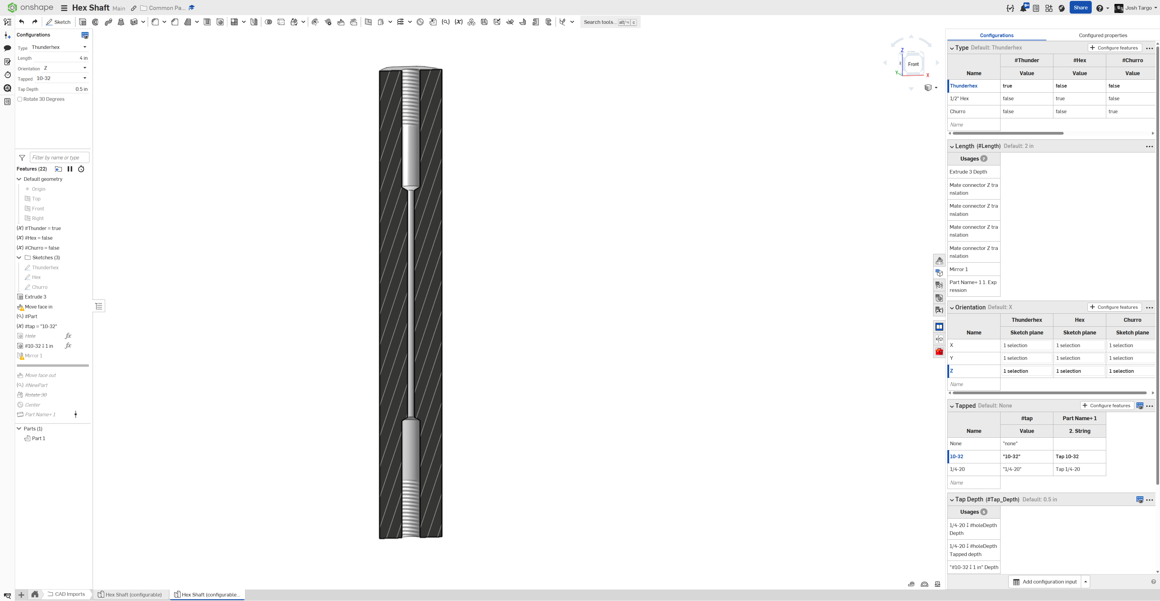

  • joshtargojoshtargo Member Posts: 482 EDU
    UPDATE, this doesn't exactly work.
    offset face in → tap → offset face out causes the visual threads to disappear from one end of the hole.

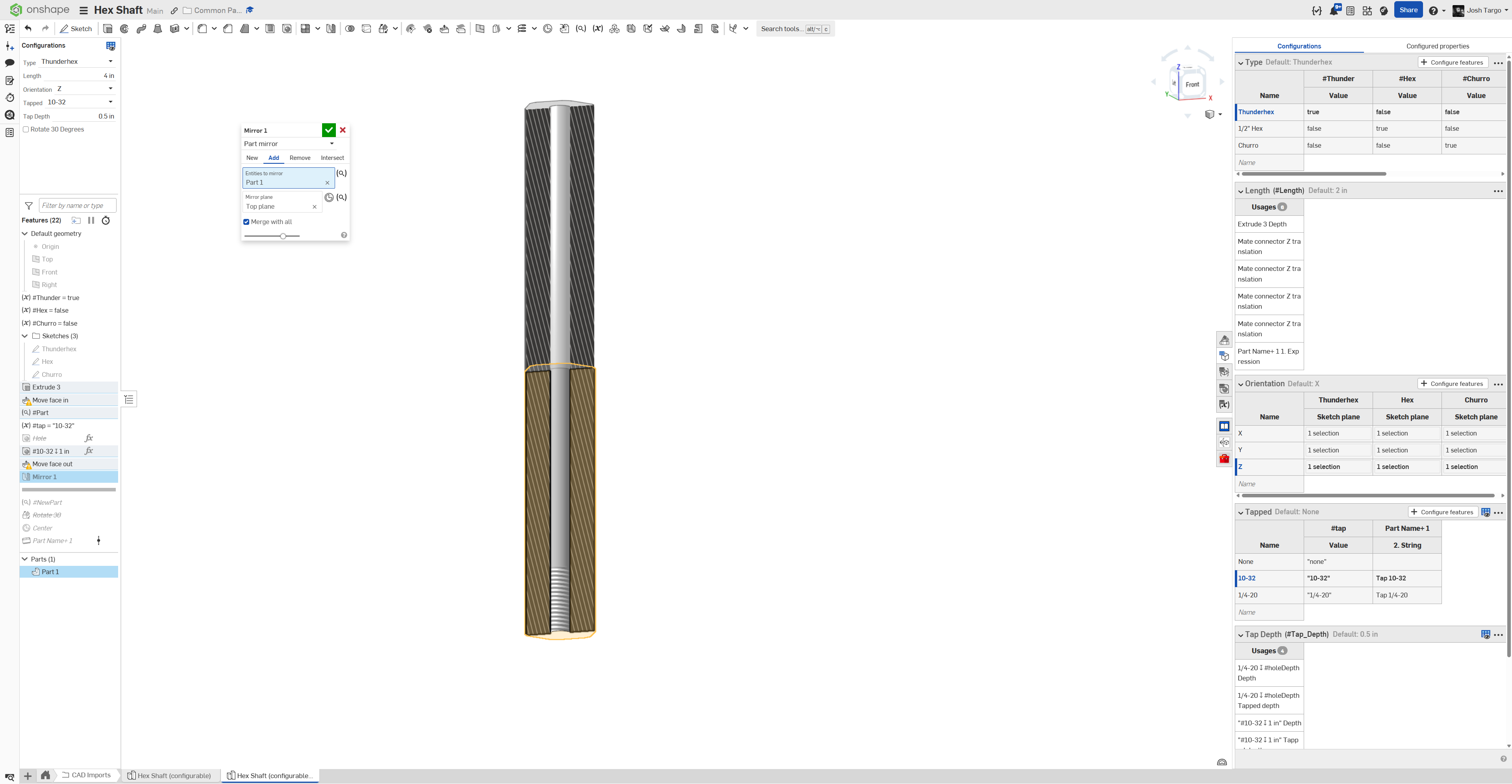

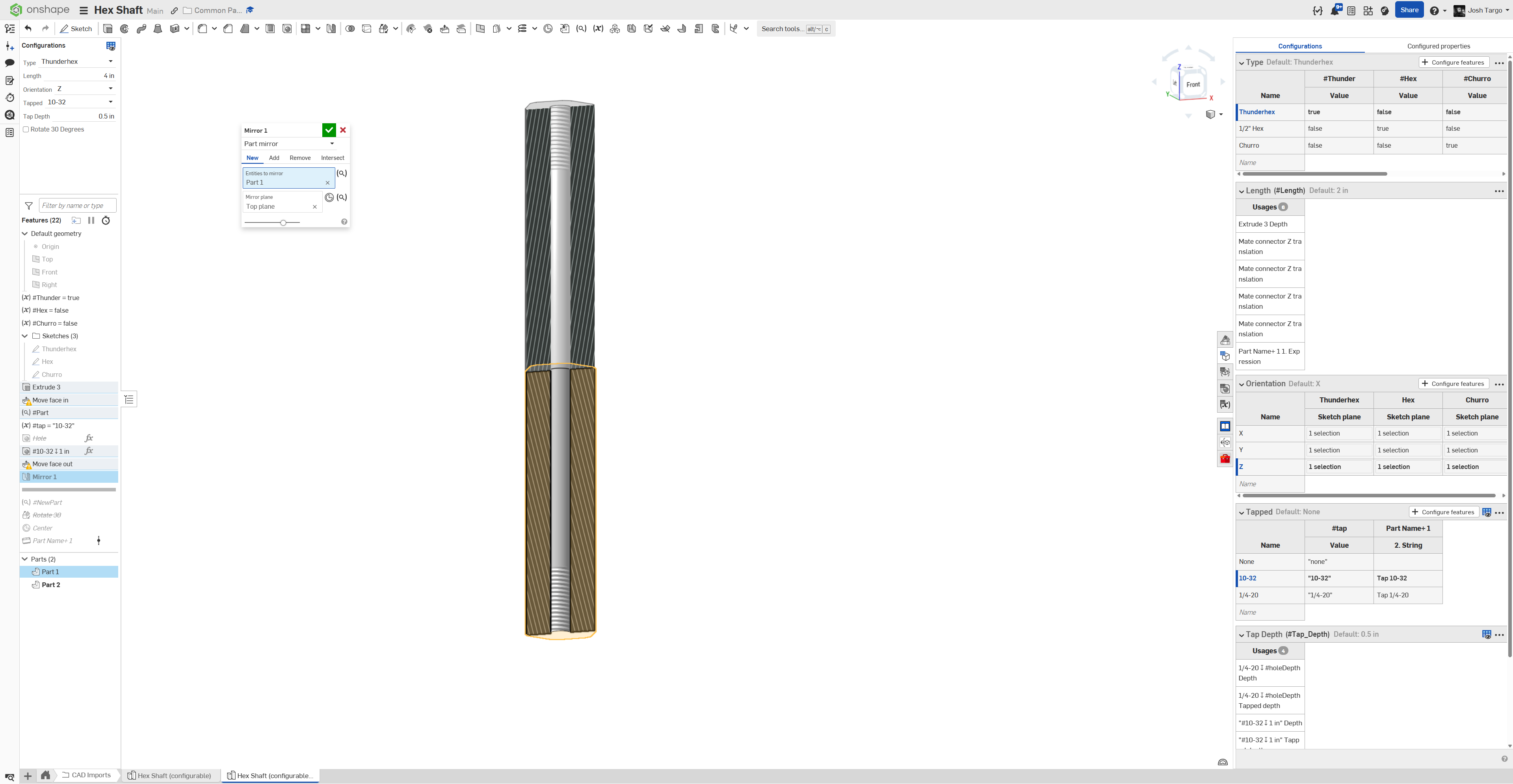

    Creating half the part and then mirroring the part, also causes one end of the threads to disappear. below is mirror-new vs mirror-add.
    mirror-new → boolean union does the same thing
