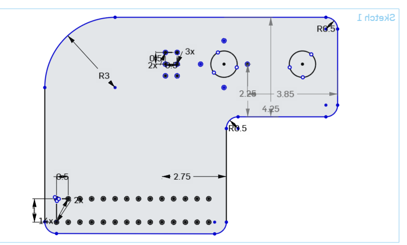

why does my fillet rad points become hole centers when extruding sketch
charles_lefebvre920charles_lefebvre920 Member Posts: 2

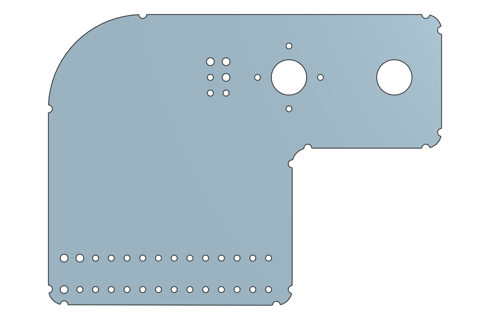

For some reason, it look like my fillet rad ends become hole center when extruding my sketch
Any suggestions how I can prevent that?
  • robert_scott_jr_robert_scott_jr_ Member Posts: 750 ✭✭✭
    Hey Charles. Try refreshing your browser. Are there any underlying elements, such as another sketch, that the extrude may be picking up? - Scotty
