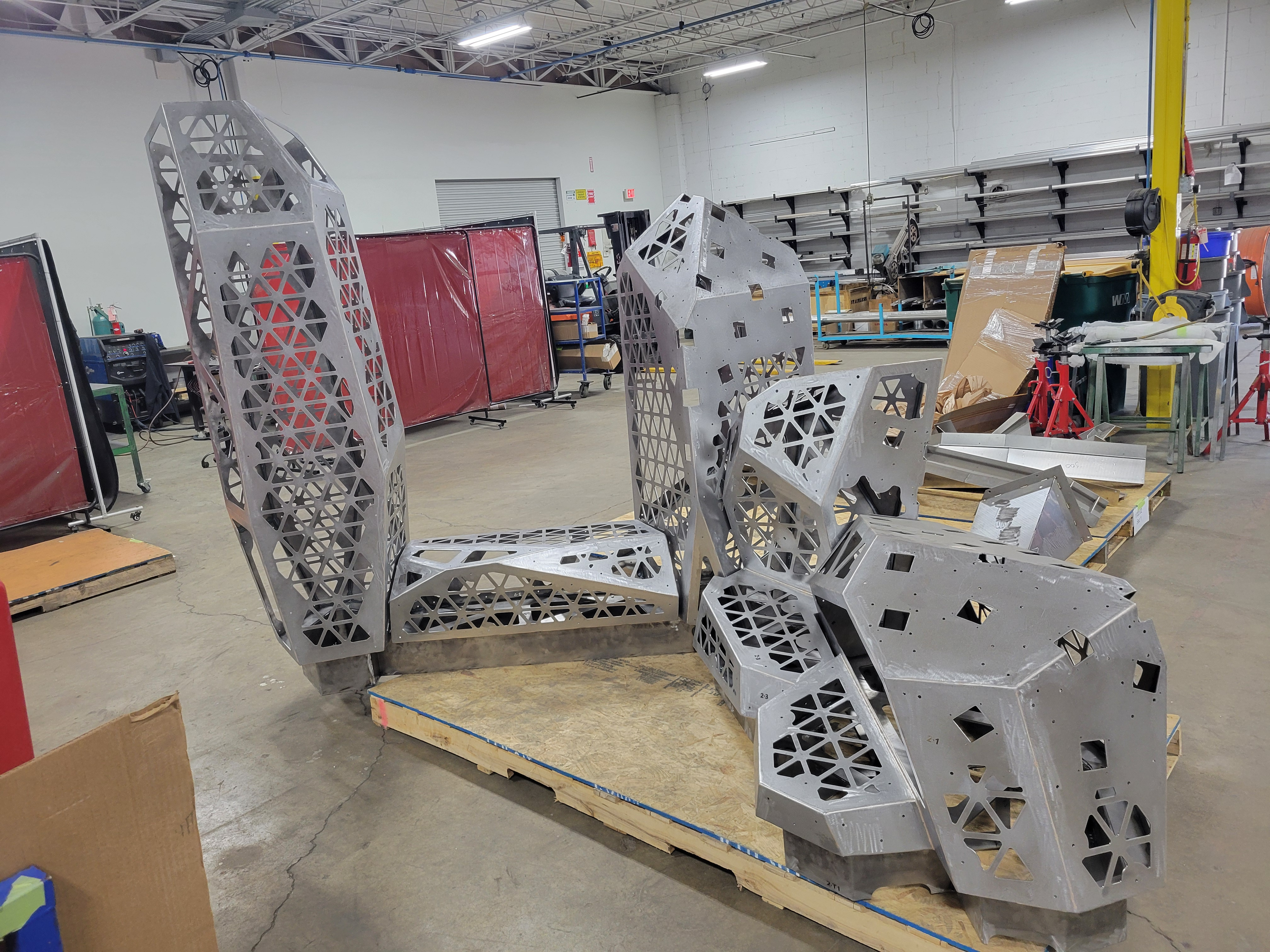

Because the panel gaps on this rock were enormous. I mean look at how unimpressed poor Liam is there. He's gotta fill all of those. The problem is almost all other solutions to this problem are optimized for ease of flat pattern cutting and bending or optimized of ease of drawing, but I need a solution that's optimized for weld filling and maintains tight gaps regardless of initial bend angle. We have another dozen of these that gotta get made and the development time of a script was easily less than the welding time of the whole job across 6 benches. So here's what sets Bip Joints apart from the rest in visual demonstration:
See how much tighter those gaps are between the panels? You'll save a fortune in filler metal using this script.

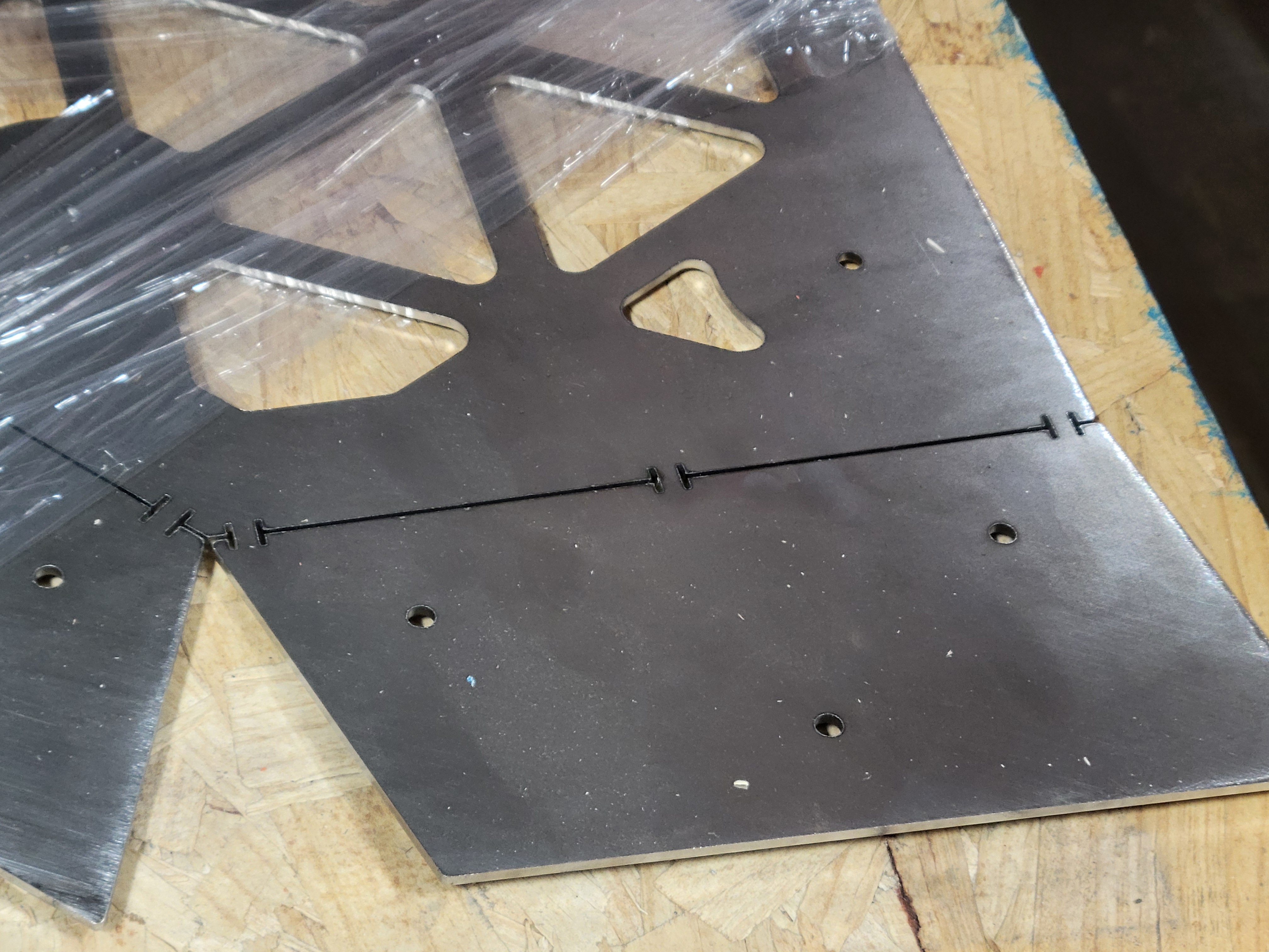

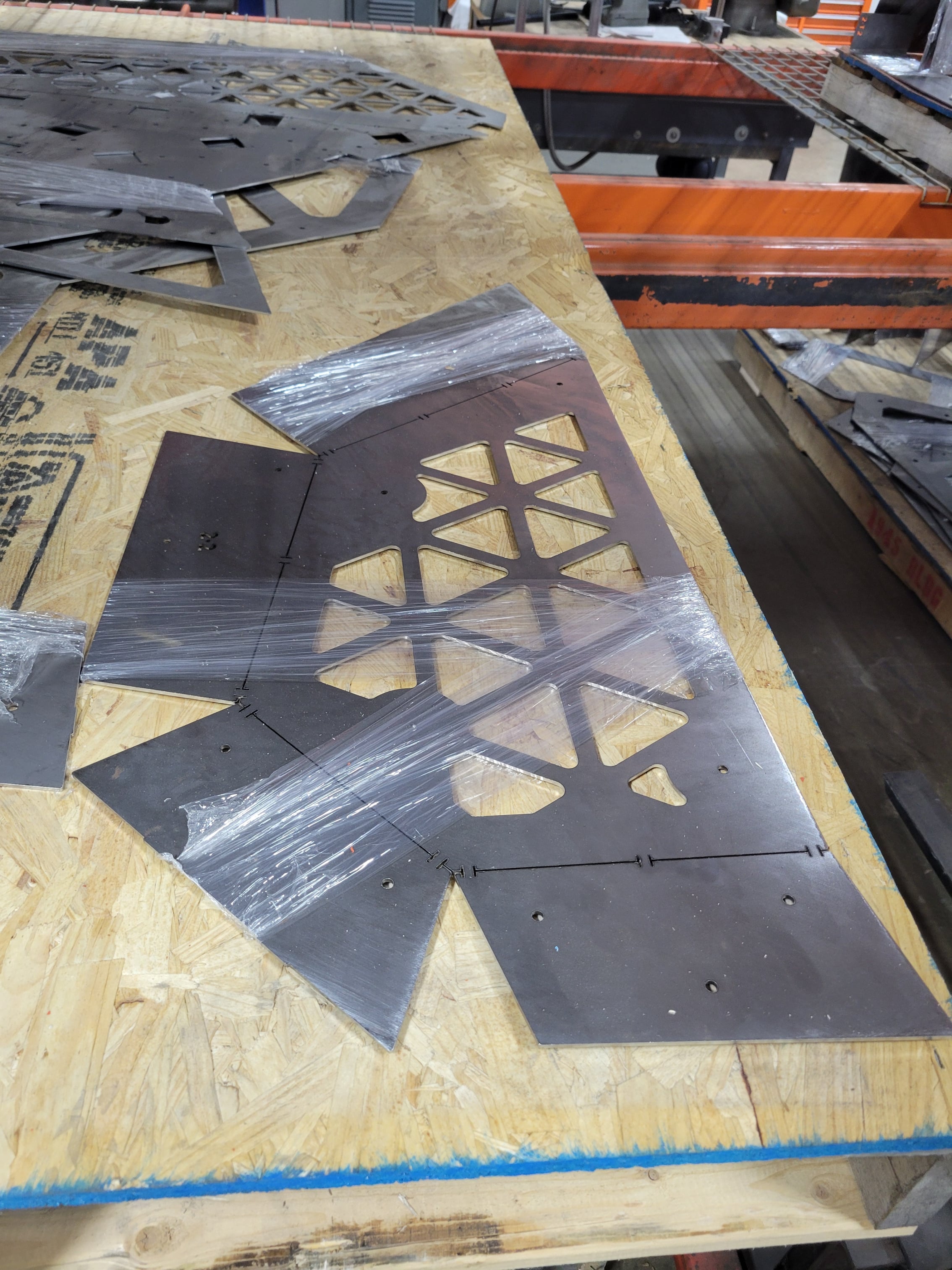

For the curious: we've got some bips in the shop waiting for a free bench to get folded and filled.
I'll report back later with more progress photos and whether or not my low brow assumption of just drawing alternating bends and rips with existing kernel functions delivers weld gap perfection, but I just can't see how it wouldn't. Liam will let me know though. He's persnickety like that.
1 -

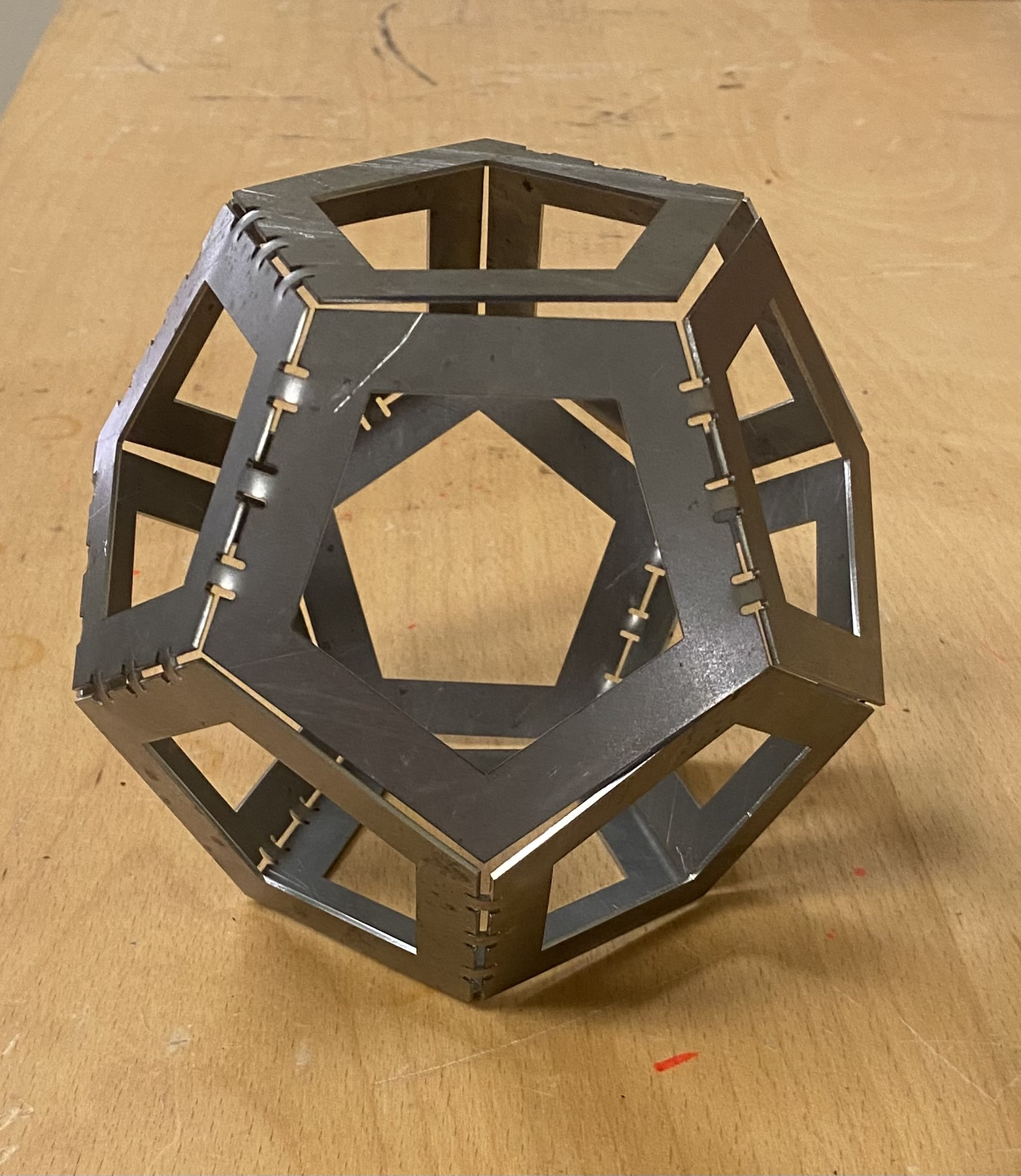

Did A hand bend test with The Bip Joint feature script today.
1 -

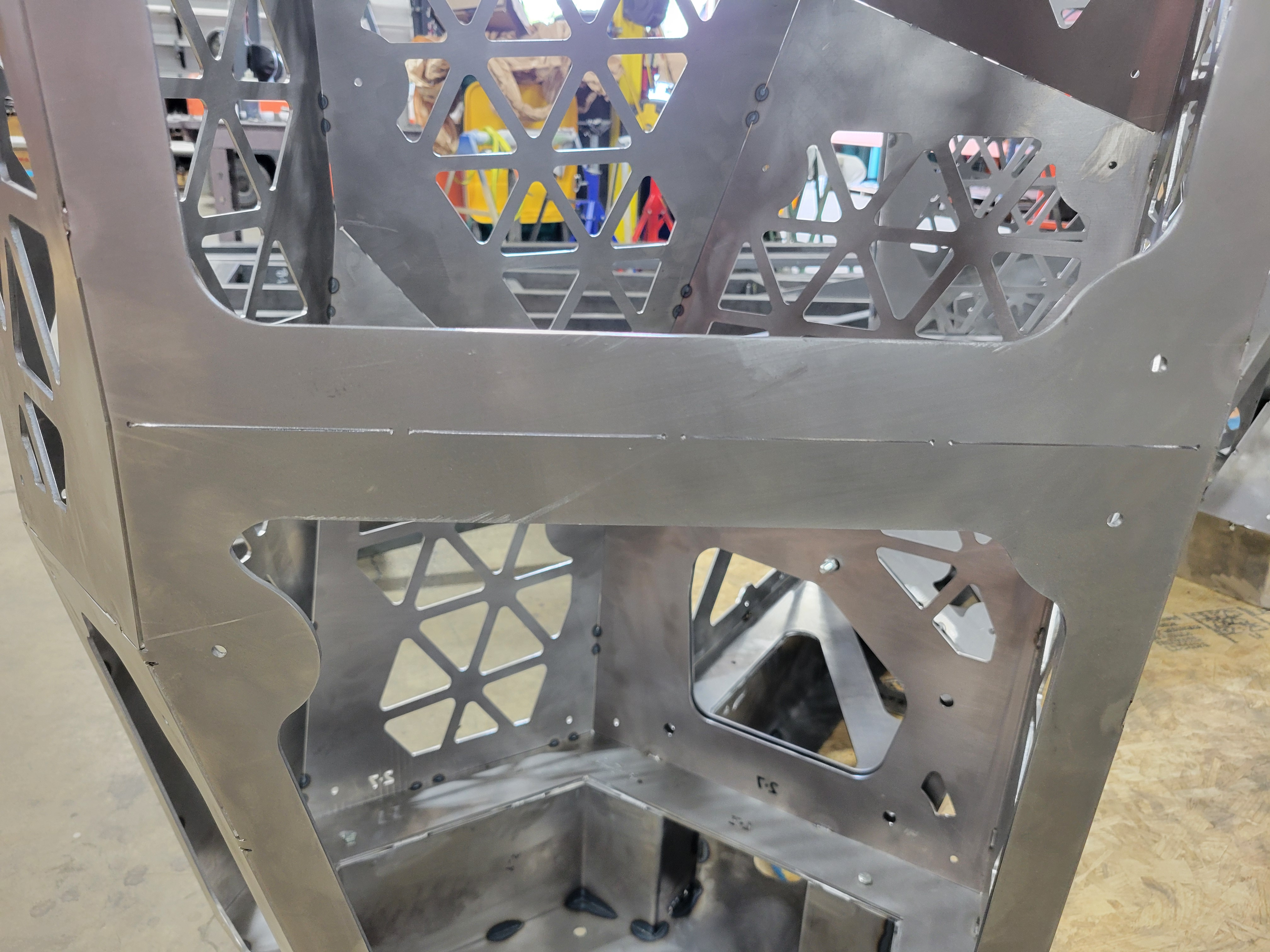

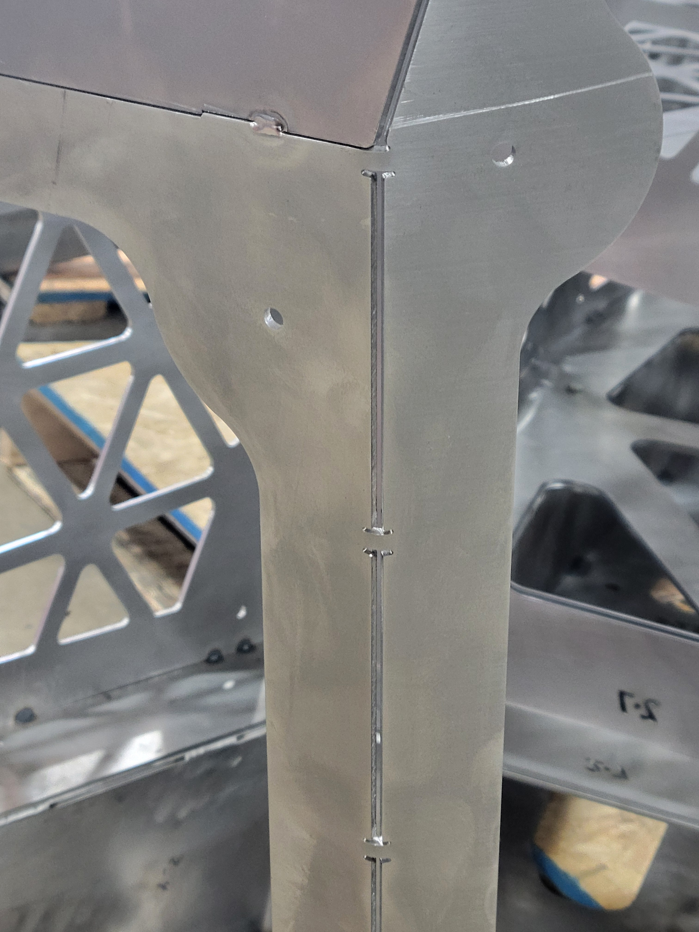

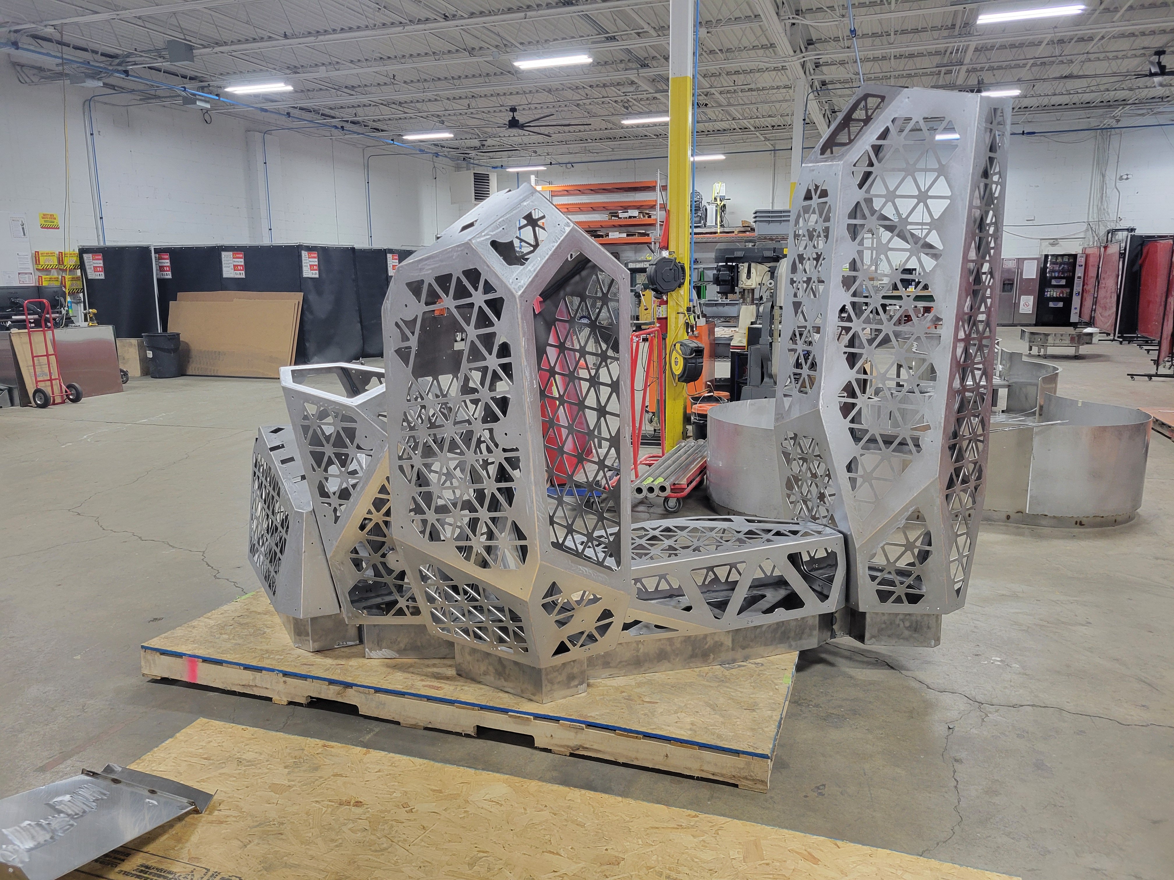

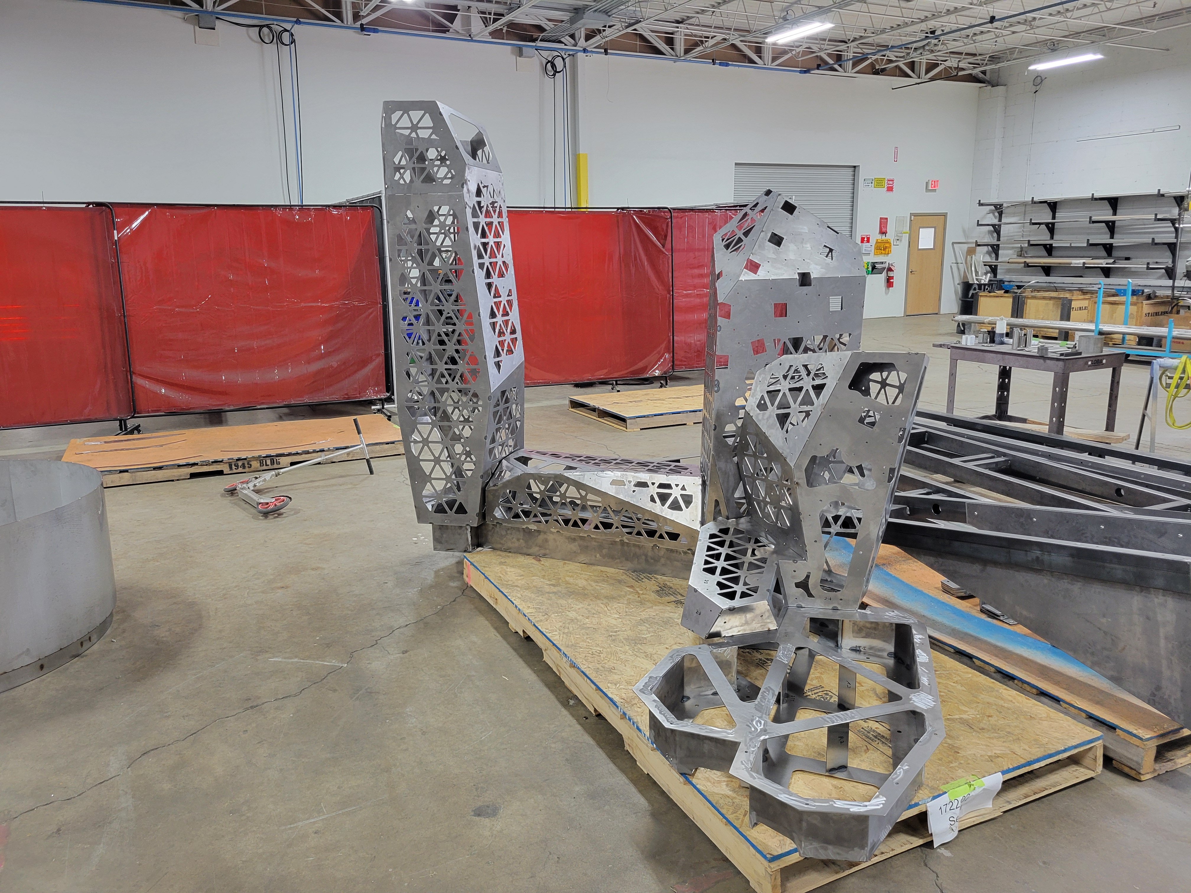

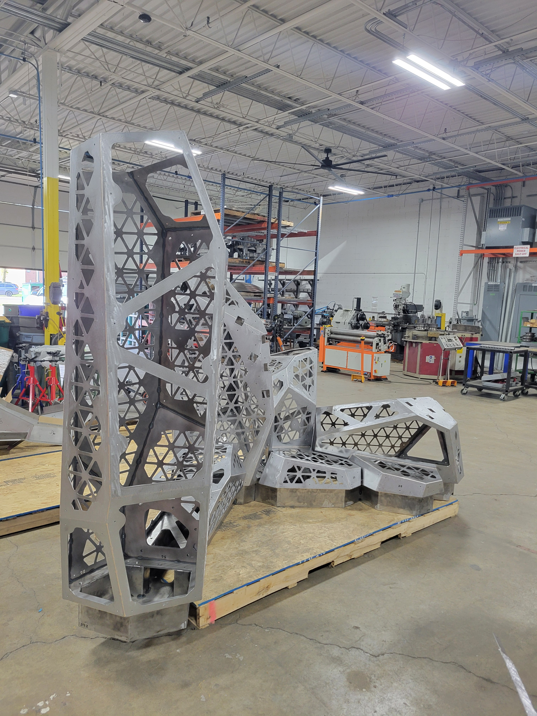

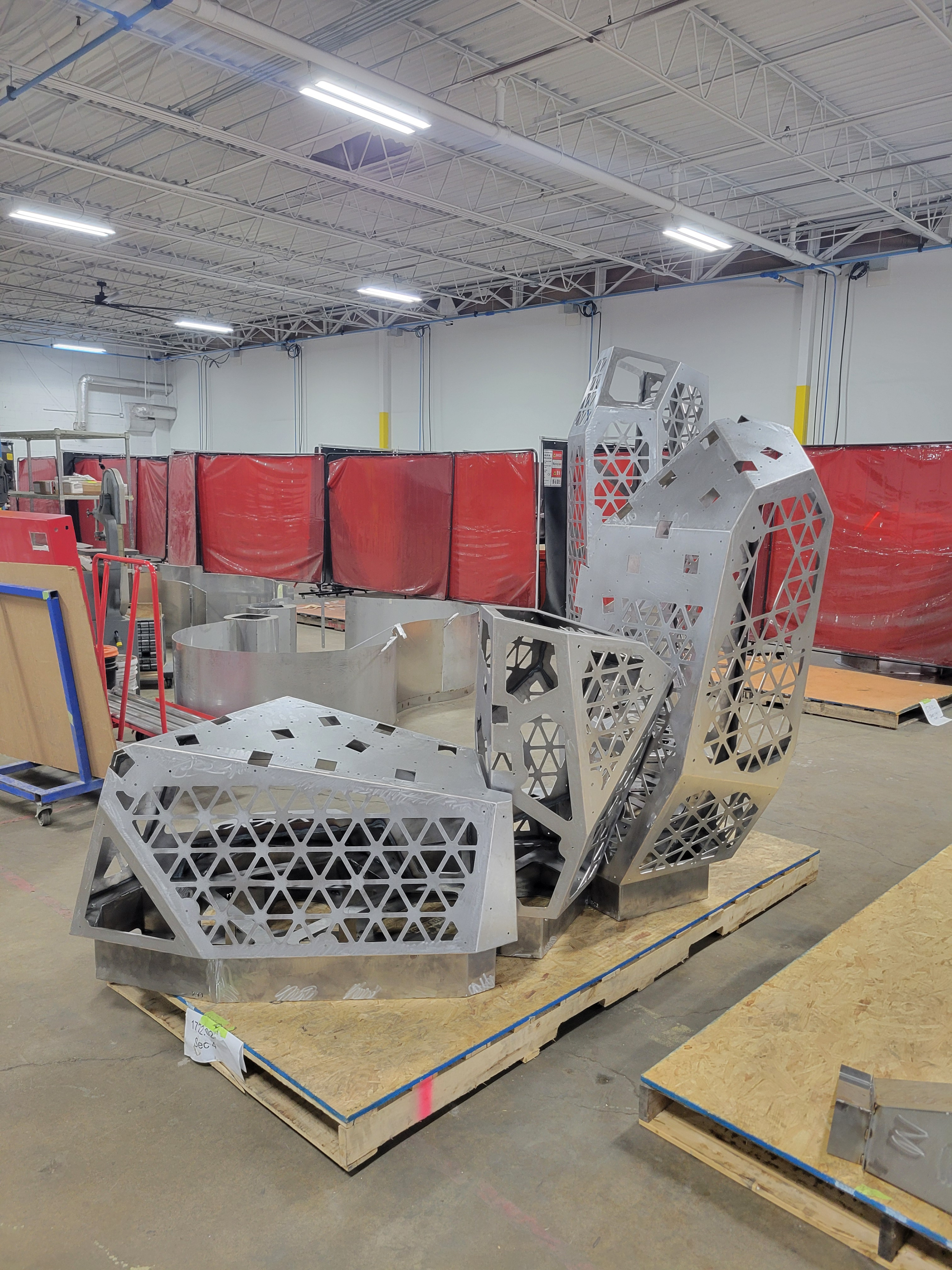

Couple of glamour shots from the job that necessitated the development of this script. I'm super happy with how tight the shallow bips are on this piece, there's barely anything to fill. The welders seemed to be much happier with how easy this structure was to put together compared to the last one with standard stitch cuts.
Edit: Even more rocks
