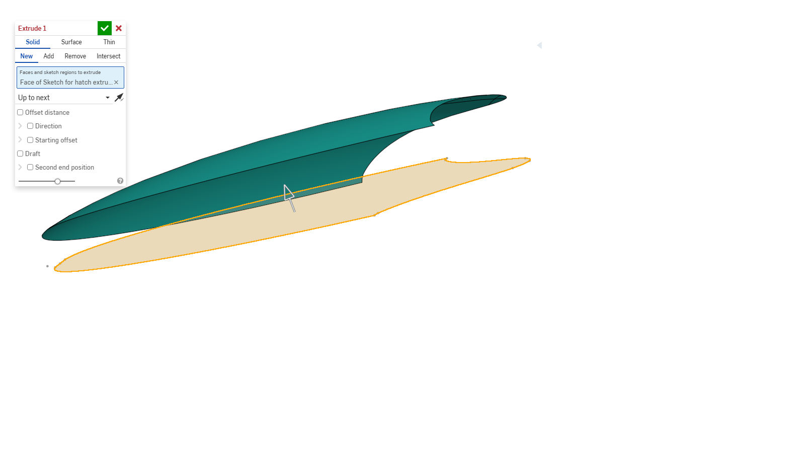

I'm trying to extrude as a solid, from this convex surface to the plane below. (Intended as a "plug" for a hatch mold for an RC glider). But I'm unable to select the surface or it's edges.
I made a sketch of the perimeter with "Use" and tried extruding up to face or up to next; no joy. I'm sure I'm missing something obvious here but I've run out of ideas.
Apologies for my messy and confusing workflow. I've been tinkering with this first attempt at 3D CAD on and off for about 3 weeks. I've learned a lot, but this drawing has become a series of experiments, not all of them successful. I'll do better next time!

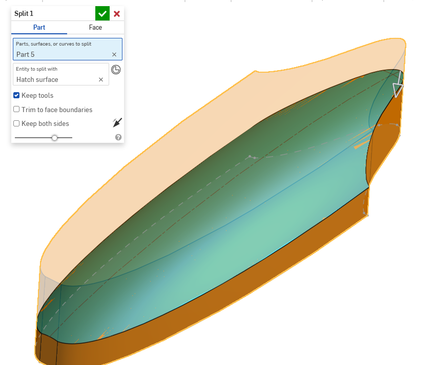

You could extrude it past your surface, then use split to trim off everything above the surface.
Cool, thanks. I'll give it a try.

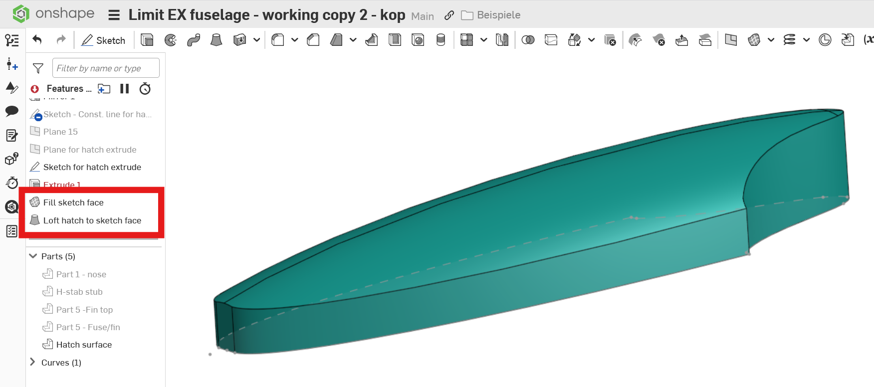

Easy. Stick to surface modeling, while you're at it. Two steps:
If you added an offsetto the outside in the shetch first, you could even get something like a draft, which could help when making the actual hatch.

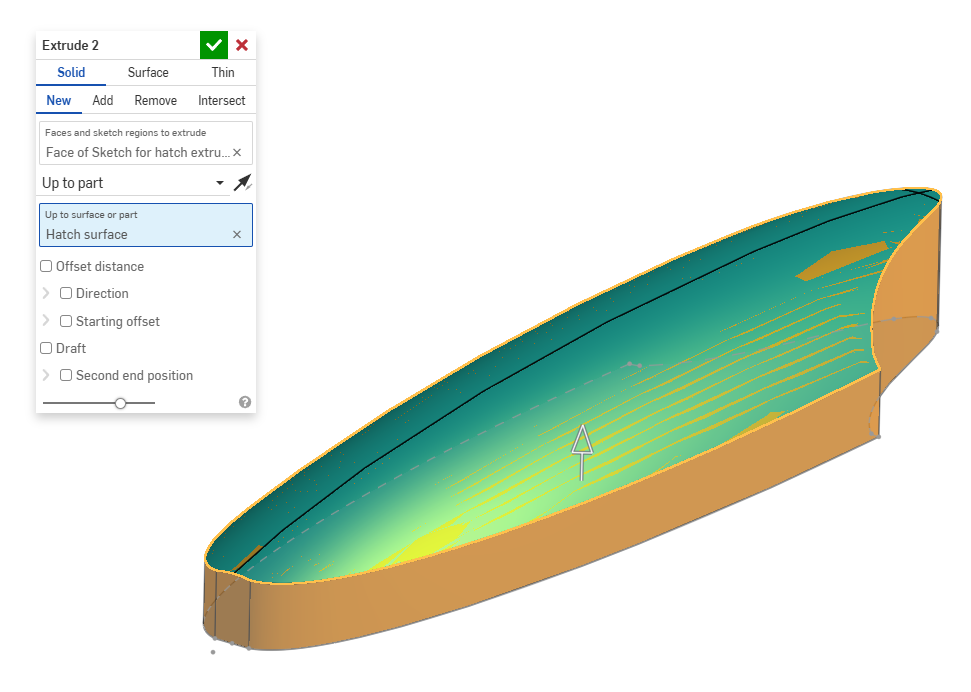

@jim_zamecnik You can also use the end condition "up to part" for extrude.

"Fill sketch face".... I learned a new function today :-)
I had tried "up to" without success. maybe my inputs were wrong.
"Up to" is a bit picky at times. It expects a precise fit or a taget that can be untrimmed to cover the whole projected area.
