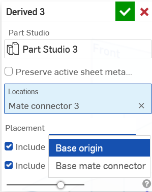

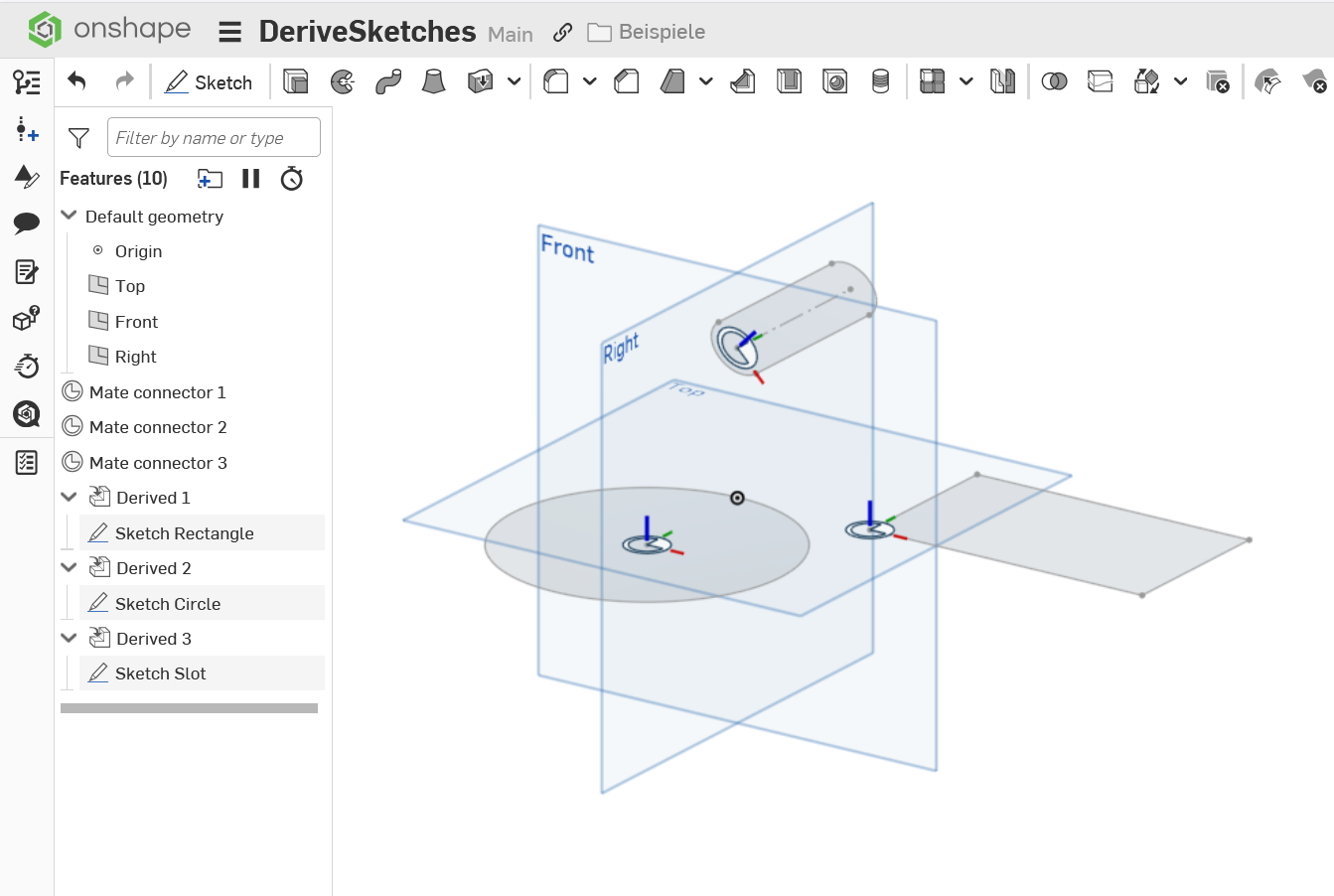

    If you prepare before you derive, you can do it with mate connectors.
    • Place Mate Connectors where you want your sketckes to land.
    • Derive your sketch (one at a time) using the "Locations" option.
    • Specify the mate connector you prepared for the sketch location beforehand.
    • You can now (even after the fact) edit the location of the mate connector (MC Edit box) at will.
    • The sketch (and everything you built on top of it) will follow it around.
    • You could even specify a new mate connector if you like to. No need to translate.

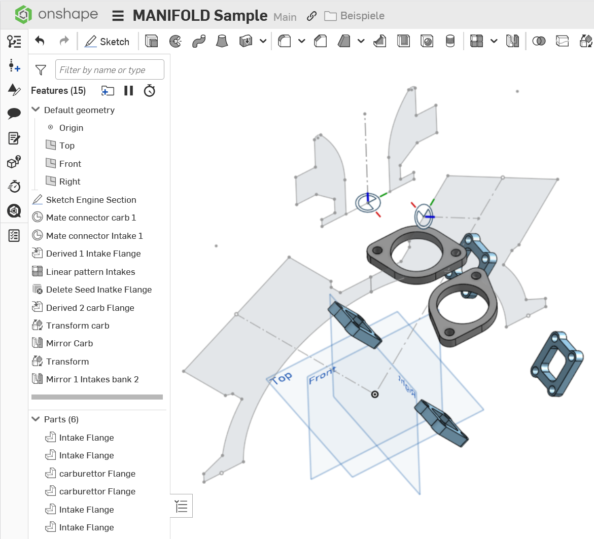

    well, it appears we just wouldn't follow a 'drawing' approach, but rather a 'modeling' approach.
    From what I understood from your description, the manifold you are attempting has several positioned elements that partly repeat, partly mirror, like flanges. We would most probaly just model one each, where they could exist individually in their own part studio, or all in one multi part studio. Then, we would place a copy of the 3D part at the appropriate location by either deriving them there or by patterning/mirroring. That would leave us with something maybe like this ….
    … and would eliminate all the efforts you are currently making with placing the copied sketches and put us in a situation where we would have one place to edit each flange type, as well as their placement on the engine in a parametric manner and we'd "only" have to connect the different flanges in space by a collection of spliny-curvy tube things to create the manifold.
    If you have some basic geometry and are willing to share, post them here and we'll see what can be done.

    I haven't studied in detail what the issue is but it sounds to me like a reset of your approach and a a study on how programs like onshape are designed to work and help design things. It sounds like you are going at it backwards maybe? 2D to 3D? Where the program is meant be 3D and your 2D is a bi product. There's a lotta mention of "drawings" in your messages, where you should only be sketching basic features and modeling. Save the drawings for the end. If you haven't yet done any tutorials at learn.onshape.com,… highly recommended.
  • glen_dewsbury

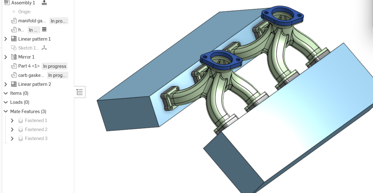

    Yes, go through the basics and get your self oriented to 3d modeling. Copying/transforming sketches is just a lot of work and makes errors in the copies. Each sketch has to be updated individually. Transform is a good tool but you're using at the wrong level. https://learn.onshape.com/?hostDomain=cad
    Attached is a sample using the assembly for multiple parts. You can also produce copies of the parts in a part studio only using arrays and mirrors if the project is not too complex but you'll have to track quantity of parts manually. Arrays and mirrors are in the assembly environment as well.
    https://cad.onshape.com/documents/33c8fc8e55338d14da84ba87/w/9fa8b5a293e1de80d96269ba/e/f4b6ea8eadf4a1ada2bd22c5
    Don't spend a lot of time looking at the details in this sample(they're s…). This sample is to look at methods to set up like the initial sketches. Sketches can use implied points on curves for origin and working plane.
