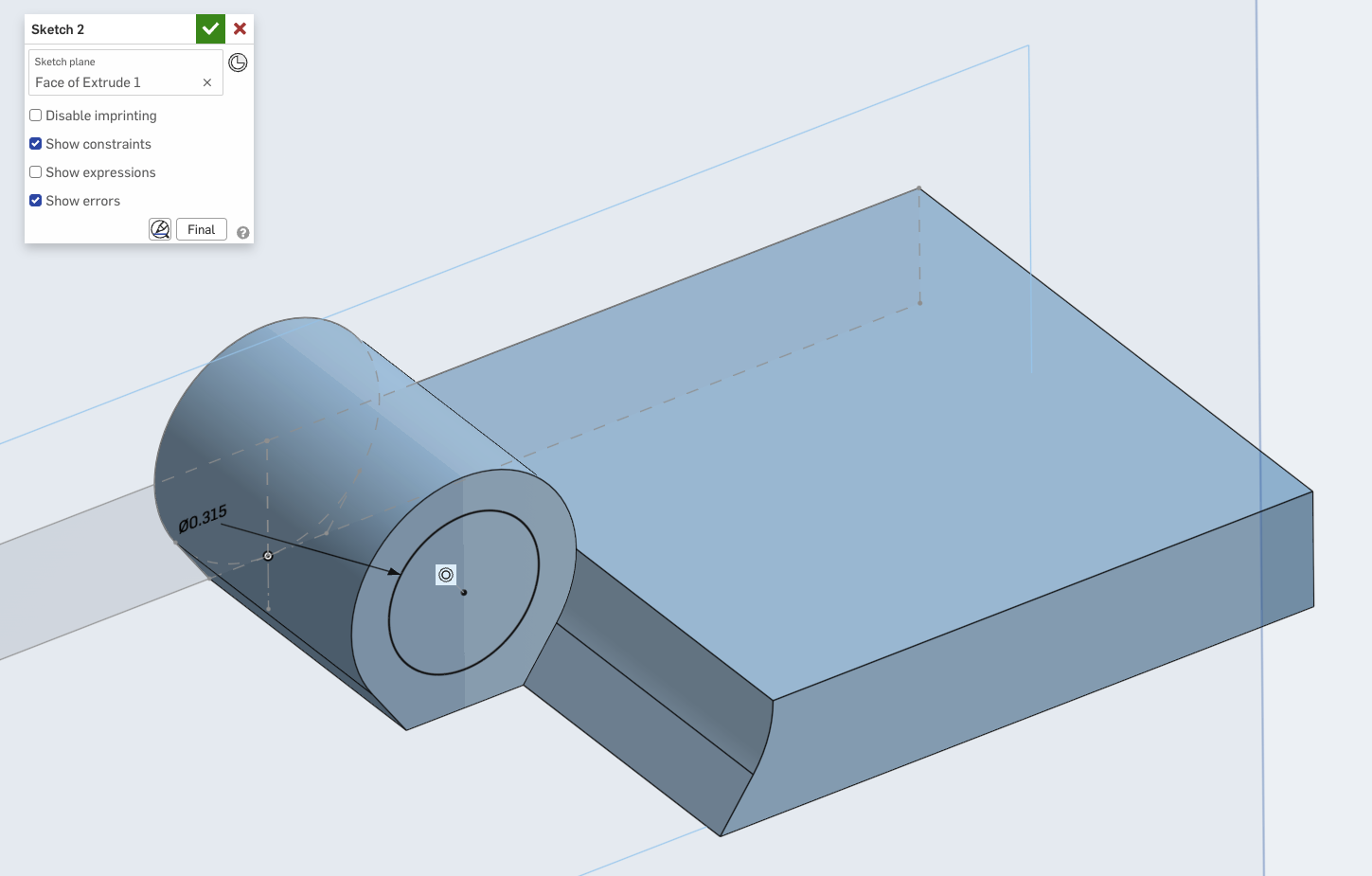

    But from the video I judge your instinct is correct. In Onshape you don't really need the Project/Use in this instance. I dont use Fusion that much so I can't say why the modeler is doing it this way. They are make a circular boss on in the inside face of the hinge bearing. The way this would be accomplished in Onshape is creating a sketch on that inner face and then creating a circle, and then adding a constraint to that circle to make it concentric to the hinge bearing:

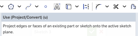

    In Fusion I think they are using the Project operation to create a sketch plane (or something - total speculation). In Onshape, Use/Project is used to transfer edges or other sketch entities to the sketch of interest:
    But the sketch itself is created by clicking on the place you want to start sketching and clicking Sketch.

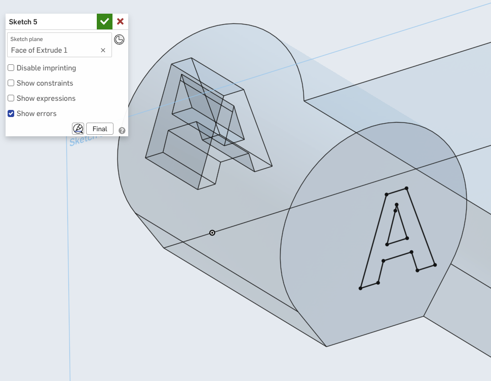

    To make that inner boss (which eventually becomes the cone) there is no need to project existing geometry. Use/Project is when you have some geometry already created or coming from another sketch and you want to add it to a sketch you are working on. Here's a contrived case where I could use Use. In reality, I wouldn't do this, but bear with me.
    Say I have created a boss "A" on one side:
    Recreating that on the other side and getting it match perfectly would be a pain. So instead I create another sketch on the other side, select the edges of the A that I want, then click "Use":
    This transfers all those edges to the new sketch without me having to recreate them. Handy!
    Now, in reality I would have accomplished this with just a single extrude through the Boss — but you get the idea, I hope!

    He is simply using the project command to get the center point of the outer arc, then drawing his circle on that point. To do this in Onshape, select that face, start a sketch, click the face as he does in the video, then select the Use Tool.
    However, it is not necessary, as the Onshape sketch tools will allow you to find and reference that center point without going through this process.
