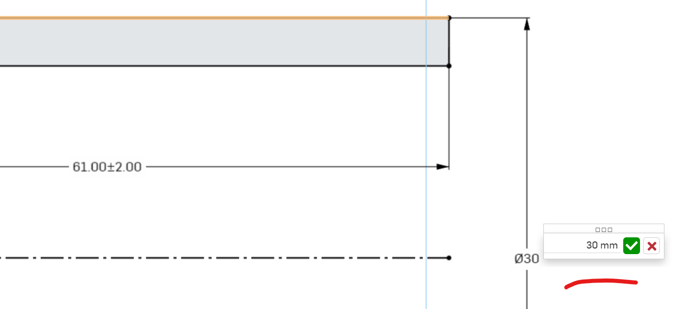

Has anyone tried the new MBD function using the Inspection table. I have tried and set up a sketch of just a basic hollow pin. It allowed me to put tolerances on the length dim but not for the diameters, which were setup as a dim from line through the centreline. There's no option to add a tolerant to it. Do we have to change our modelling philosophy and extrude a tube with diameters…but what if we can only put in a diameter using a revolve sketch ?

    Currently we don't support tolerant dimensioning to sketched centerlines however we're working on adding that functionality.
    Depending on exactly what information you're needing you may be able to leverage the MBD annotations/dimensioning tools in the inspection panel in the interim
