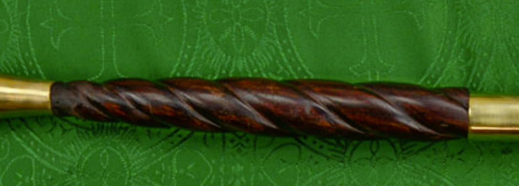

How would I go about emulating this effect?
I've looked into using the helix tool, but it doesn't play well with non-cylindrical bodies. If only I could wrap it around the contour of the part, but that doesn't seem to be a possibility.

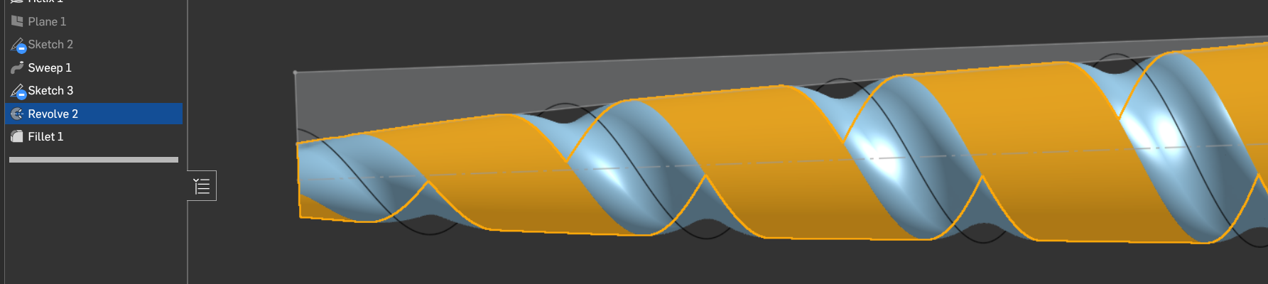

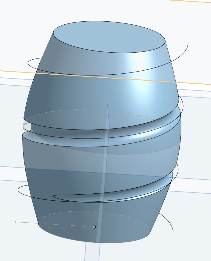

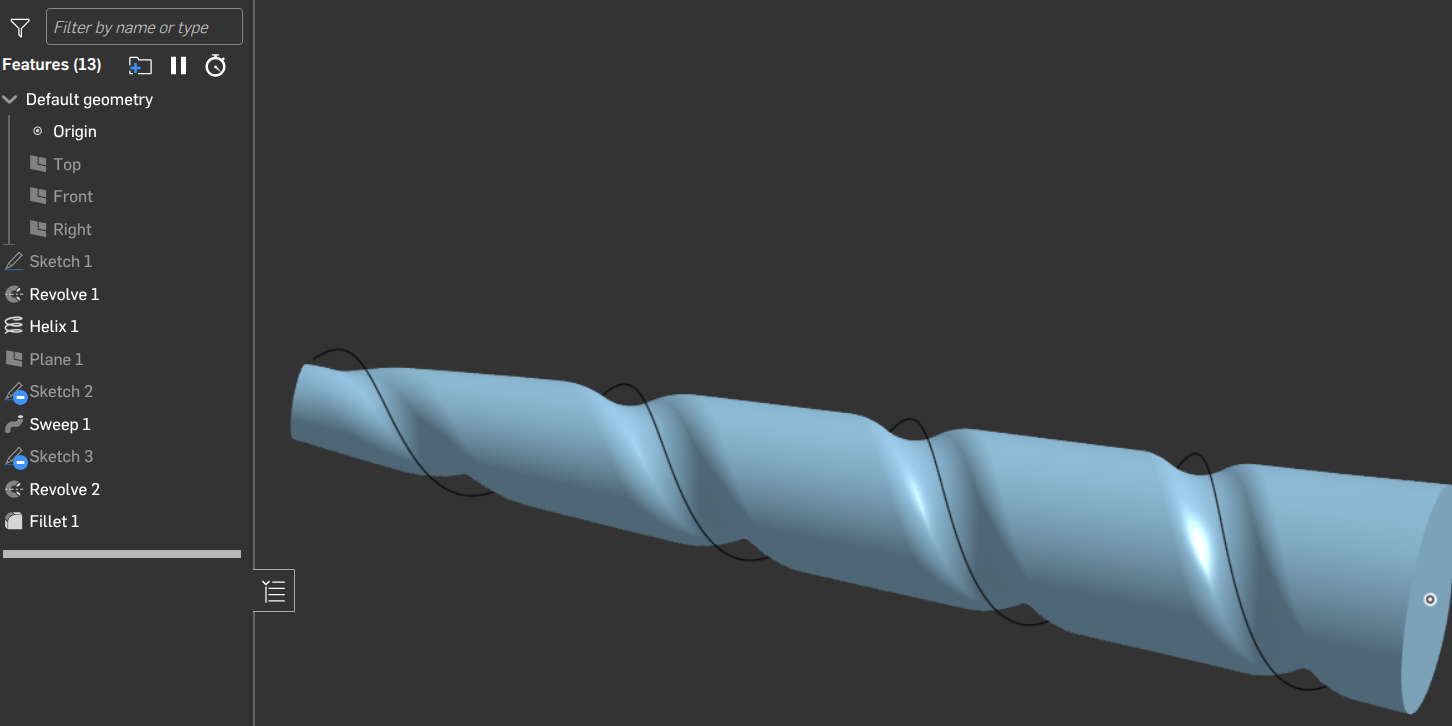

What about a helix on a conical. Then trim off some of the outside using a spline or curved revolve.
Repeat for the other side and merge them.
Hard to tell from my other pic that it's not conical. This pic shows it's a curved outer profile.
Here is another sample like Smurf described.

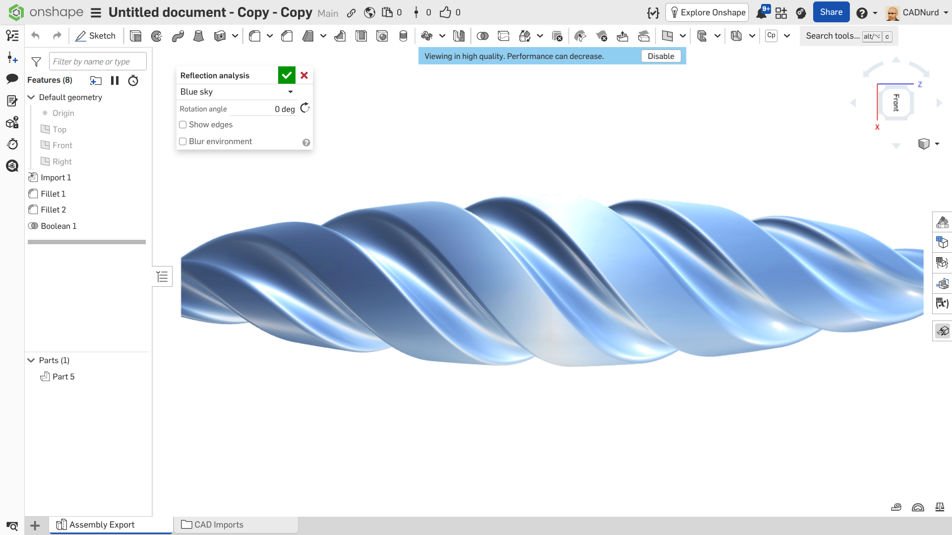

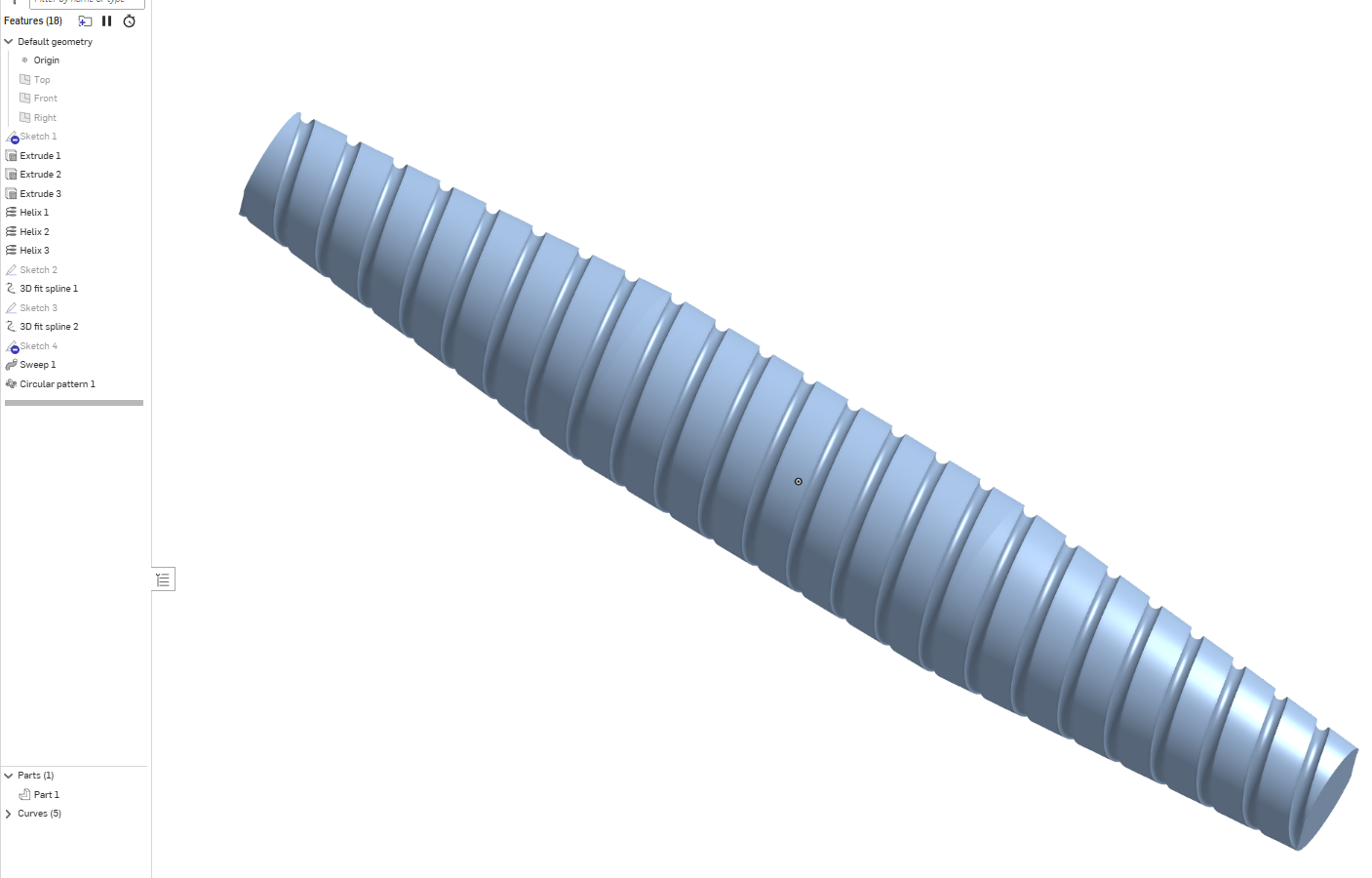

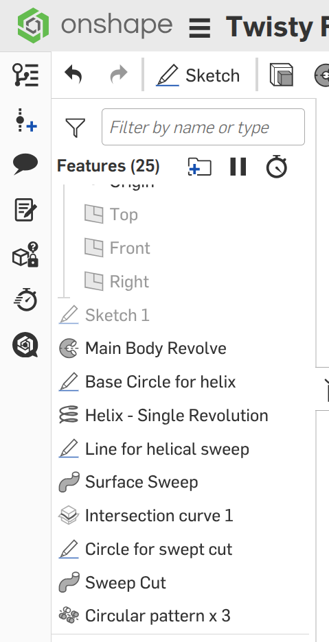

I spent FAR too much time on this, but I think it turned out well . . .
Unemployed Onshaper- Operating on European time - More of me here ➤➤ https://linktr.ee/Liam.G2 -
After that it got very messy, with mirroring and transforms before finally mating the two mirrored halves together in an assembly and exporting it out as a parasolid. If I was doing it again I'd do it all in one go and not bother with the mirror. Definitely 100% done using Onshape though. No tricks.
