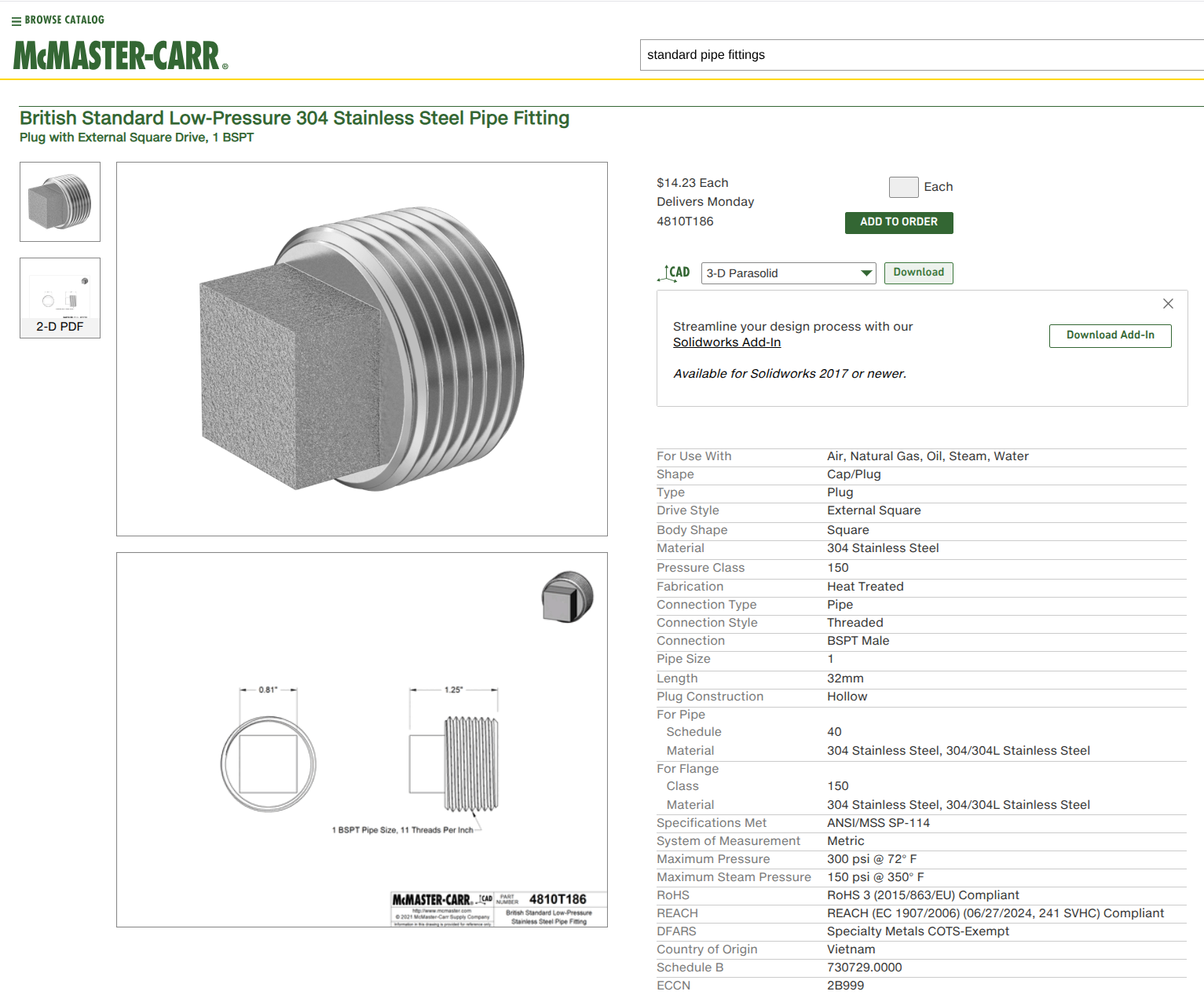

    Do you want to create the actual threads in Onshape? Don't flame me, but I don't think british pipe thread is used very commonly any more. Hence it's omission from the standard thread creation tools.

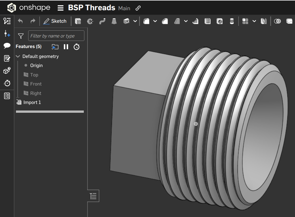

    If it's not necessary to create the threads natively, just download a 3d model from Mcmaster-Carr or similar.
    1" British Pipe thread plug model from Mcmaster-Carr.

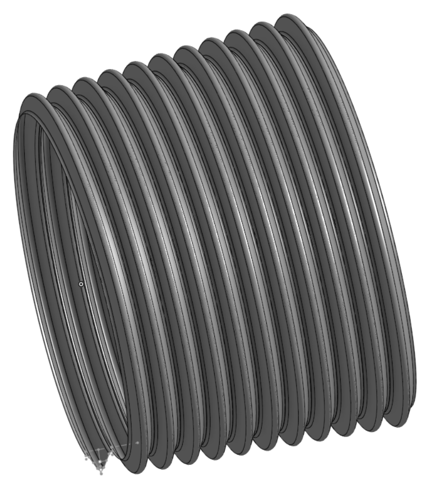

    Any thread form can always be created the old fashioned way of a helix and a sweep on the helix, in any CAD program. The helix can also be tapered. Those are good to know, even in today's CAD of automated thread creation tools, for when you want a truly custom shape. That's typically not a first day CAD project, however.

    Tried to make a BSP thread the old fashioned way. PIA to get right based on Machineries handbook. It's tapered and based on the Whitworth thread form. Yeah…me neither.
    90% there, but my root diameter is off. I give up. Not worth the time.
    Upshot; don't use BSP because it's basically defunct. If you have to for some reason. Download a model from McMaster.
