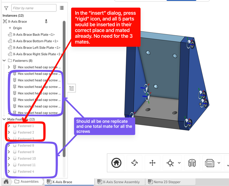

    Thanks for a such a comprehensive replay, Nick. I got stuck in before I saw you're reply so I've drawn a lot of the machine already. I'm sure I've made life harder for myself in a number of places but I'm pretty sure now I can get this project drawn up. I'm impressed by how many parts you can have in a single PartStudio / Assembly without any slowdown.
    I've played with making the assembly motion work but I've clearly still got some learning to do there. I'm hoping to get the y-axis gantry assembled onto the x-axis today.
    I think the link below should take you to the model.
    https://cad.onshape.com/documents/f57efc10188619b31973749c/w/f7ad15af27109dc41bf4a02a/e/20b8e0ec7f06221abef1931c

    Nice work! I just quickly browsed a few of your items…
    Look up replicate in help/training in the assembly section. It will make adding fasteners, which you will have hundreds of, over 10x easier. I'd even go so far as deleting all the dozens of fasteners you already placed and redoing them with replicate. It will make your asm's so much simpler. Once you do one, you will see how quickly it goes.
    Look up "insert as rigid" in help/training in the assembly section.
