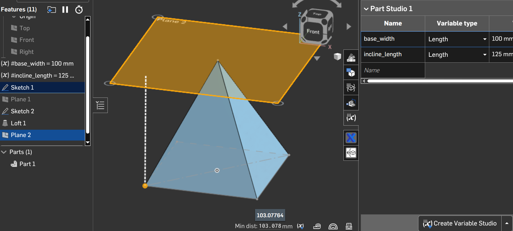

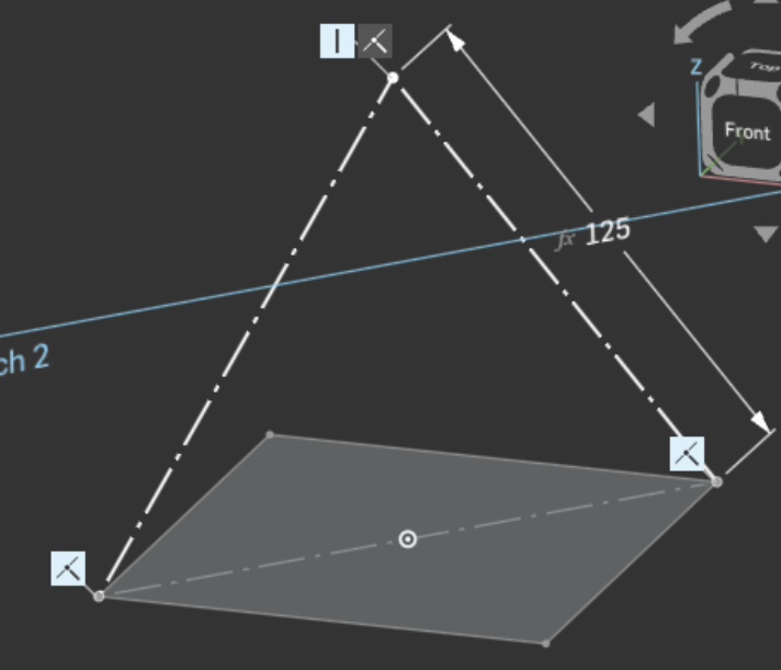

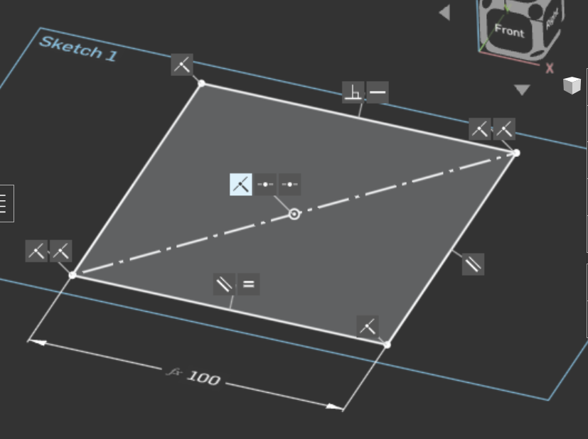

  • SMURFCADSMURFCAD Member Posts: 58
    Devin,
    Are you wanting to set a known pyramid width and inclined edge length, then CAD creates a plane the appropriate distance automatically?
    If that the case maybe try this method. You can create a variable table like shown OR just edit the sketch to enter the desired length.
    100 mm base and 125 mm inclined edge length creates a plane 103.07764 mm from top plane,
    I'll send you the document if this is in line with what you want.
    Below sketch is on Plane 1 which is defined as a Line Angle. Line goes from corner to corner, angle is 90.
