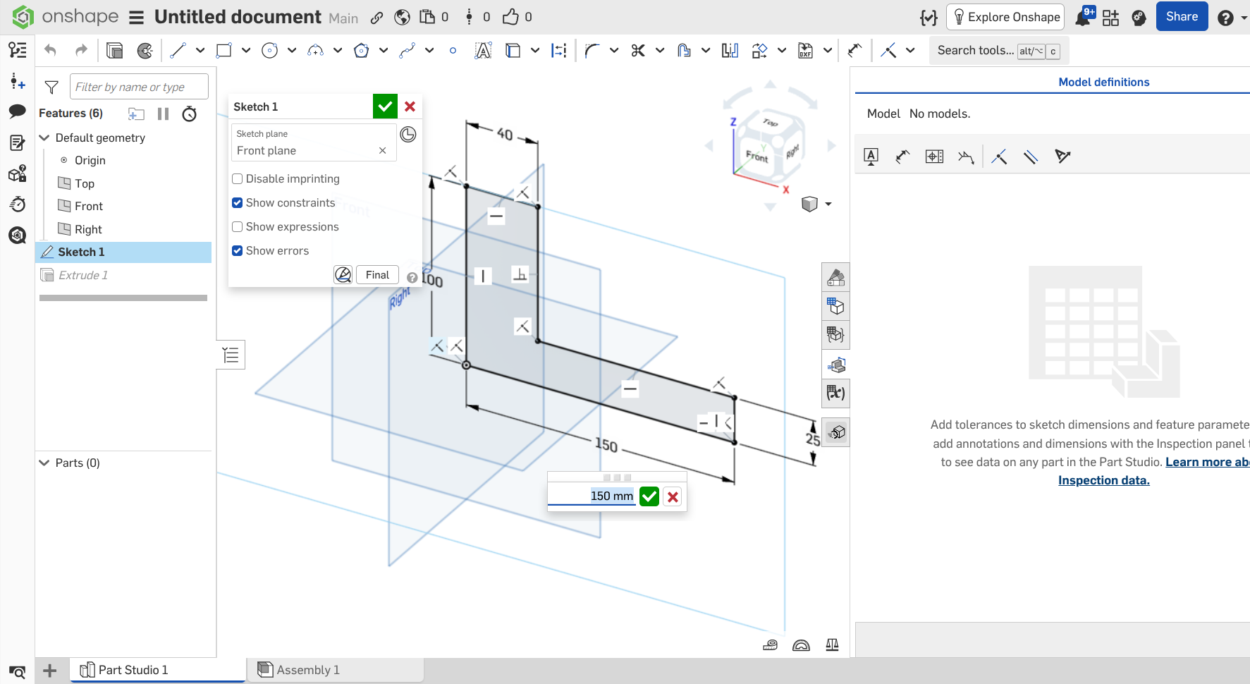

MBD seems to have disappeared.
CADNurdCADNurd Member Posts: 94 ✭✭
Chrome Browser - running on a chromebook - same issue in an incognito window.
  • sebastian_glanznersebastian_glanzner Member, Developers Posts: 481 PRO
    Is the dimension from point to point? I think that does not work. You need to dimension line to line, or line to point.
  • Matt_ShieldsMatt_Shields Member, Onshape Employees Posts: 938 PRO
    The option to make a dimension tolerant will only show up if you are dimensioning something that can be measured in real life, like a diameter or the distance between two faces. In your example, don't dimension that bottom line. Dimension between the far left (100 mm) and far right (25 mm) lines and you should get the option to make tolerant. Because those two lines will become parallel faces after you extrude.

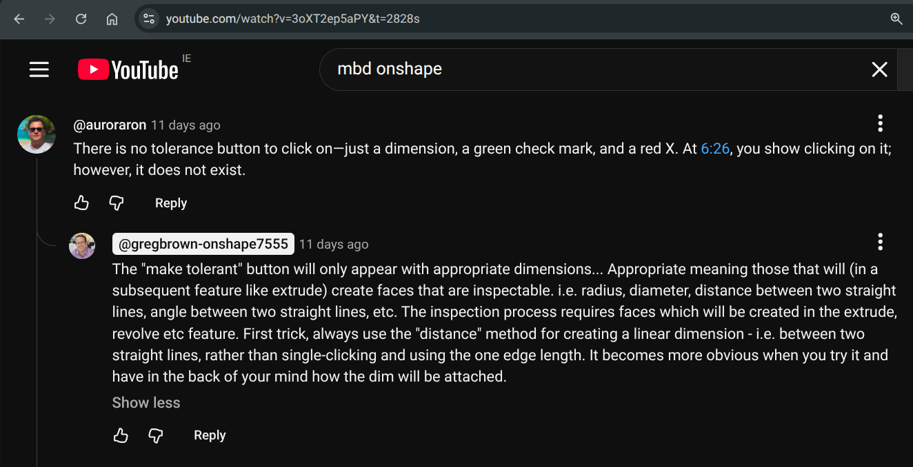

    So . . . maybe nothing HAS changed after all. Found this 11 day old comment . . .
    No mention in the video about this limitation, which is probably going to trip up a lot of people going forward.
    No MBD behavior has changed since its release. The behavior in the video still exists.
