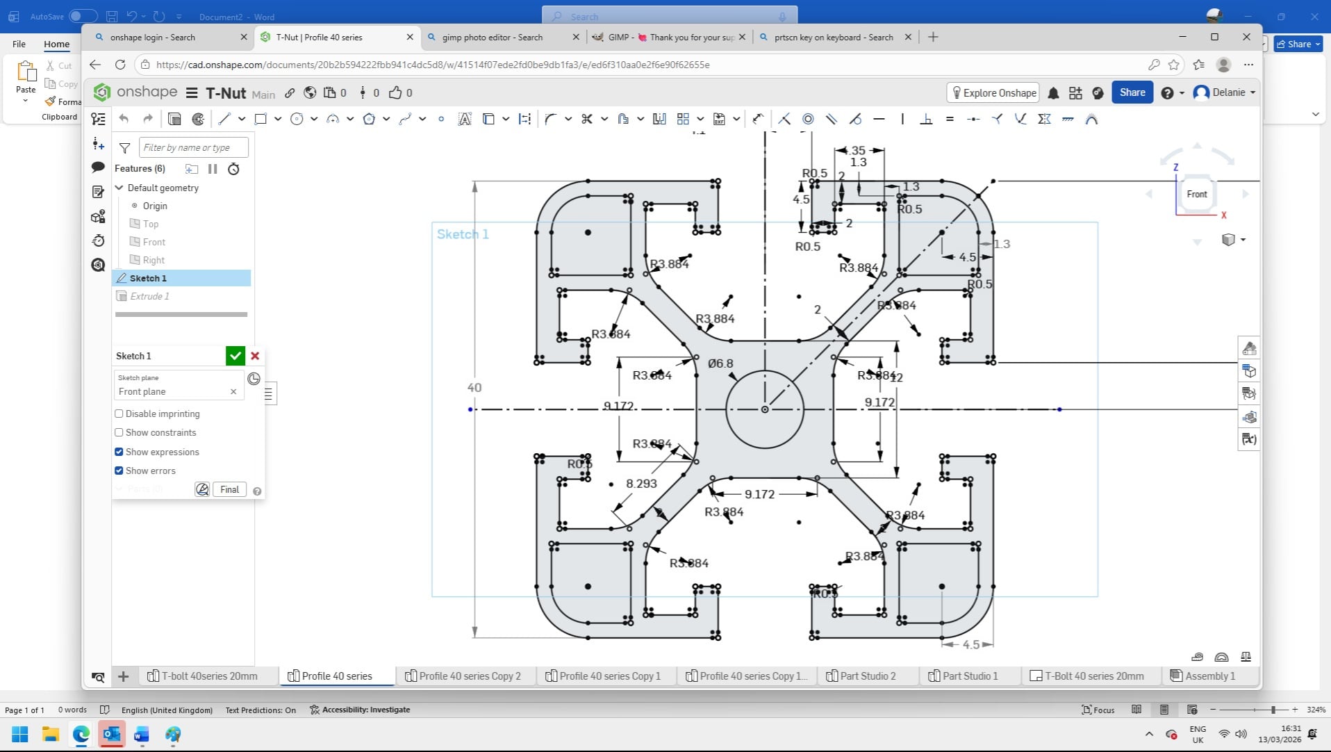

Hi folks,
I am new to onshape and I need some advice. I have been to challenge my learning having done the initial course.
so I copied the above design for an aluminium extrusion with a view to eventually designing a monitor arm , okay a sillly project but i decided to use it as practice.
It took me a while to figure out all of the contraints but I did it and tghen extruded it.
Now what I want to do is make the next part which is twice as wide. I have tried mirroring the part along one of the verticle edges but the contraints do not get duplicated, I also want to edit out the combined face so I have a smooth cetre section, this again seems to mess with the constraints.
so my question is what am I not doing right? and is there a better way to do this?
Thanks in advance Susanna

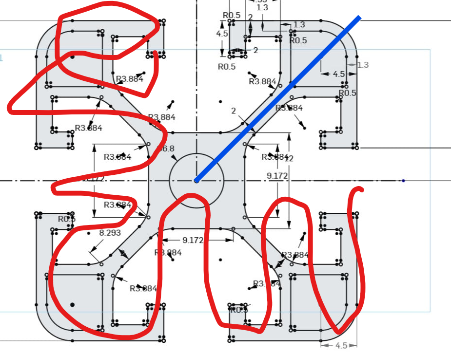

  • MDesignMDesign Member Posts: 1,333 PRO
    When doing symmetrical stuff try to break it down to a single repeatable piece of geometry to simplify things and use the bare min of constraints. In the case of your extrusion, you can easily see you can just do 1/4 of the design and save a lot of constraint headache. You can even take it further and just do 1/8 if you wanted to. The other 7/8 is just sequential mirror operations.

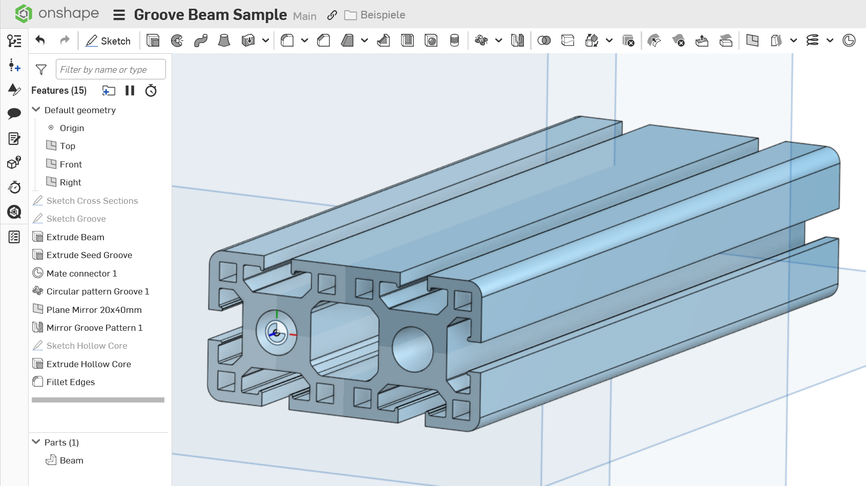

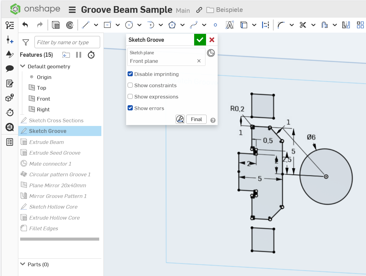

    MDesign and Shawn are right. I'd go one step further, though, for there are things that can be better done in 3D:
    I'd only create a small sketch of just one groove, because all the grooves, wherever they go, are identical. Crude example:
    One could of course polish that a bit. I'd then apply the first groove as a remove-extrude on an extruded rectanglular profile and then feature-pattern that, add the 4 edge fillets.
    That'd probably be the least number of clicks, and it would allow for fast sketching, easy editing and allow creating all variants of the profile from just one set of features.
    https://cad.onshape.com/documents/1dfd31f4d5ecd580a5b18745/w/72db265a3e565ce72d1fe309/e/ecacffc3580ac18b42bdc2aa?renderMode=0&uiState=69b552ae1cca71a41c2eaa72
