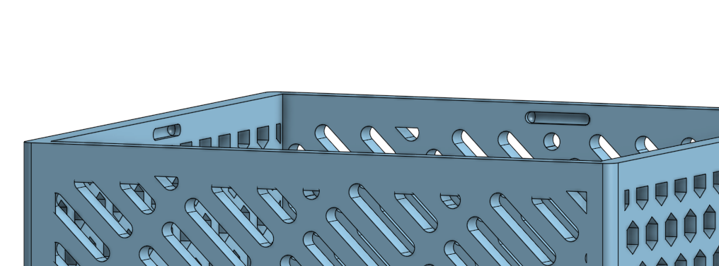

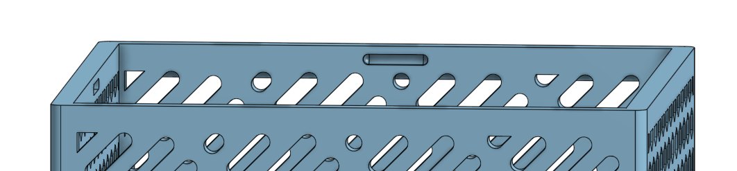

Greetings! I believe I have run into a slight issue with the Boundary feature in Grid Extrude. My setup is a repeating rectangle set at 45 degrees with rounded ends. The objects at the edge of the boundary are getting clipped. Images below for the issue I am experiencing with further explanation…sorry for the large images. I did not see a way to resize them and put them inline or similar.

If you flip it around, you will see how the boundary clips over the extruded shapes (in this case I am extruding with 'remove' through the entire plane).

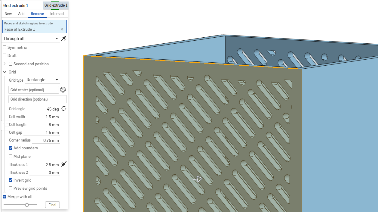

The interesting thing is the opposite wall does not exhibit the issue, even though it is the same extruded set of features. Here are the settings I am using for Grid Extrude:
Can you confirm this as a bug? Hopefully it isn't just me. I did go and check to see if there was an update available, but it looks like I am using the most recent version.
