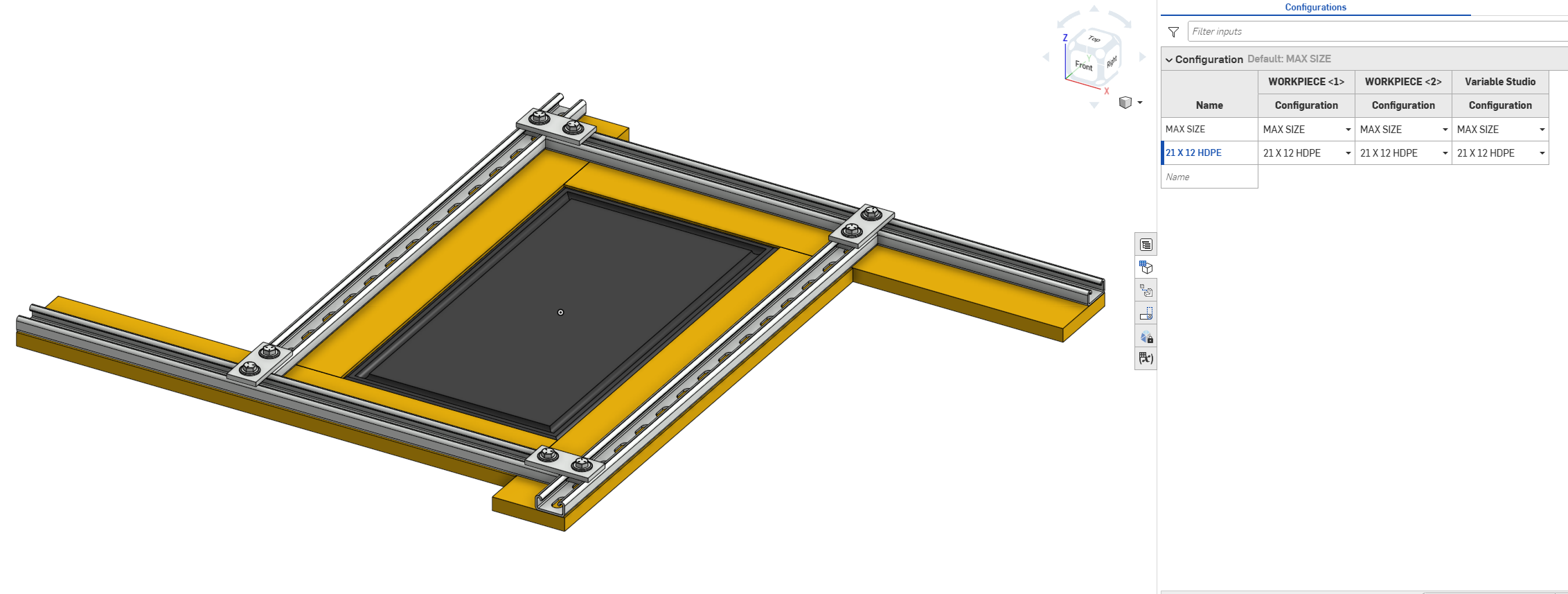

Noob here has channel strut 'frame factory' document, able to generate flat and box strut frames in many configurations.
Composite-part frames may them be used in target documents like shelving, shop tables, etc.
But once past initial design development, I'd be surprised if OnShape doesn't provide the ability to easily disconnect 'manufactured' parts from the source and utilize them independently in target documents, so they stand alone without dependency.
Something like snapshotting & exporting a unique parts configuration.
Problem is, I can't figure out how to easily do it?
Target document is here, need to disconnect both steel struts and wooden plates.

    Objective is a stand-alone product document, say for a shelf (or a tool, like in the example shown) independent of the frame document that generated the framing parts. Gotta run right now, hope that helps, thanks @eric_pesty

    Thanks @eric_pesty for your feedback, the context is tooling design packages at major manufacturing company. Briefly for now, the idea is to sever dependencies, such that the tooling package can be archived and referenced later for operations and maintenance groups, often long after the original tooling design team has moved on. There are a number of reasons to eliminate dependencies even in the OnShape world I'm sure, among them a designer or team taking a public source document private.
    So I noodled out the process, but have some salmon to barbecue tonight, so I'll be brief for now and expand probably later this weekend:
    • OnShape native-generated parts (like the strut and plates in my cutting board jig): simply duplicate the tab in the reference document, and move duplicated tab to the target working document. Then simply replace instances, of the linked part in the working document with the now local part.
    • However with imported parts (like the nuts and bolts) the imported part tab cannot be simply duplicated. Seems like the best option is to duplicate the part-using assembly and move it to the target document as above, then re-download the imported parts and replace instances as before.

    There are a couple different ways to look at this depending on the "handoff" process. The most future proof option would likely be to just export the top level to a STEP file for the customer to hold on to.
    Note that you can delete (or make private or whatever) the source document after having inserted a linked document and the target doc is going to be fine. Nothing is going to break but obviously you won't be able to "open linked document" and make changes there… This can be an issue for an "editable" part but really shouldn't matter for an imported item. If the original document was configurable you would still be able to change configuration.
    Having a project entirely within a document can be an option but is going to require some work unless planned from the beginning. If you are going to have similar work like this, I would setup a template document with everything you need in it and do a "copy workspace" for a new project.
    For moving things, much better than duplicating and THEN moving, you can move to the target doc first, then do a "restore" to bring them back in the source document. This way you don't need to re-attach the links in the target (just do an "update to latest version" and click on the option where it says "source document has moved" (or something like this).
    See this for an illustration of pretty much this workflow:
