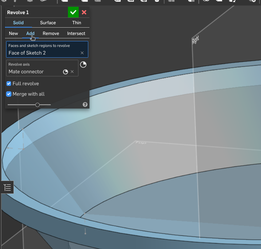

If you select Add (cursor location) and check "Merge with all" this will combine all three parts into one solid model. That should resolve your issue.

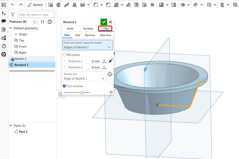

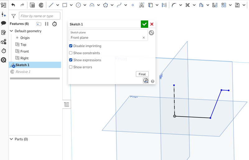

A bowl is typically made with a revolve only. Much simpler:)
Note the thickness of the bowl is not sketched, only the outer face of it.
Note "thin" is picked in the revolve. This gives the bowl its thickness.

@Pug_Wizard Yes, I guess I wasnt clear enough. If you select add for the last geometry created, this will perform a boolean merge embedded within the last geometry created. I believe this will give you the result you wanted.
Did you happen to try that?
