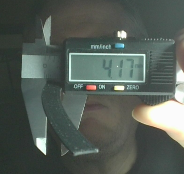

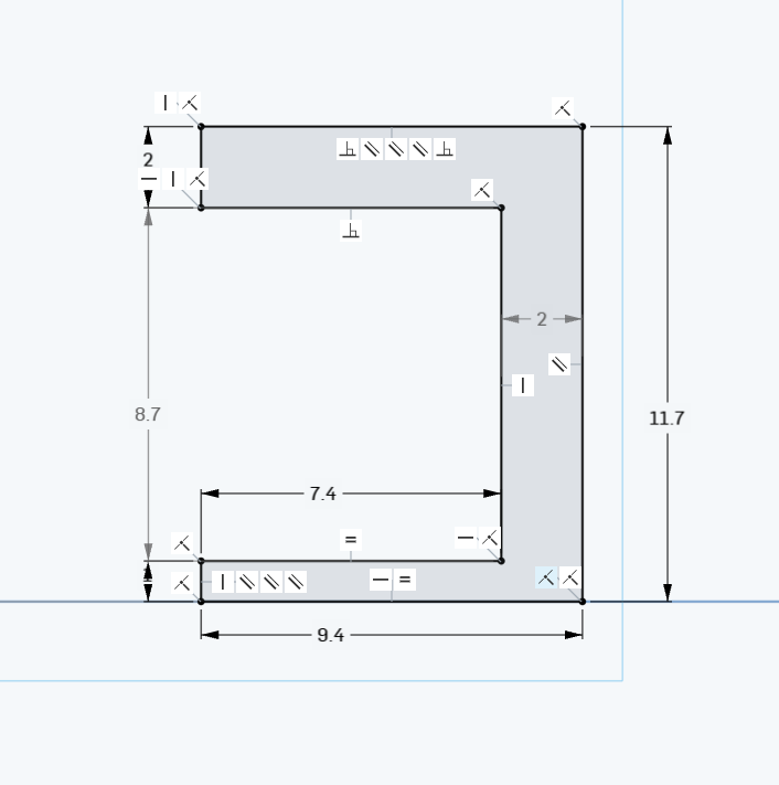

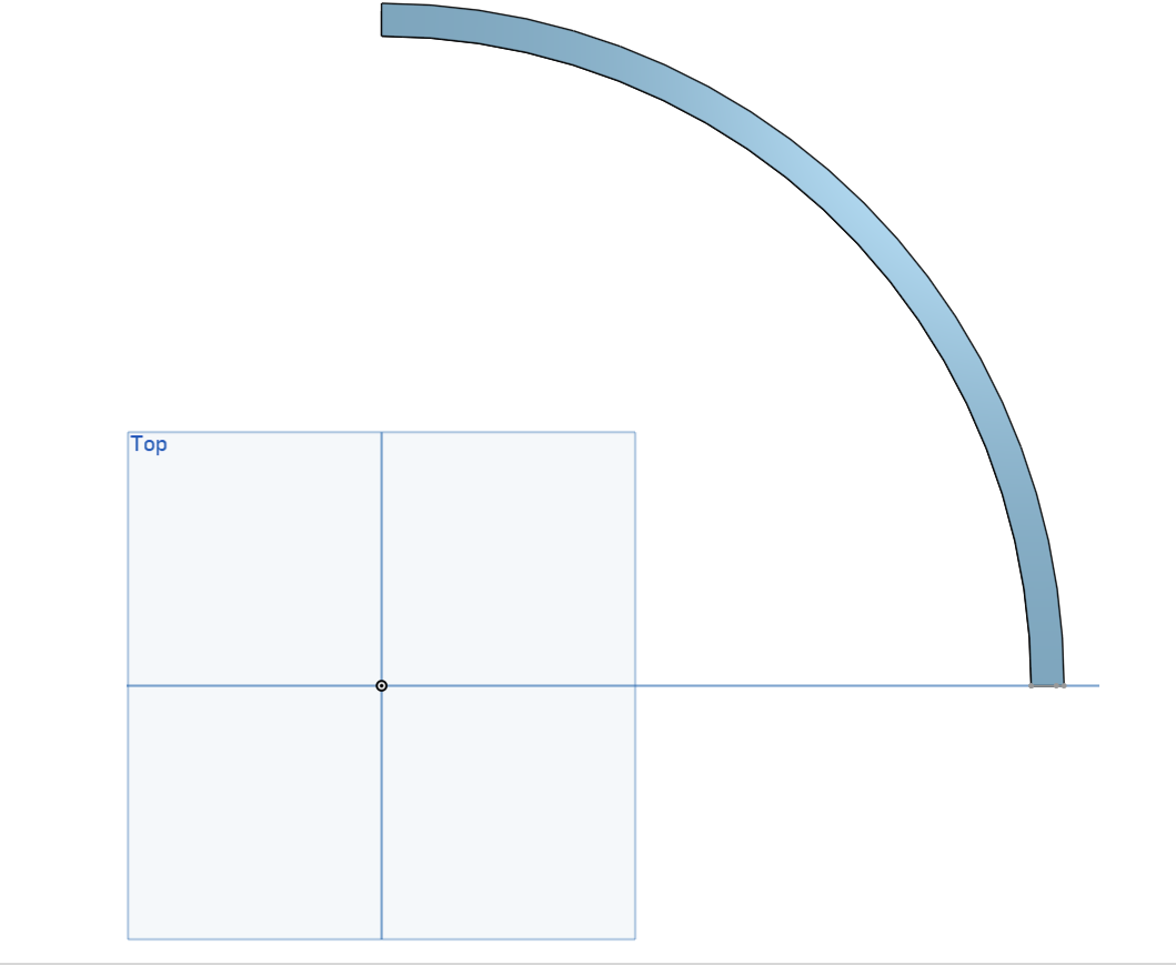

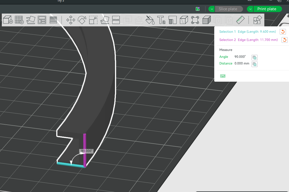

I get everything created in Onshape, export it to an STL file, and open it in Bambu Studio. When I go to print it, it is less than half the indicated size in the drawing and in Bambu. I've shared the files here. If anyone wouldn't mind taking a look at them and see if you can figure out what I've done wrong, I'd really appreciate it.

    Wild goose chase… I downloaded your files. Both the 3mf in bambu and the stl in onshape measure 11.7mm tall. The slicer in Bambu looks good.
    The issue is your calipers! First, you are not measuring properly in the jaws. Your part looks to be in the undercut area of the jaws. Second, your calipers were not zeroed before you started. The printed mm scale clearly shows over 10mm, while the digital display shows 4mm.

    Although agree with Willie above. Something is not adding up because the measurement on your Bambu Studio screenshot matches the Onshape CAD.

    you hit the nail on the head! I actually was zeroing out my calipers when I was using them but for some reason the calipers weren't measuring correctly. I ended up having to do a battery pull to get it fixed.
