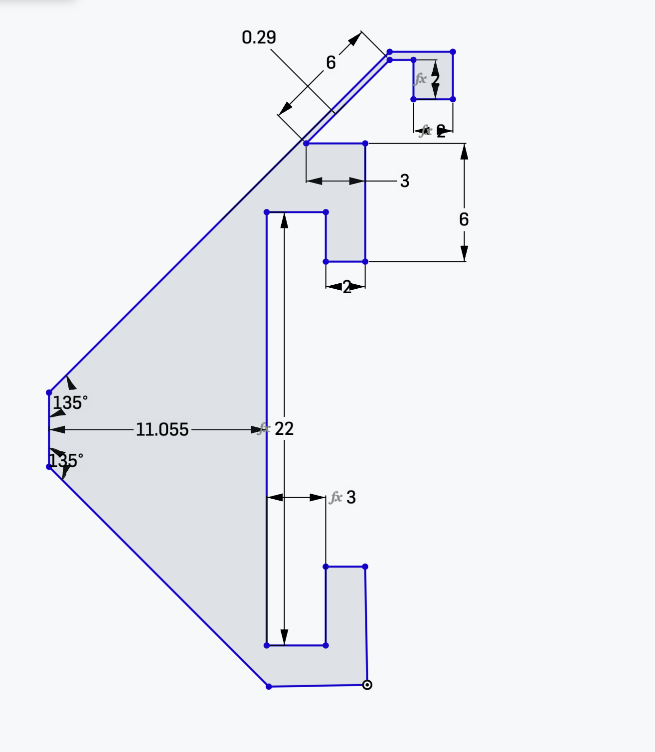

How can I define this width to be more than 0.29 without the entire sketch messing up?
daniel_rodríguez_riverodaniel_rodríguez_rivero Member Posts: 13
Hello.
I have the following sketch, which is an old one I'm updating to add an extra tab.
That 0.29 is something I want to define to be bigger, but if I do, the entire thing gets messed up. I don't know what other restrictions I can add to make it work as it should.
Here is the project: https://cad.onshape.com/documents/5a2f8b4592e085fac2650d1c/w/4922f296e9f395fe2d6bcc02/e/983e89b062ae036b28a51d67?configuration=List_oMw3jz3ZSYvjDQ%3Dgrueso&renderMode=0&uiState=69c01a37ca290310bdfb2f03
  • SMURFCADSMURFCAD Member Posts: 68
    For starters, your lines are all blue which means the sketch is not fully constrained. I would start by fully constraining then work from there.
    -S
  • MDesignMDesign Member Posts: 1,341 PRO
    you must learn and use constraints to develop relationships in your sketch and control what is allowed to move and how.
