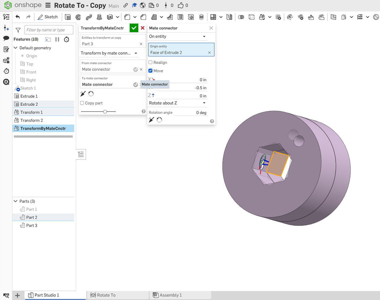

    CADNurd Member Posts: 166 ✭✭
    I managed to realign the two parts in your example using only Transform, with mate connectors. I did have to manually input the extrude thickness though, so I suppose your tool is a little bit faster.
    https://cad.onshape.com/documents/84d02498b3e8fd3193c895ca/w/8facd54694bf4d3f438ee3c0/e/2c2829fc55567ba5389e8e7e?renderMode=0&uiState=69d4f21b6be0f97797158b30

  • martin_kopplow
    Of course can you eventually manage to achieve the same move, using tranform by mate connectors, though then, you'd need to know (or else measure) things about the part and prepare the MCs carefully. Josh's FS is nice in that it works without any preparation, conveying design intent, and it also reacts predictably to edits in the FT.
