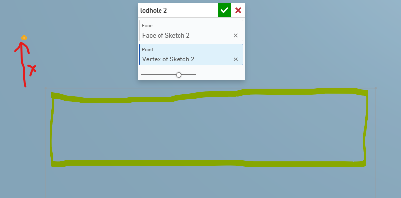

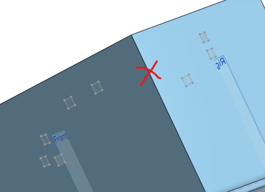

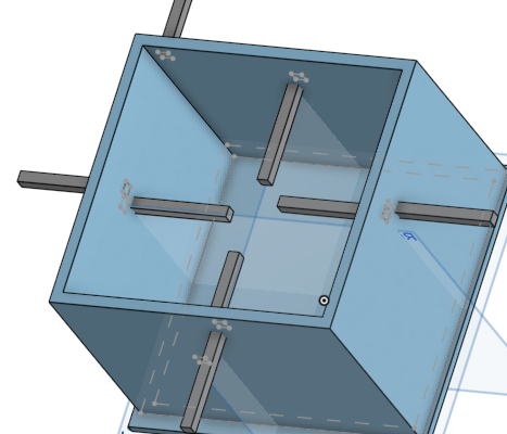

If I create a point and run the script on it it doesn't work
And it only works on a point of a 3D object.

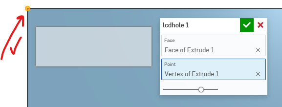

    Thank you very much for the response
    I really appreciate it
    But unfortunately the problem remains.
    When I cancel the BOLEAN it performs the EXTRUDE
    But with the BOLEAN it only performs a draw
