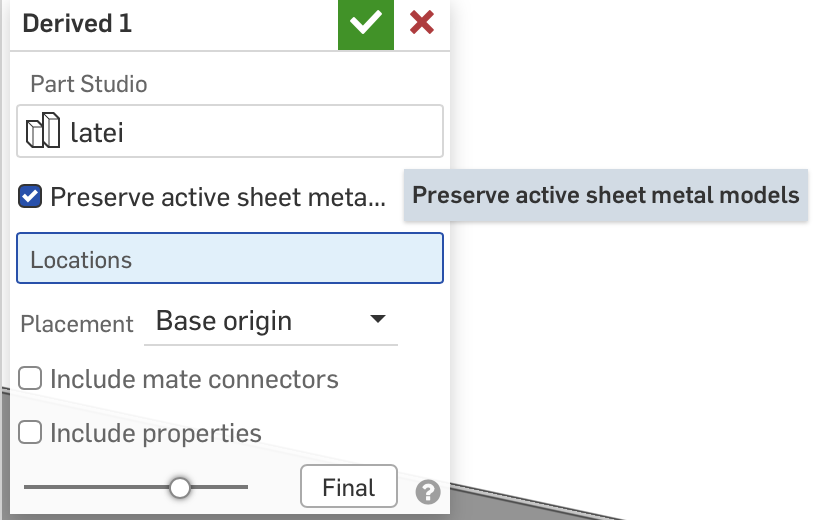

    I'm not sure about the context here, but have you tried deriving all the configurations into one Part Studio? There should be an option to check the box "Preserve active sheet metal models".
    This way you have all the sheet metal models in de flat view, ready for export.
