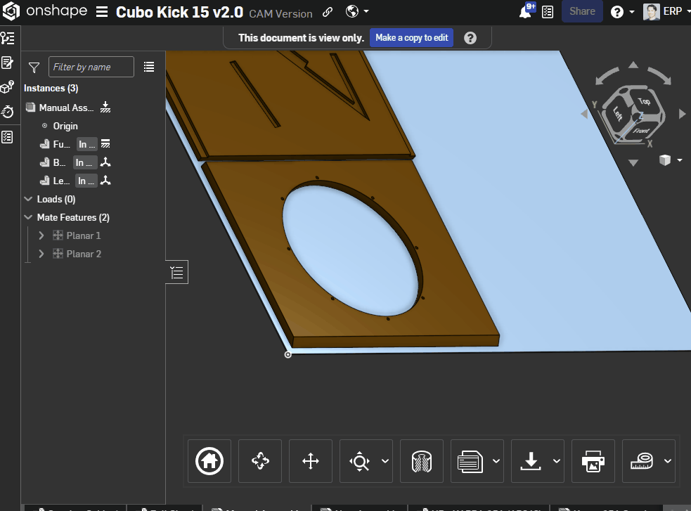

Thank you to anyone who is reading this question. I have designed a speaker cabinet that will be built using plywood, and need to layout the parts flat to make toolpaths for CNC. I have used the Auto Layout feature script for other projects, but for this project I need to manually lay out and arrange the parts on a flat surface.

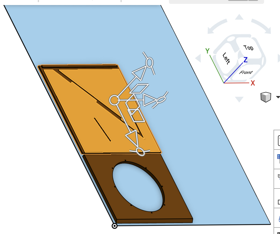

I created an assembly that contains a rectangle with the dimensions of a sheet of plywood. On that surface I am placing the various parts of the speaker cabinet using planar mates. Some of the parts mate as expected, allowing movement only on the X and Y axes, which are both parallel to the surface of the sheet, and rotate around Z. However, other parts have skewed X, Y and Z axes after mating, and I can not move them in the same way. Screenshots below.

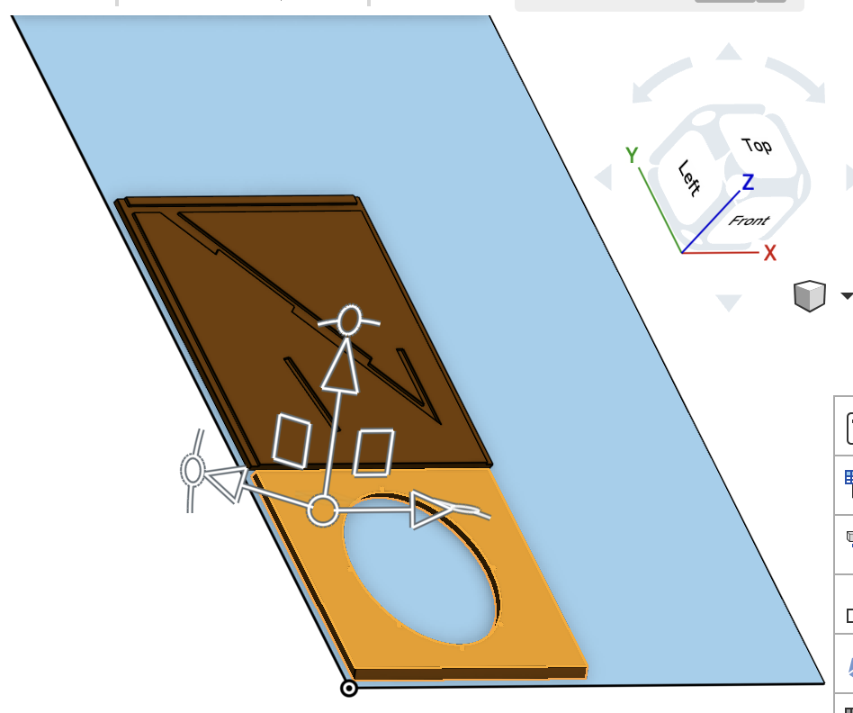

X and Y axes parallel to surface of blue part:
X and Y axes skewed in relation to the blue part:
Can anyone explain why the axes are skewed on some of the parts? Any other advice on how to mate the parts to the surface of the blue part allowing me to arrange them while keeping everything flat and parallel? Thanks for the help!

  • eric_pesty
    The triad will line up with the part axes by default, but you can drag the center to snap it to any implicit mate connector location and will re-orient itself to match what you dragged it to:
    drag.gif 398.2K

    From your screenshot, it must be the implicit mate connector (MC) that was picked for the parallel mate is not in the standard xyz direction. Always pick the part first, then the plywood second. The MC orientation of the part determines how it moves.

    With regards to the mate connectors, I always select the face on the part first, then the plywood sheet second. The orientation of the part in question (in the original part studio) is approx 45 deg skewed from X and Y. If the MC orientation on the part determines how it moves, is there a way to re-orient the part so it only moves on X and Y parallel to the sheet of plywood? Would a different mate connector or method of placing the parts on the sheet work better? Thanks again.

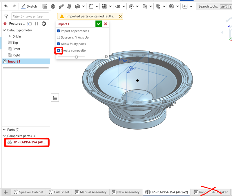

    For off-the-shelf part imports, click the "create composite" option on the import. It makes the whole speaker 1 part, rather than the 16 parts it was that then require an assembly. This techicque is great for PCB's, ball bearings, power supplies, etc. You don't need the internal details of the speaker as separate parts, for example (or a ball bearing, or a pcb etc),. You just need to know its overall size and mounting provisions.

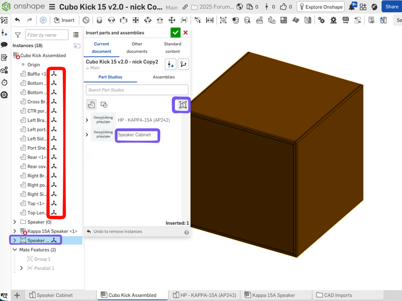

    On your asm, nothing is mated (red box showing all parts can move). Instead, when you insert the parts, pick the blue boxes. The upper right one is called "rigid" and that means it inserts the entire part studio with all the parts locked together in their correct locations. Mates or groups aren't needed, and if you later add a part to the part studio, it will automatically show up in the correct place in the asm.

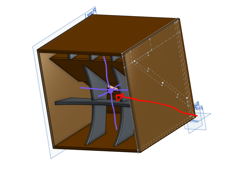

    It would help a lot if the main shape was drawn centered on the origin. This helps because of symmetry. The sides could have been mirrored, including their dado cuts, with the click of one button. Same with all the internal ribs. That would save a lot of time and effort, in general.
