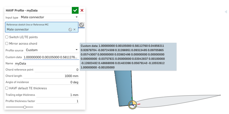

    @GregBrown is there a way to enter coordinates for an airfoil that isn't in the library? I couldn't figure that out. I ended up using the AG04 which is very close to the Zone V2 I'm using on the glider.
  • GregBrown
    edited April 15
    Yes in fact there is! Have a look in the UI, there is a pull down option for the Profile source, namely Custom vs Library:
    If you choose Custom then you can provide your own set of data points, as specified here:
    https://holbrookaerospace.com/sample-havf-airfoil-arrays/
    TLDR: the numbers are space separated and represent the x and y locations for the locations around the profile starting at the trailing edge and working their way anti-clockwise around. The profile consists of two degree-6 Bezier curves (one for upper, one for lower). The 0.000 0.000 point at the leading edge is not repeated in the list. The data (in meters) are all normalized for a chord length of 1.000 meters and the scaling will be taken care of in the feature.

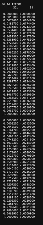

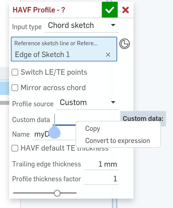

    @GregBrown I finally had some time to try the custom coordinates option, but I can't seem to make it work. When I right click to paste the coordinates into the custom data field, I get the options to "copy" or "convert to expression" but not "paste". Maybe I'm missing something obvious?
    Also I'm wondering if my coordinates are in the correct format. If copying from someplace like the UIUC website I get a series of coordinates like this, but I'm not certain that matches what you described 3 posts above? And if I get the coords from the Profili 2 software they are formatted slight differently
