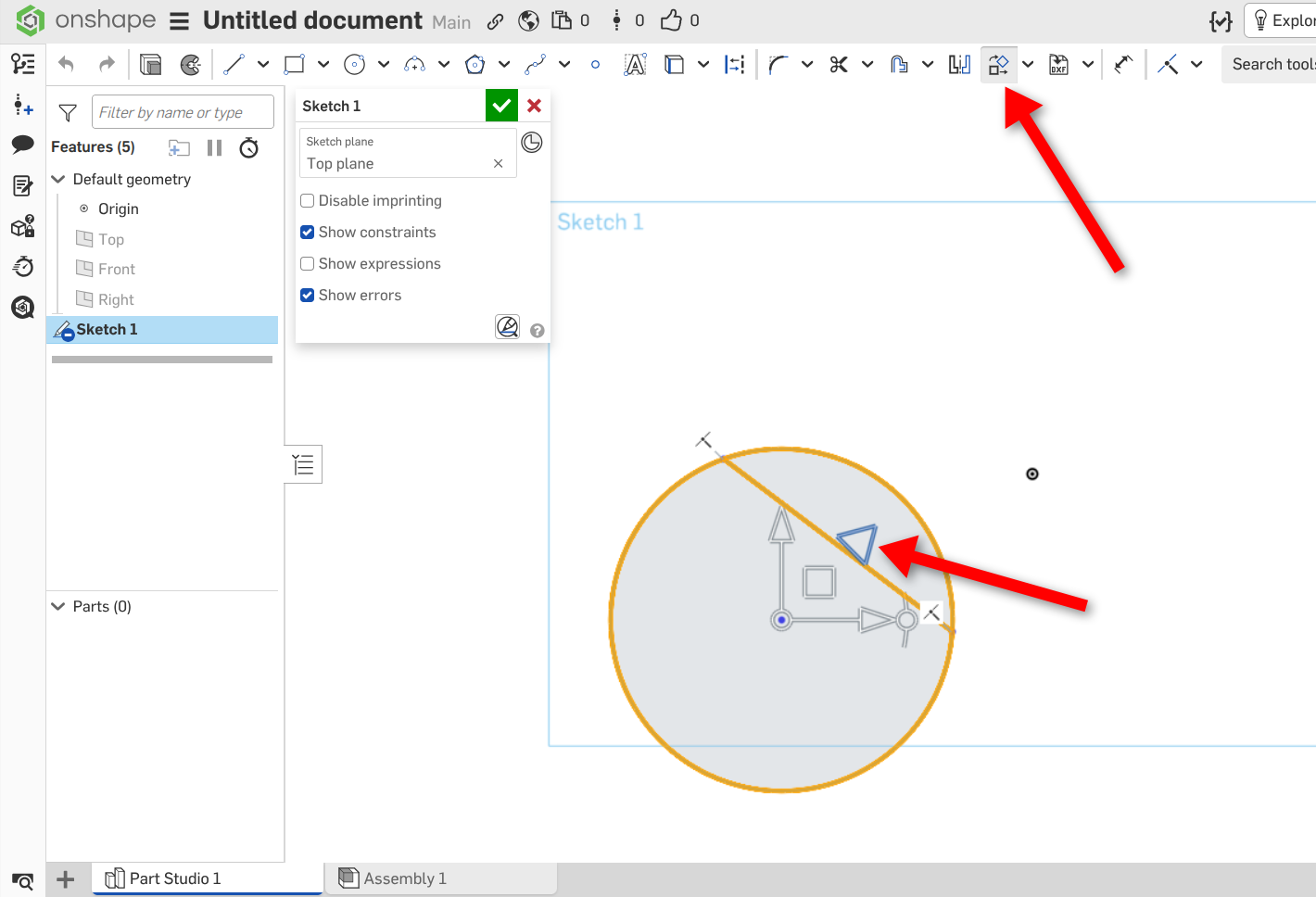

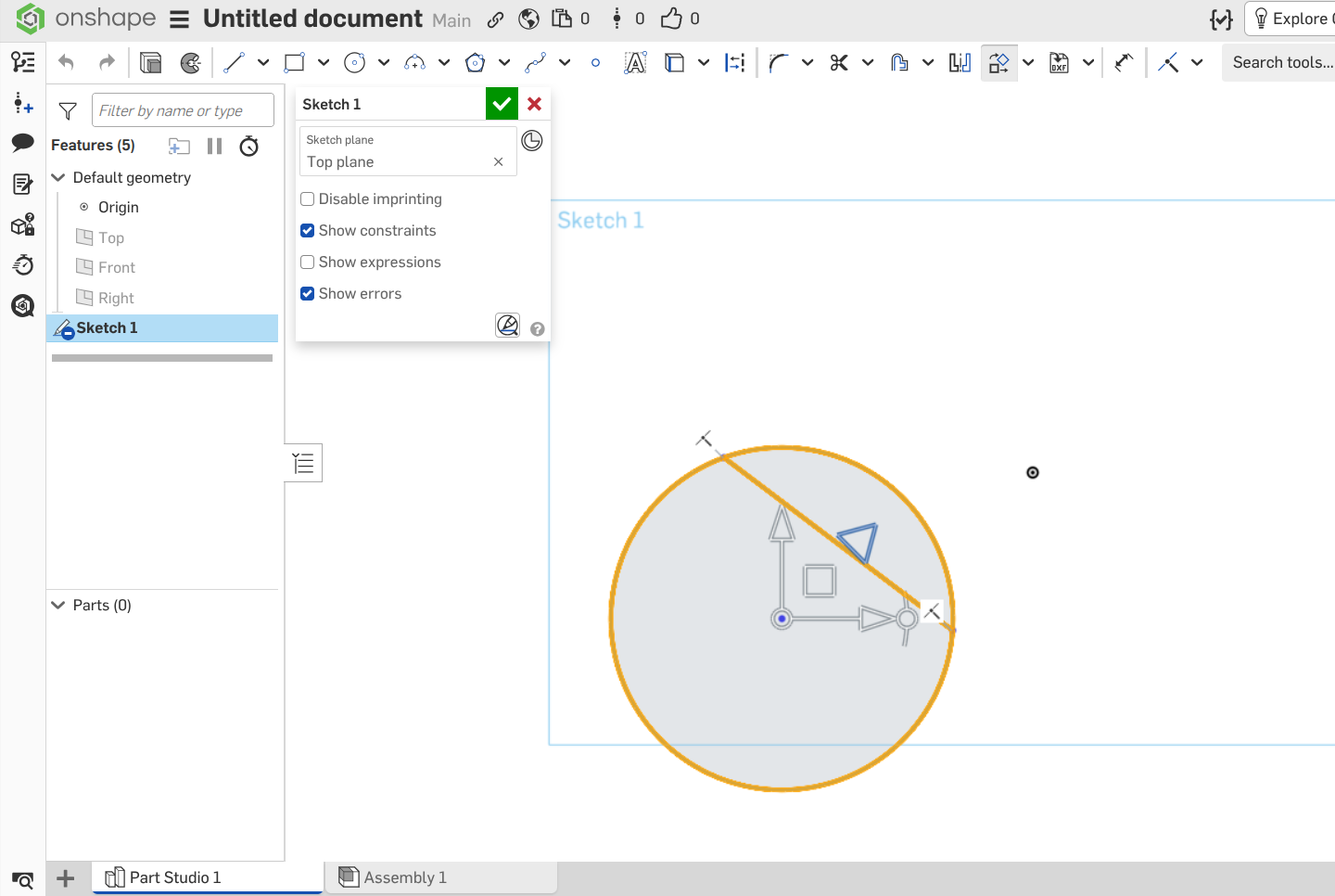

    With the sketch open, go to the 'transform' tool, then box-select the entire sketch - a triad-thing should appear - grab the diagonal triangle and pull it outwards and upwards - a dimension box should appear letting you input a scaling factor.

    Thanks very much for the reply. The question is how do you make that parameter-driven? AFAIK, the sketch transform tool is a one-time operation.

    Yes. You're right, a one time operation, which - for some reason - doesn't accept variables. If you search the forum for discussions on 'Sketch Blocks' and why Onshape doesn't have them, you might pick up some tips/advice.
