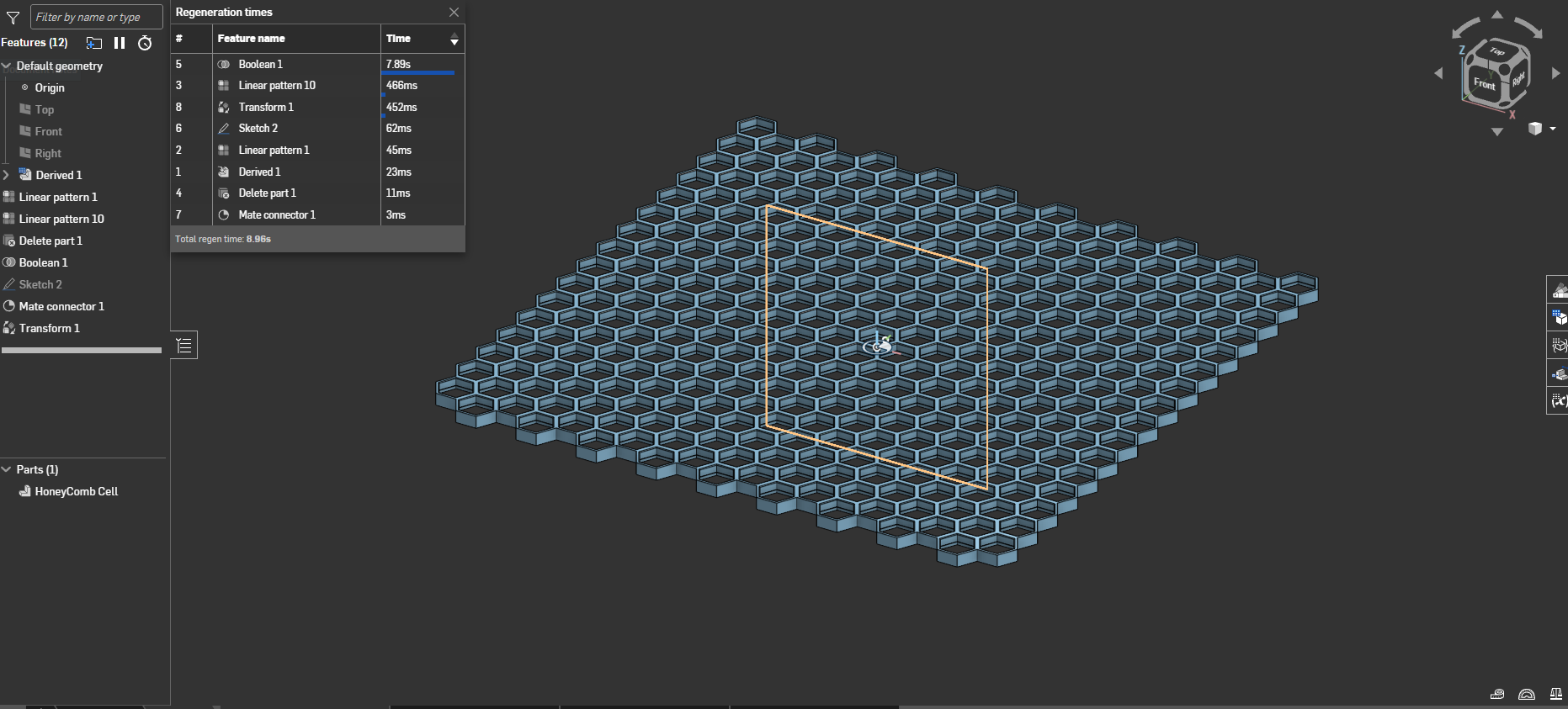

Hello, I'm looking for the best way to make a Honeycomb wall. unfortunately my part has some "complex" geometry so I can't seem to get the fill pattern tool to work. I started by created a single cell and then orignally did multiple linear patterns to form the wall. I have tried this 2 difference ways one taking 8.91 seconds and another 3.91 seconds. This throws a flag in my brain and makes me think that there is probably a more simple efficient way that I don't know about.
https://cad.onshape.com/documents/9488c6ae37762abbc1ead355/w/10dc564e8253812856bd9c51/e/ae376145690db3e392b7930c?renderMode=0&uiState=69e7d383dbab1ef21e3f3bd6
If anyone has questions or has advice I'm all ears thank you!

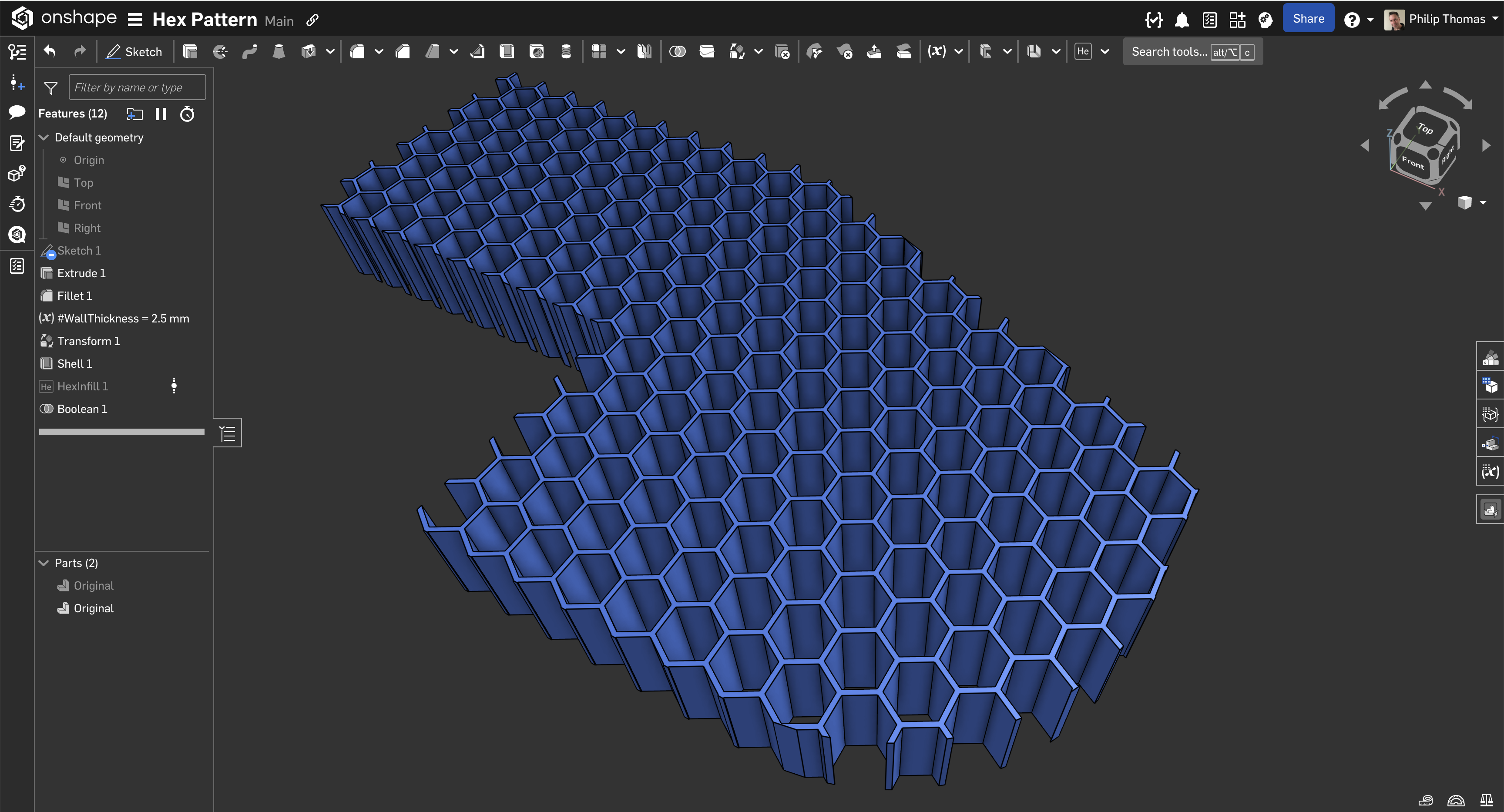

    Its hard to know exactly what you're looking for, but I hope this saves you some time.
    https://cad.onshape.com/documents/9cb887558d3b0fb2522b0f90/w/0b74d1d48e42571a0fca1c61/e/fa756a84975569dce74dc529

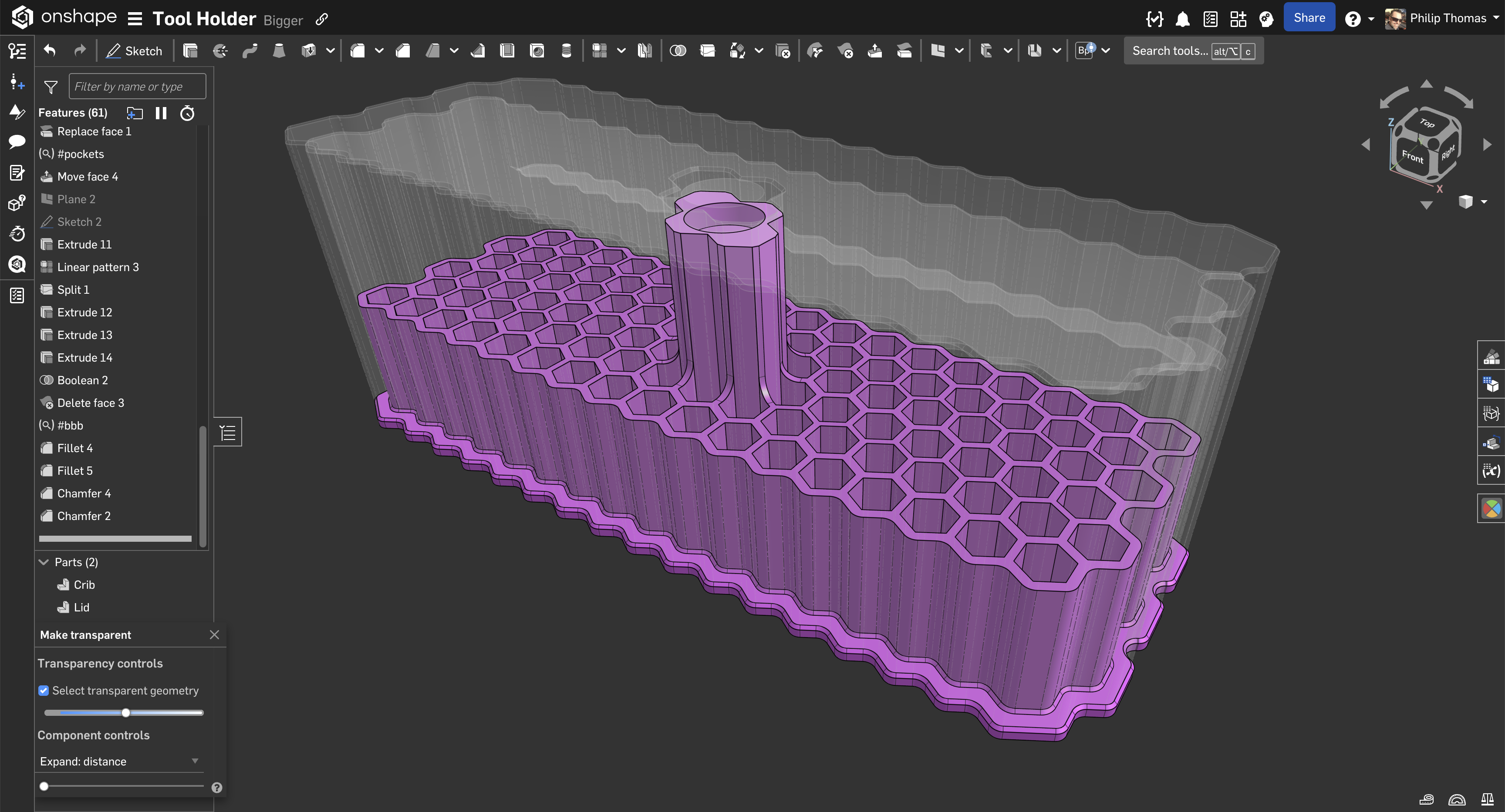

    Heres another one for you to play with
    https://cad.onshape.com/documents/9475efc7d2b70d180736de37/w/c64519094b6d87996e9823e6/e/c19a9aef97b2dc8bbc9c44e4

  • Connor_G_Jones
    Connor_G_Jones Member Posts: 8 ✭
    The 'hexagonal' pattern tool was the key. I had tried the grid extrude and fill pattern already however they didn't provide quite the functionality I was looking for.
    My current method was using linear patterns multiple times and resulted in long load times.

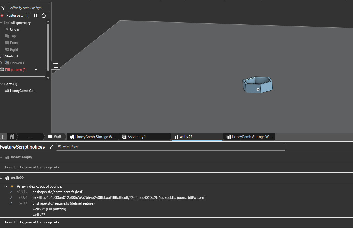

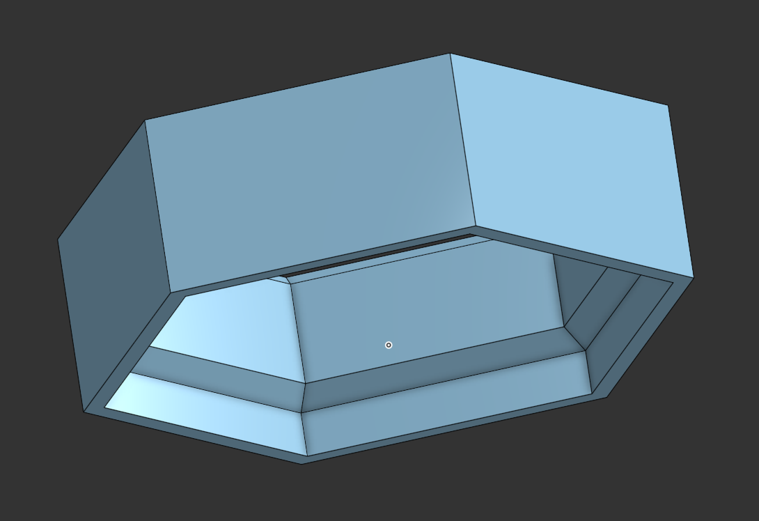

    Fill pattern would throw errors, I believe due to the geometry that I was trying to pattern. Grid Extrude didn't capture the geometry I needed. Images of errors and feature below.
    Fill Pattern Error
    Thank you guys for your assistance!
