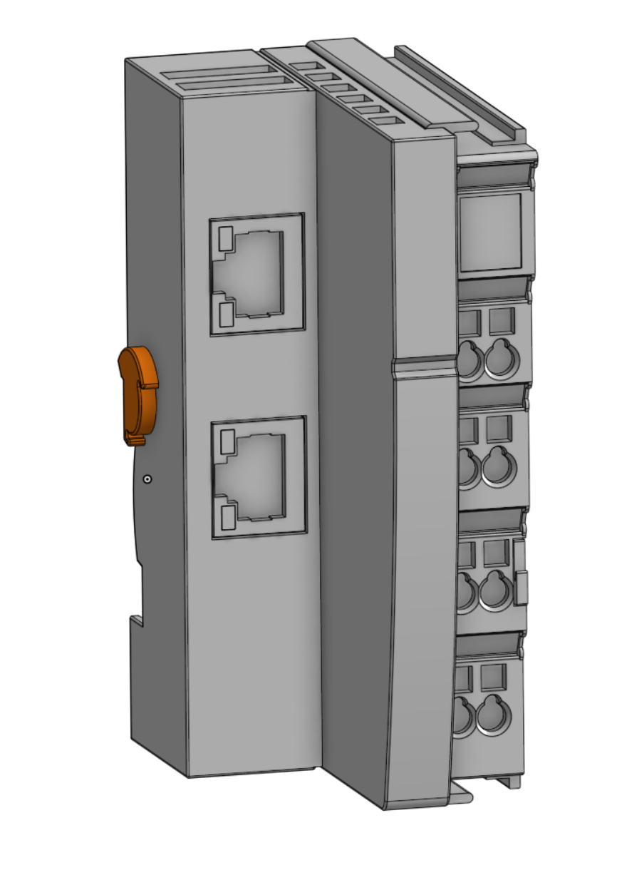

Hi @MichaelPascoe,
That's exactly what I want to do. We use Beckhoff terminals in our product. I'd like to project the front view onto the terminalfaces as a decal.
Is there an easy way to do this?0
