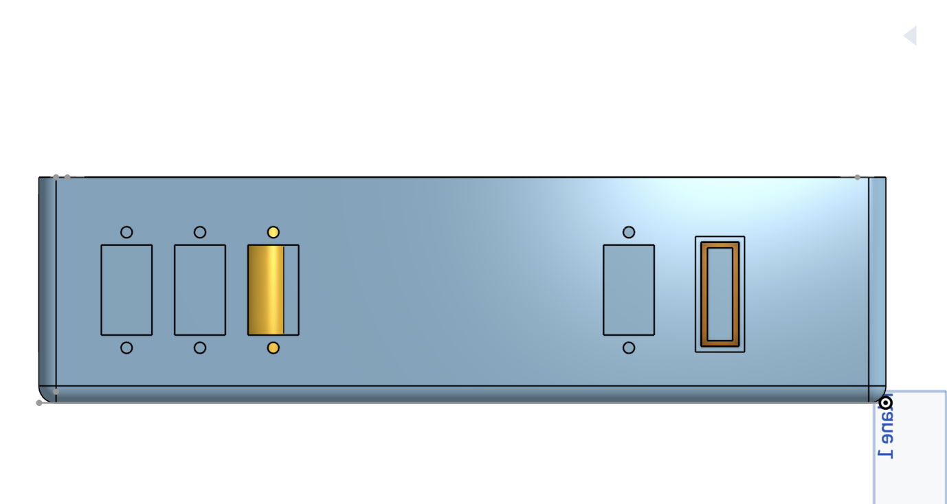

Using Split after Hollowing a box creates hollow, not solid walls

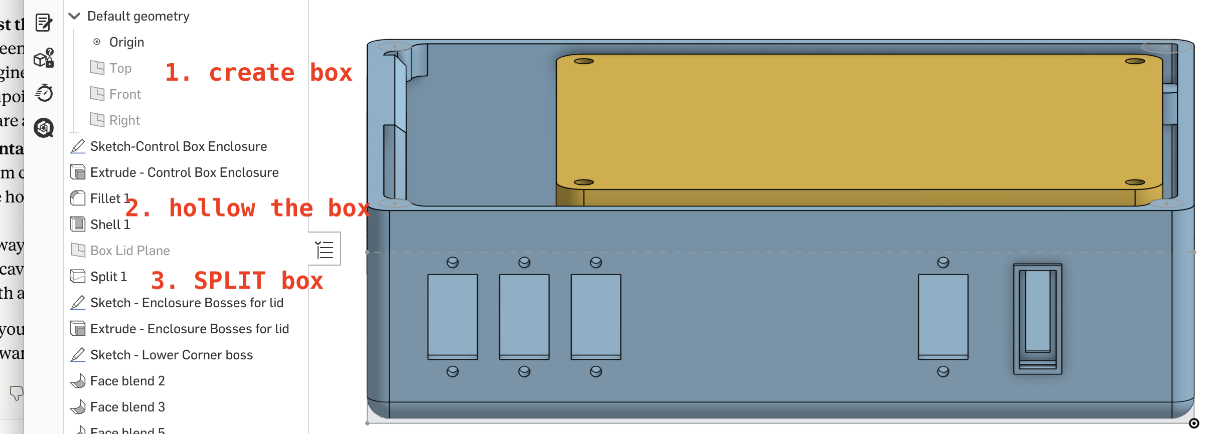

I created a cubic box.
Then hollowed it leaving 3mm walls.
I then split the box to create a box and a lid.

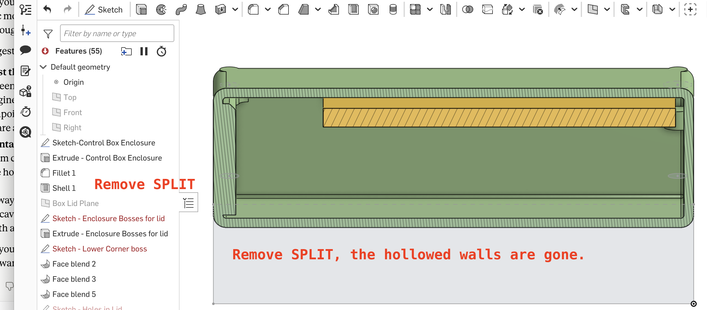

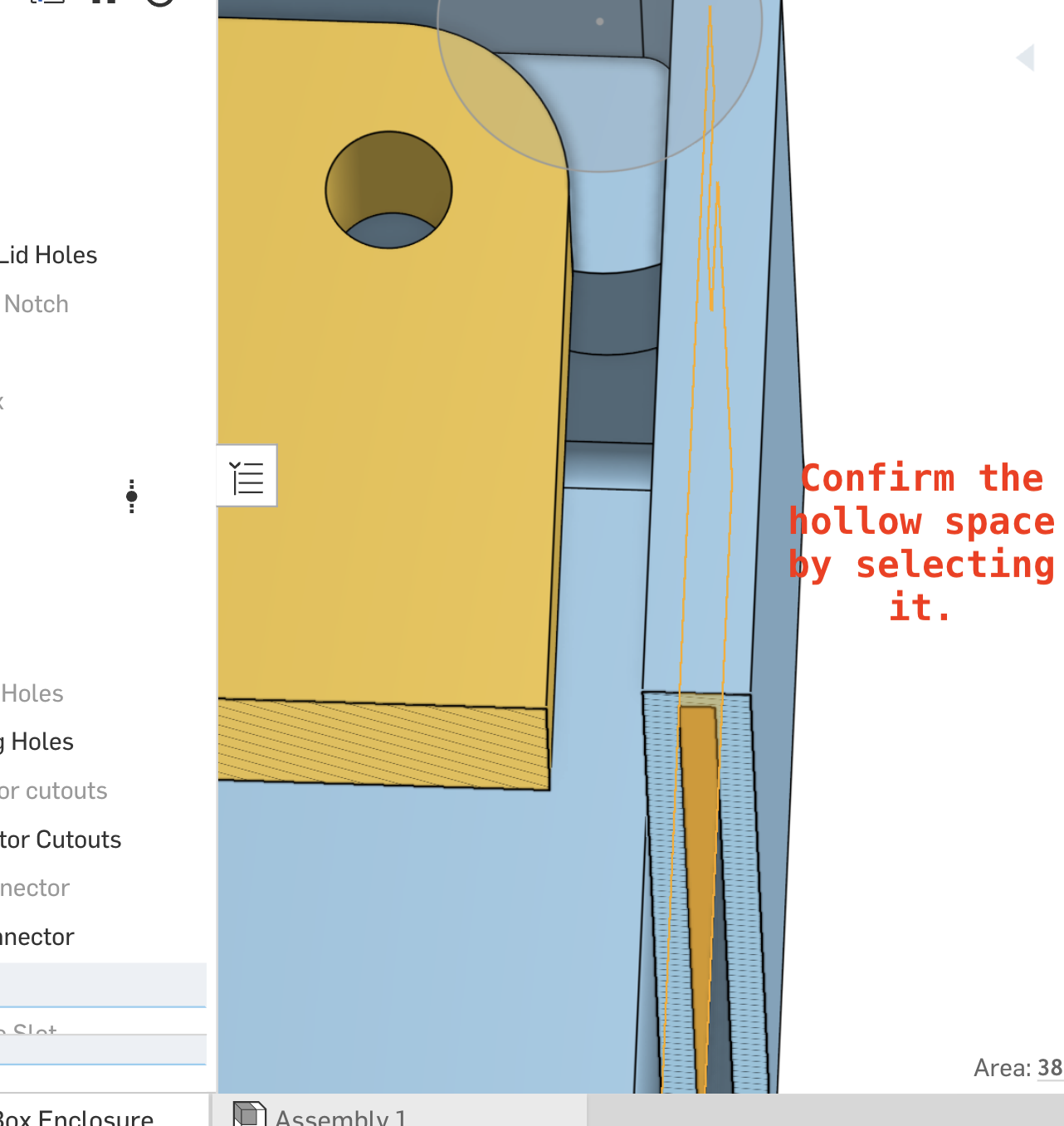

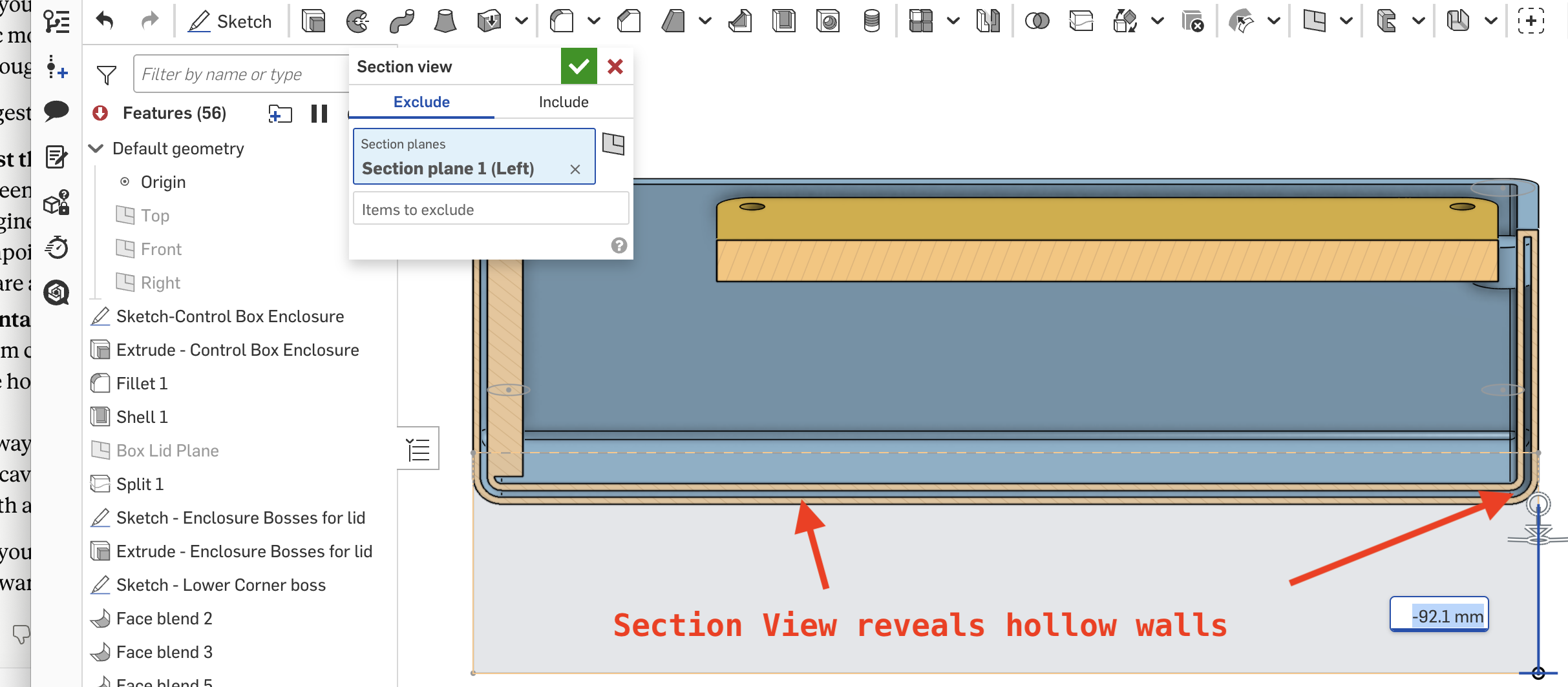

I later noticed via the Sections view that the box wall is NOT solid but has hollow space in it.
Through investigation, I see that it is the SPLIT function that creates the hollowed wall box, as the hollow disappears when I delete the SPLIT.
Why is ONSHAPE behaving this way?
Is this a BUG?
Is there a workaround to retain the solid 3mm walls I created.
Please advise.

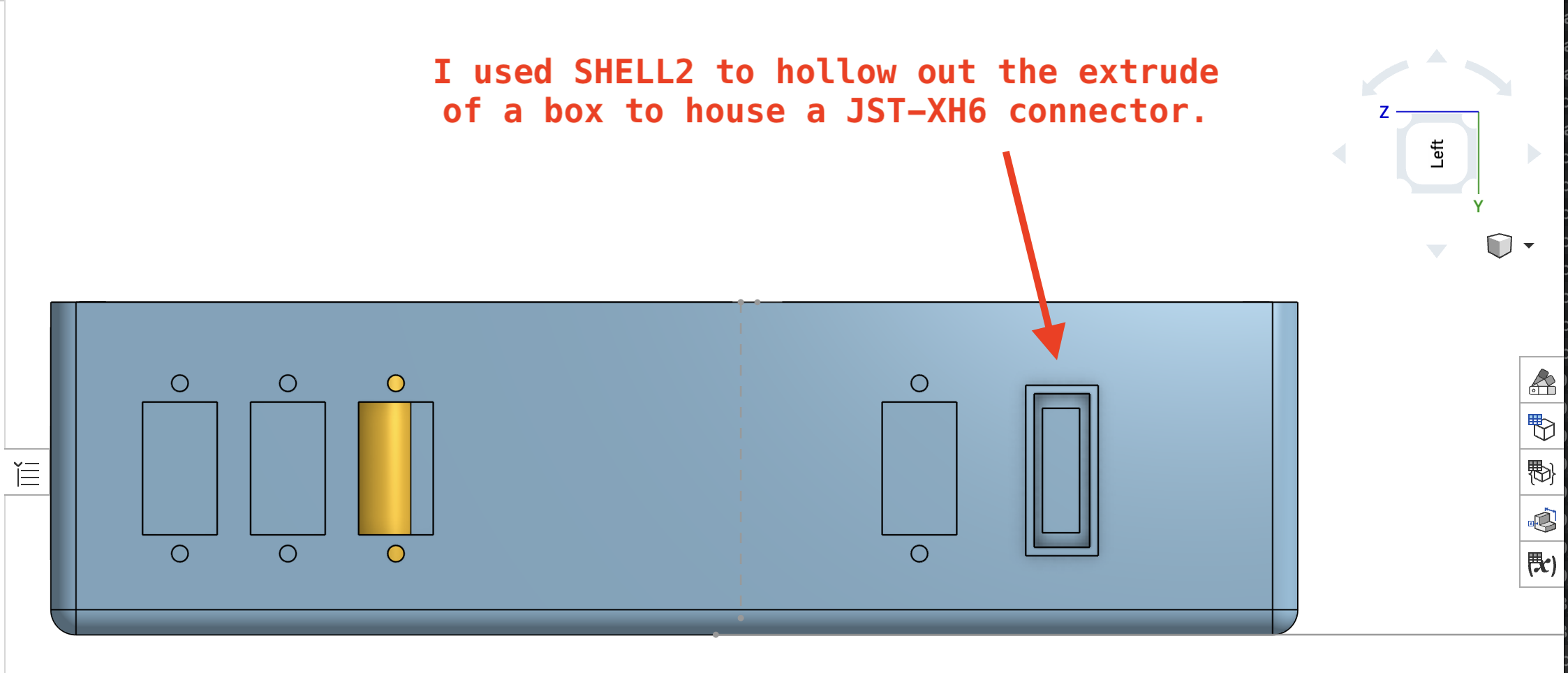

    Looks like you moved on (and broke lots of stuff) but it's not the split, it's your selection for Shell 2, so it's doing exactly what you asked it to do 😀
  • varocketry
    varocketry Member Posts: 12 ✭
    I don't think I've moved on . I did go back and clean up all the errors that appeared following an inadvertent FAT FINGERING and subsequent attempt at recovery. I even deleted the entire feature including the sketch and started over, but the hollow persists.
    I deleted SHELL2 to test and the hollow effect disappeared, as you suggested. THANK YOU.
    I'm sure this is a NEWBIE screw-up, but I don't understand why the second use causes problems elsewhere. It seemed like an elegant way to make the connector support ztructure desired.
