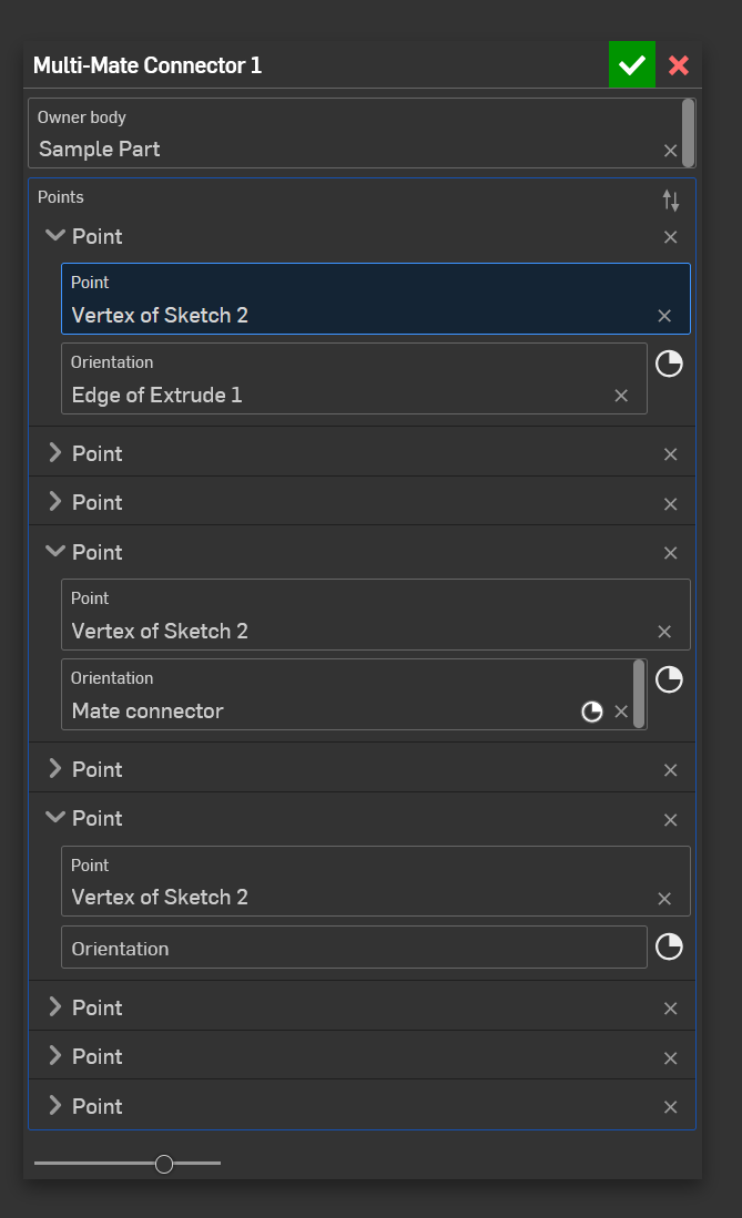

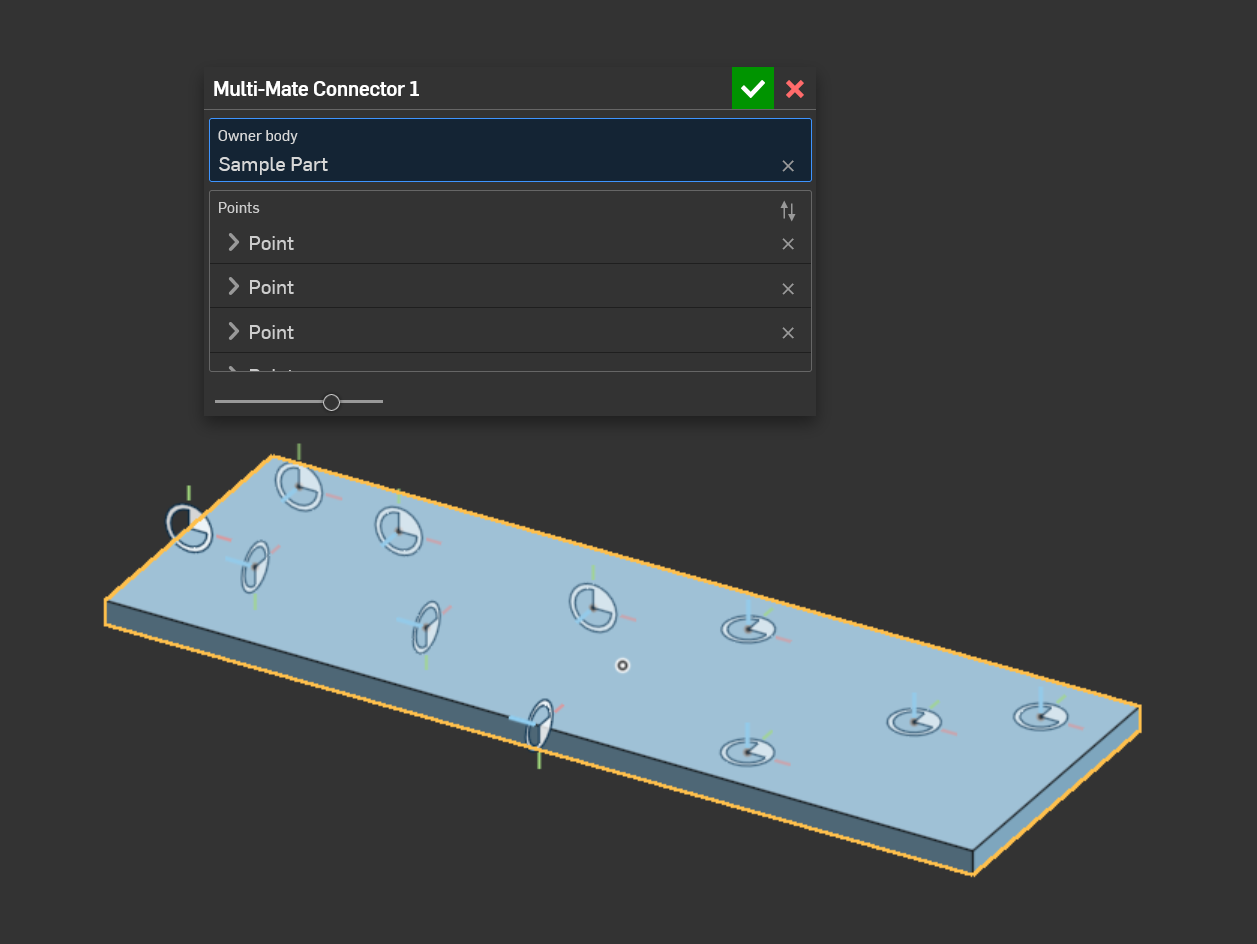

I find myself often needing a way to add a bunch of mate connectors to various, non-uniformly spaced points on a body (usually an in-context sketch to back-drive some mate positions) and with no built in way to do this as far as I can tell, I made my own.
All of the mate connectors created in the Sketch Point Mate Connector operation are owned by the same entity that you select in the dialogue, and each one can be individually aligned to either an axis/edge/normal-to-face OR an existing mate connector (with all the realigning and moving you can do with that). If no orientation is selected it defaults to the z axis being normal to the sketch plane
