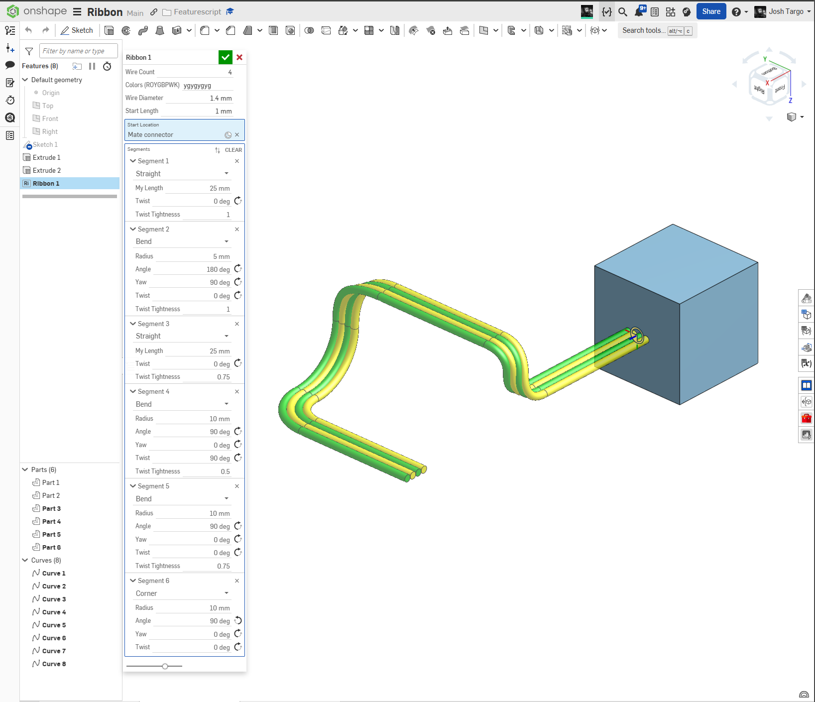

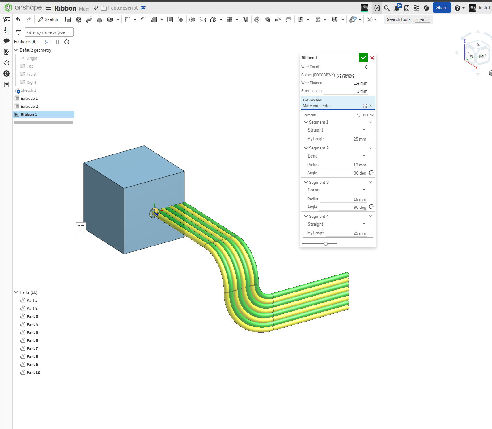

Probably already exists in some form, but I like to write. Makes ribbon cable, various types of bends, custom dia, colors, wire count.
https://cad.onshape.com/documents/a3de202140f671f983428b31/w/bc4418830e99d5dabc59cd32/e/f1e3404c704907207bffc0c3
still to do:
  • add a few more types of bends
  • add twist
  • change dia to GA.
  • add ability to spread wires at start and end to match connectors.
  • maybe add the common connectors i use.
  • use sheet metal terminology like outer, inner, keep for bends
  • track connectors, from, to, and lengths

  • joshtargo
    added twist and yaw

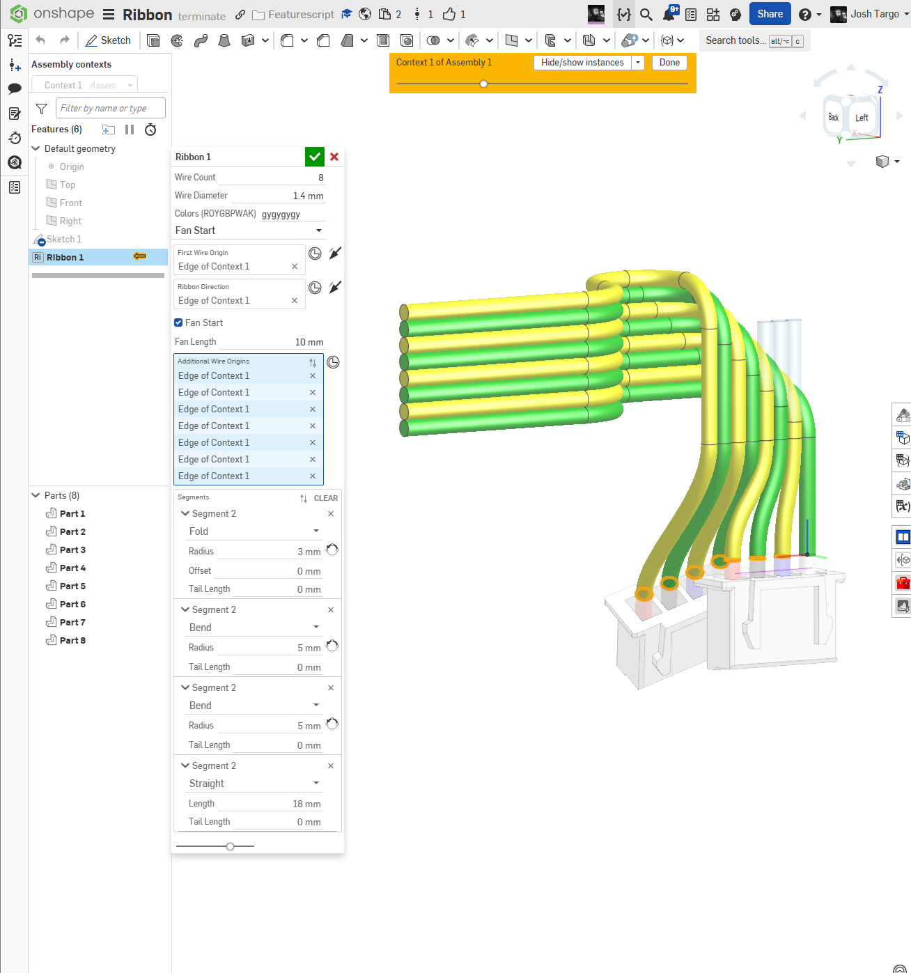

    Any plans for support to fan out the ends of these ribbons to different end locations? Like if I have a 6 wire ribbon cable with 4 channels going to signal pins that are all aligned, one little straggler on the opposite side of the board because of space constraints, and a ground line that's tied elsewhere.
  • joshtargo
    @Derek_Van_Allen_BD yes, I was going to adapt my Loft Individual FS for this, at both ends. I'm doing a full rewrite currently and it's going to be better all around

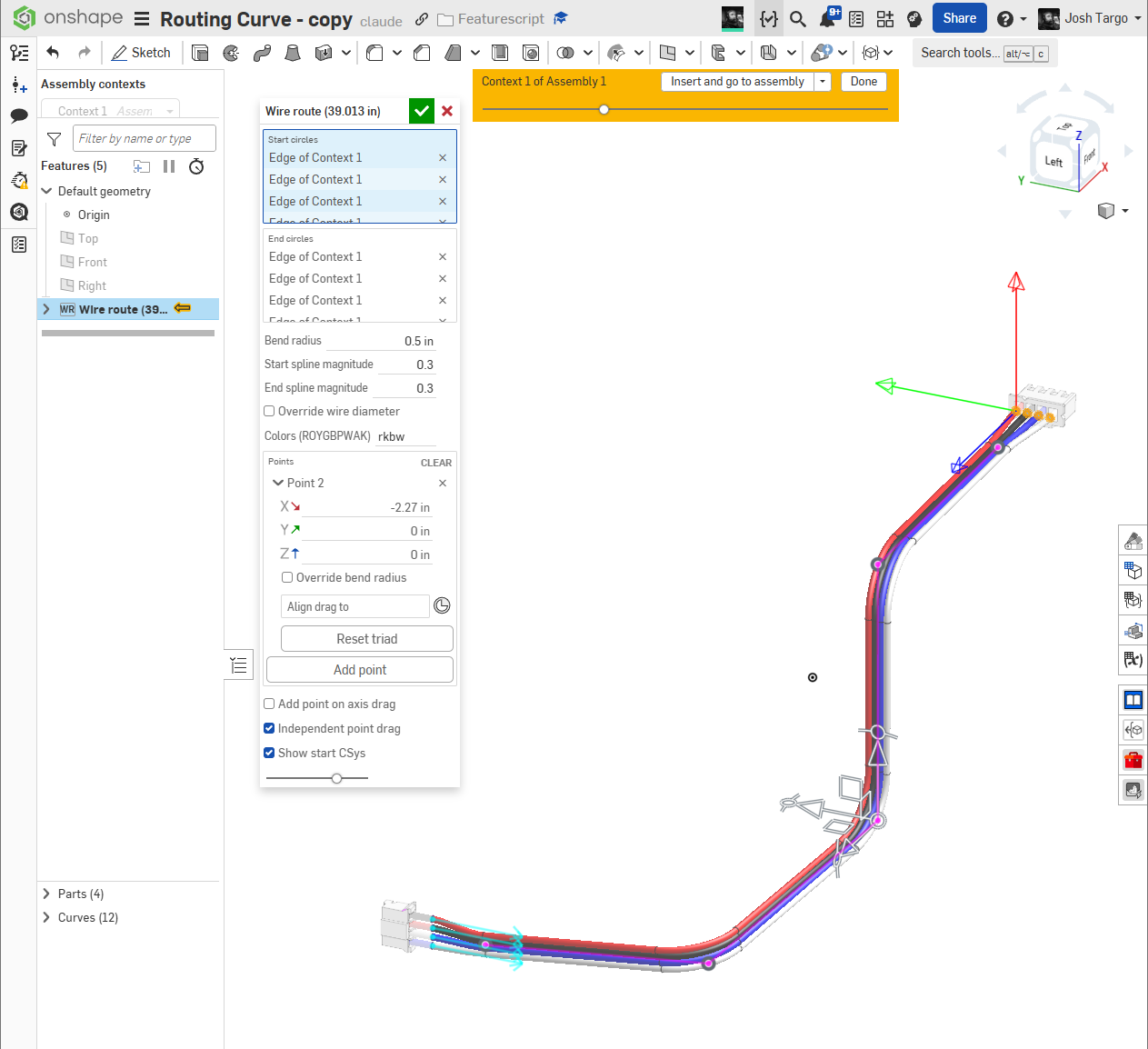

  • NeilCooke
    This is in my long term plan to add to routing - the issue is that the ribbon should fold at corners which adds a level of complexity (although, I already know how I intend to do it, but time is my enemy).

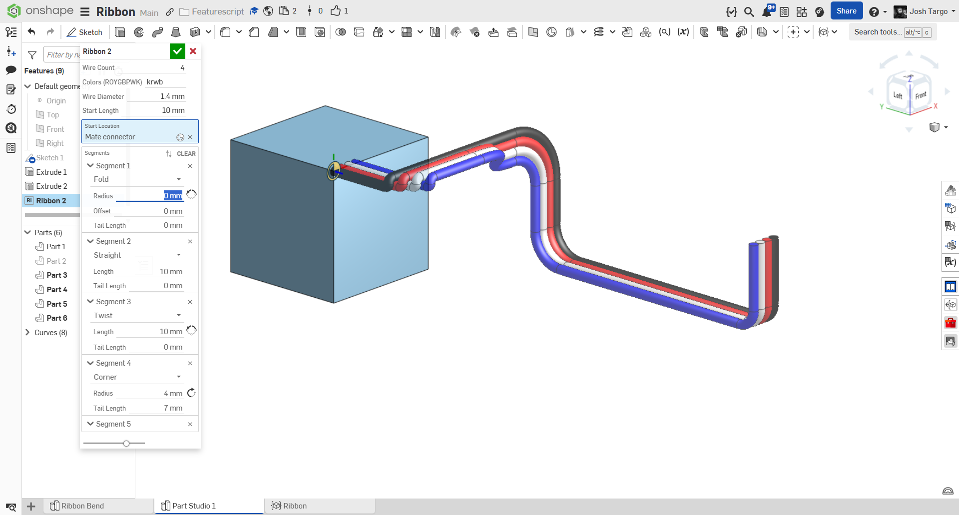

  • joshtargo
    reworked, new version could still be buggy. the big thing will be to make it behave like sheet metal where you can base the runs on existing geometry. Ribbon FS link

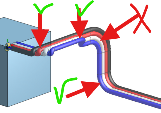

  • martin_kopplow
    The fold thing is important. It brings with it the necessity to twist the cable, once it reaches the destination, in case the pin arrangement there must be met. The transitions checked in green would be important, while the one marked with the red cross woud possibly not be needed at all, IMO, and should not even be promoted, fot that is not what ribbon cables do.
  • joshtargo
    @martin_kopplow I kept it in just in case someone wanted to use it for visualization. I am working on more updates, especially for the start and end of the cable.

  • joshtargo
    progress:
  • martin_kopplow
    That does already look pretty cool! :0)

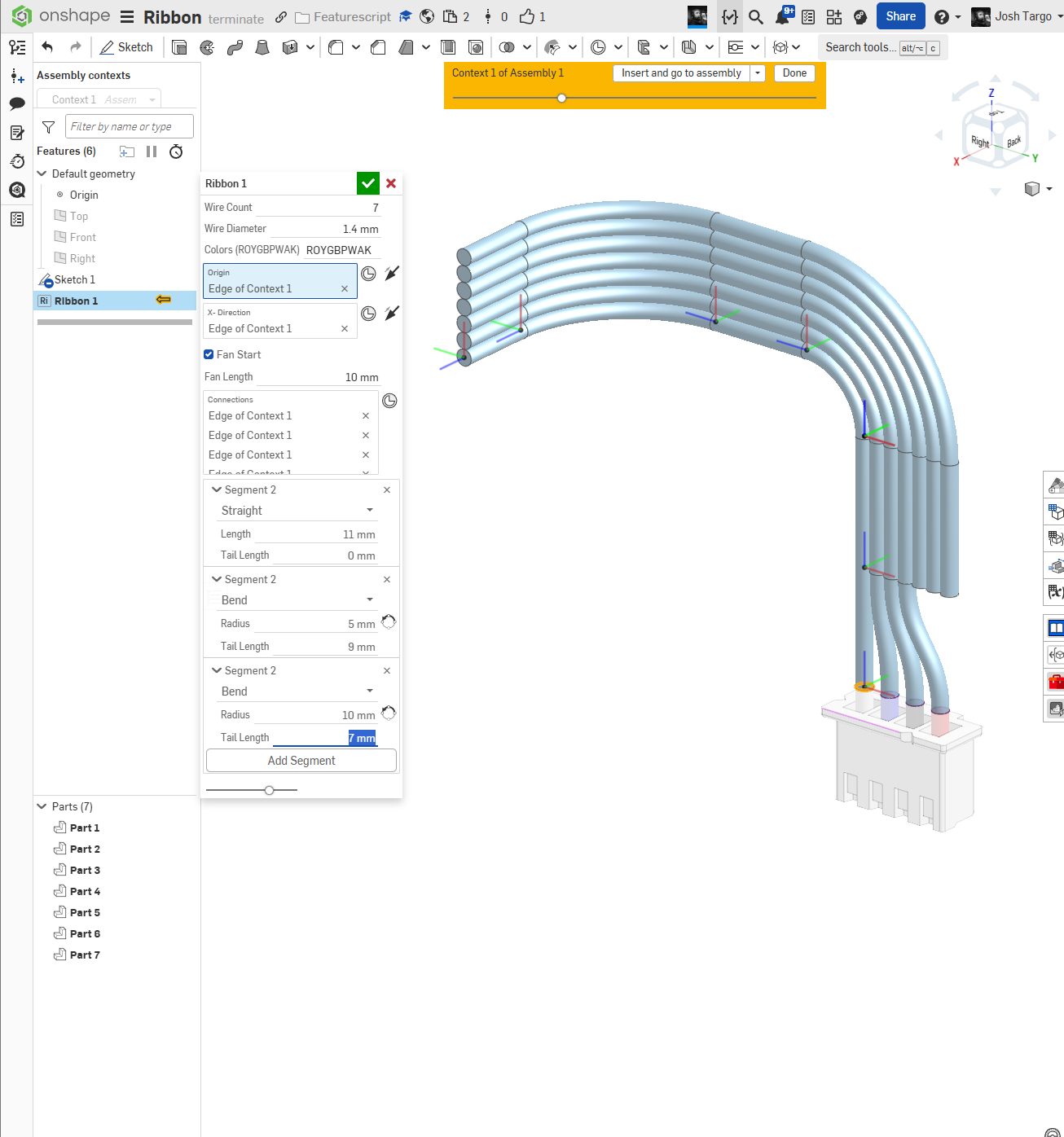

  • EvanReese
    I made some time to play around with this and I really like where it's headed. Two thoughts to throw into the ring here:
    1. It might be more helpful if it were designed to follow an existing path. The user could select a chain of curves, and override what's happening with each curve segment. For example, it would be easier to define a route using routing curve in polylines mode with a corner radius. Then I could pick that chain, and assign bends and twists to each segment.
    2. Are you planning to allow some kind of flattening for drawings later? It could be a separate feature that reads attributes of this one.

  • EvanReese
    You can certainly make it populate the array with Editing Logic. The implementation I imagine though is something like:
    1. User chooses a chain of tangent connected curves.
    2. Each curve gets a point manipulator on it which you can click to "Add and override" or something like that.
    3. When you click it, a new override array element is added and you can choose a twist value
  • joshtargo
    @EvanReese i'll have to think of a good way to handle the fact that the guide curves will likely be planar, while bends such as Fold will cause the sections before and after to be non-coplanar. maybe the guide curve is used for lengths, directions, and radii, but the ribbon will slowly deviate as it folds and flips.
  • EvanReese
    I was imagining this being done with a 3D Routing Curve
  • joshtargo

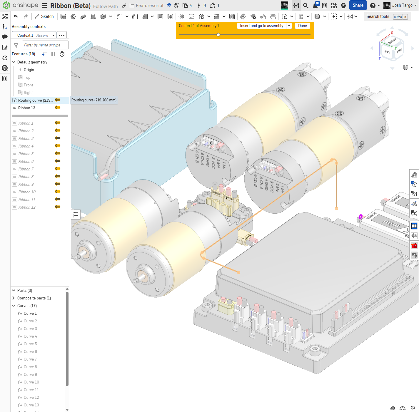

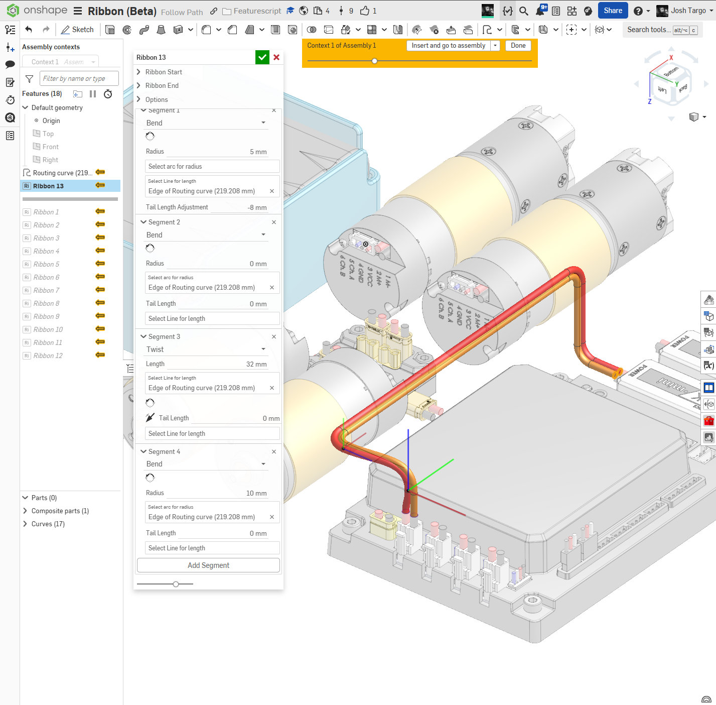

    edited June 8
    @EvanReese first trials of a rough follow system. you can pick lines for any length or radius inputs, then the (0 default positive) length field becomes a length adjust field with negative or positive values accepted (as seen in segment 1 tail)
  • EvanReese
    Is this a new document? I don't seem to have access
  • joshtargo
    @EvanReese sorry, yes, it was new, i forgot. great videos btw.

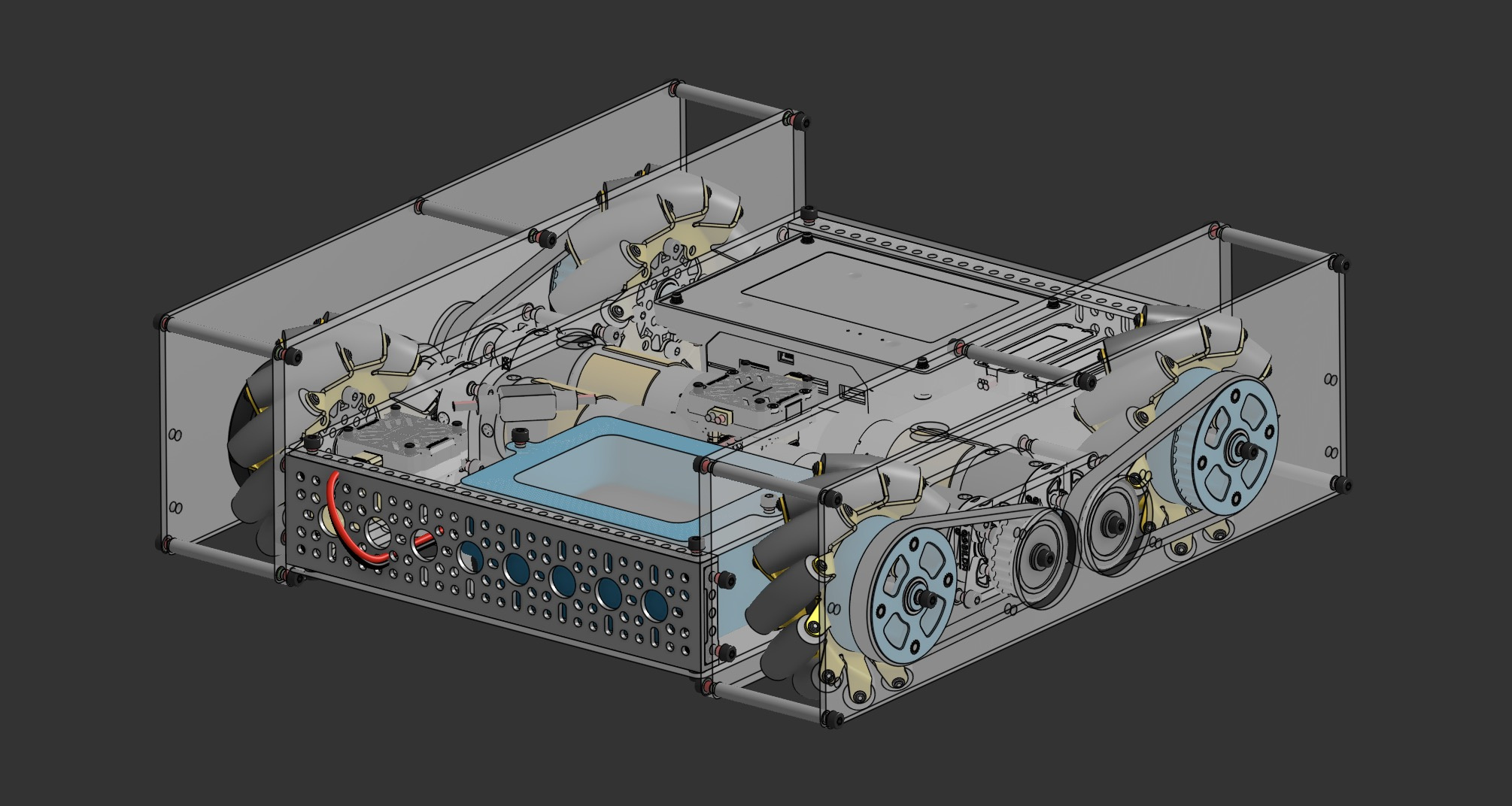

    @joshtargo are you an instructor? Are you teaching kids this stuff? I hope so. This whole thing is really well done not just the feature script "Ribbon" part but the whole project.

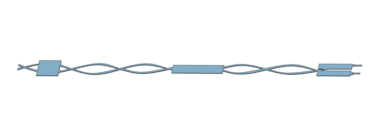

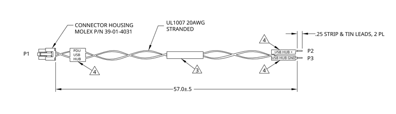

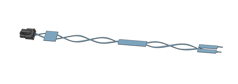

  • nick_papageorge_dayjob
    IDK if this is the right place, but could you do a twisted pair? We had a lot of cable drawings to create, and "faked" the twist so it shows up decent in a 2D drawing. Thanks.
