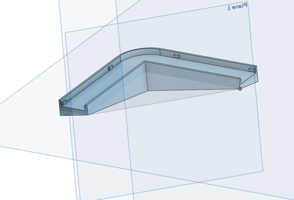

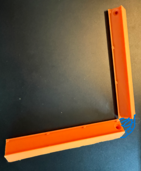

Hello, I'm trying to make a 45 degree corner profile.
The problem I'm facing is that I have to turn and rotate each side of the profile and add an extrusion at an angle and I'm not sure what's the best instrument to achieve this.
So far I did this using the draft:
but I need both profile sides to be at the angle 45 degrees as on the picture below. Any ideas?

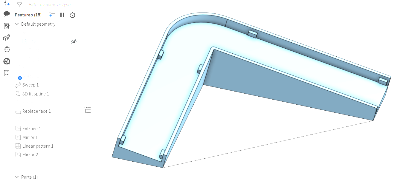

Are you looking for something like this? I used a loft with some guide curves.
Here is a version using a sweep and replace face. Features down from 32 to 15. See next part studio for mitered corner.

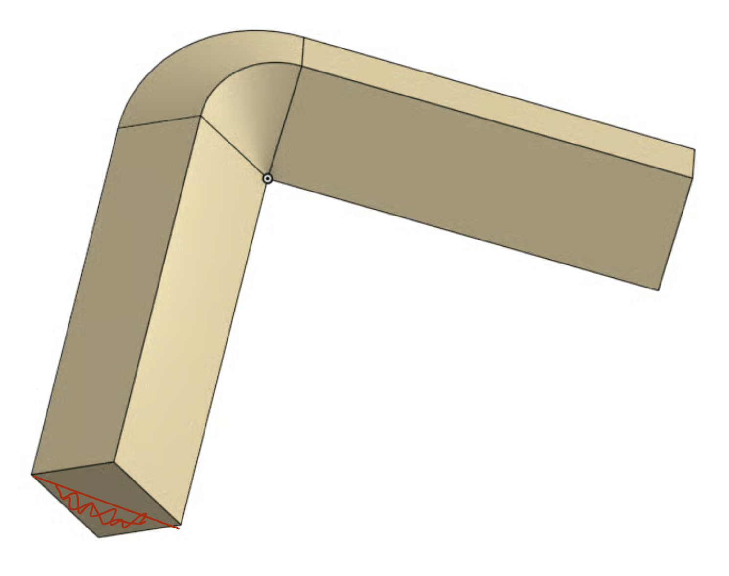

The only thing is that I wanted to have a 3 sides like this:
But I guess I can just extrude and remove it afterwards.
Hi Glen, I wanted it to have sides also turned at the angle, similar to what kenton_persons suggested.

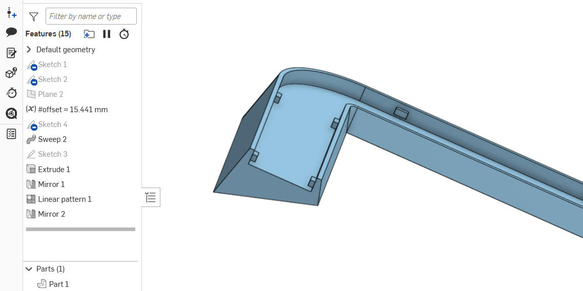

Modifying the sweep profile is all that's needed. If set up correctly even the replace face can go away.
Attached is with the replace face eliminated and the sweep profile has been up dated to what ever you need. IMHO the sweep can get what you want.

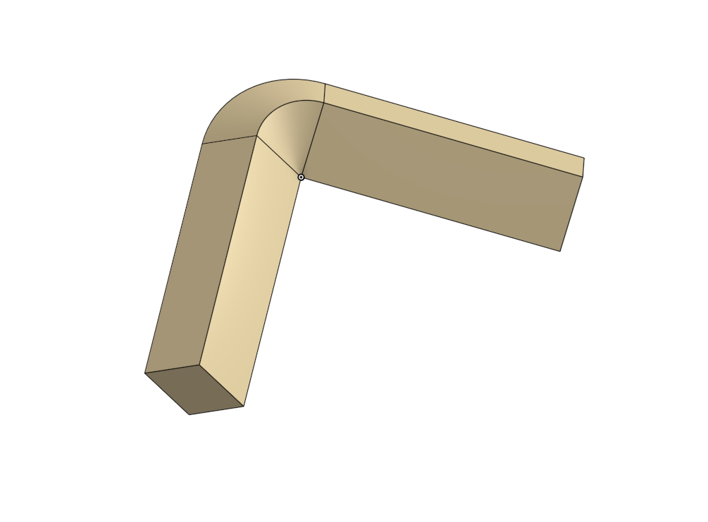

To make it 3 sided, just sketch them that way, one on the front plane & one on the right plane and extrude them to the length you want. You should be able use the same technique with any shape. Then use the guide curves with the loft command, making sure that your curves are tangent. Hope this helps.
