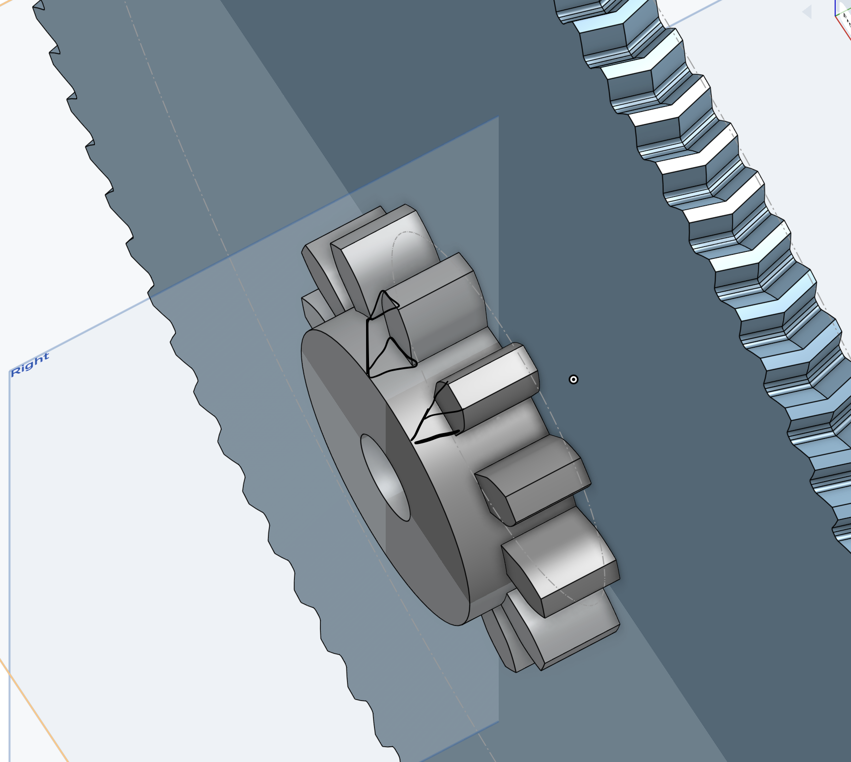

Im trying to make dog teeth like annotated below, any ideas on how to make this in onshape? ive tried fillet, chamfer and played around with draft but to no avail.

    Something like this: https://cad.onshape.com/documents/de84ba5bf393d7d09ca79002/w/b4b8d32259f60b7006b54d3a/e/a9ccd33aea444c959bb479a6
  • Werner
    Werner Member Posts: 5 ✭✭
    The best way is with "Spur gear", you can find this in the
    Onchape Add features list
    it has all the possibilities
