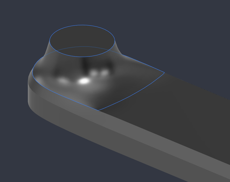

How would you create this blend?
Part studio link
I've been encountering this blend a lot lately and it's been really tricky to get it to look good. At it's core, it's a fillet between a cylinder and a flat surface. But how would you approach that when your fillet extends past the bounds of the starting surfaces? I've had mild success, but often most approaches end up with some wonky zebras or else some really weird pinching. I'm attaching some screenshots for reference:

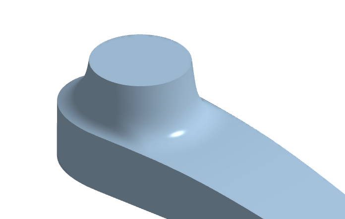

This is the more like what I'm trying to achieve, using T-splines in Fusion (you can ignore the chamfer if you want):

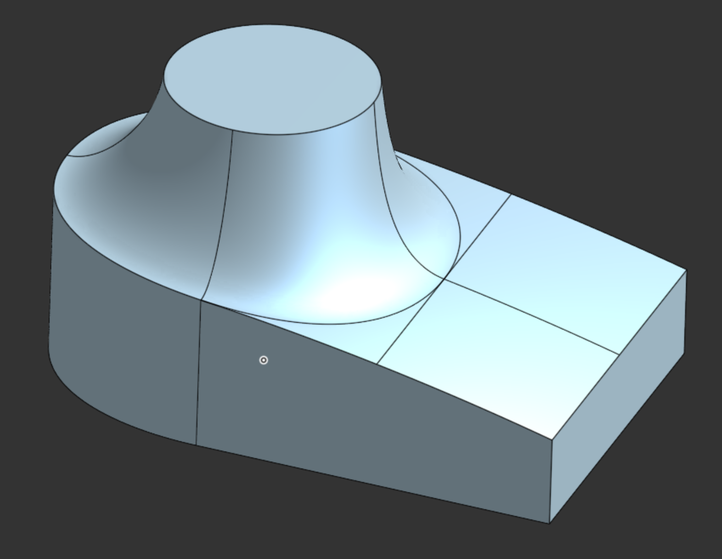

I've got something in a part studio and it mostly looks okay, but I'm curious if anyone has other approaches!

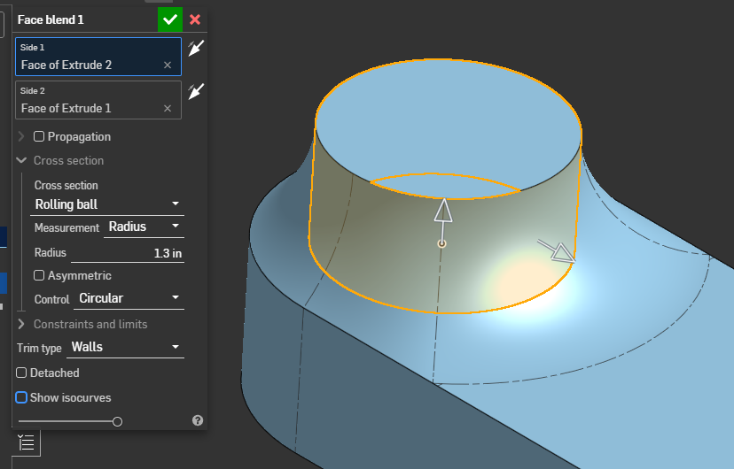

I gave it a shot with just a face blend feature and got something that looks ok to me, but that might not super well depending on the dimensions and relative sizes of things…

Thanks @John_P_Desilets and @eric_pesty. Looks like I really need to try using Face Blend a lot more. Generally, I can't get it to work because I don't truly know what all the settings do.
John, your surfacing is pretty much up my alley. It's super smooth! What you did in Sketch 5 seems to be what I was missing from my patch layout. I probably need to clean up my underlying surfaces too. Thanks for the input!Ramon Yip | glassboard.com
