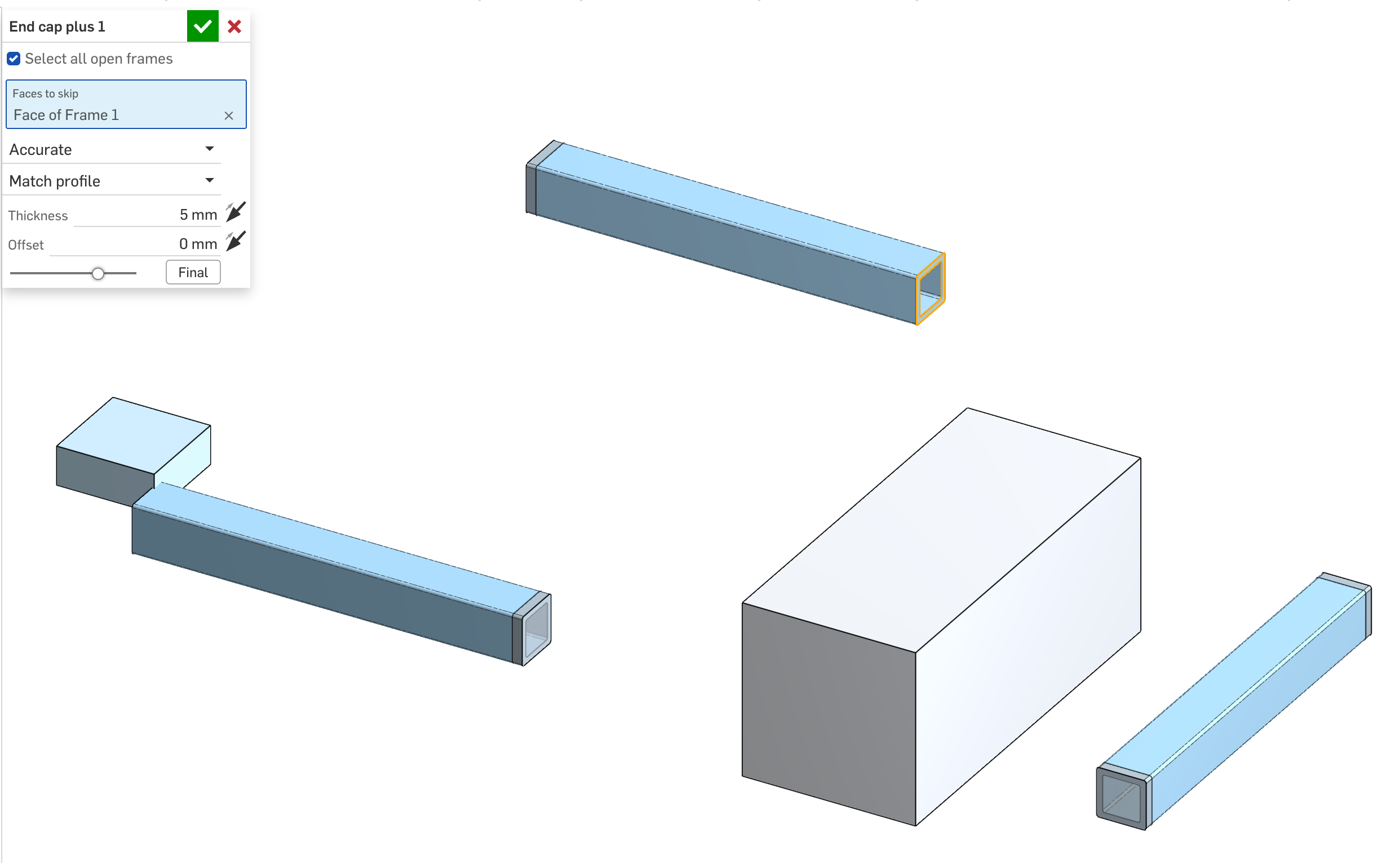

New Feature: End Cap Plus
S1mon
S1mon Member Posts: 4,636 PRO
New feature built with help from ChatGPT Sol and Onshape MCP.
https://cad.onshape.com/documents/bd99601ff5b8641af79ceafa/v/aaa9be724e67cb3e33ed481d/e/cc5bfce1df64a3b5a595ee9b
Description: Use the standard End cap workflow with manual face selection, or automatically discover and cap every unobstructed open end of hollow Frame members.
Prerequisites: Frame members. Automatic selection requires hollow profiles and intentionally ignores solid bar stock.
Notes:
  1. Leave Select all open frames off for built-in-style manual selection; enable it for automatic discovery and optional exclusions.
  2. Accurate is recommended for off-center obstructions; Quick is faster but only samples the center ray.
