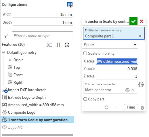

That makes an edit after the fact pretty hard to do. I have come to an alternative logo-workflow where I would import it as usual, into it's own part studio, then scale it to something 'round mumber' like say 100 millimeters in width, using the first dimension in the sketch, then fix everything in place. After that, I create surfaces or an extrude from it and apply a scaling factor to the relult by means of the transform feature.I derive that into my design and use projections or booleans, whatever is needed. I can then go back to the transform/scale feature and type a new size at any time without breaking anything, or even make logo size a variable.
I usually do it this way:
This way I can import into a new part studio the logo with a proper size in one go.
I'll transform (MC to MC) it into place afterwards.
then boolean it off/on or split face etc. Possibly after a 'replace face' with offset face set for curved faces.Best to do this in a separate document (perhaps in a logo library folder) so it's easy to find and import into new projects for proper reuse.
