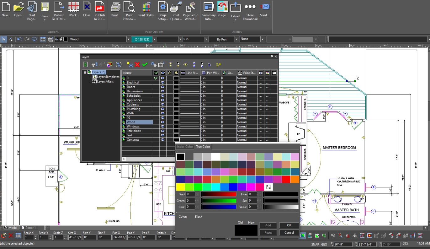

A layered DXF will consist of drawing layers which the Cam software will import and read and then convert to G code for the machine output. Different layers will be interpreted in different ways such as external cut, internal cut, hole drilling, partial depth hinge holes etc. Layers are also used for architecture drawings where certain things can be shown or hidden very quickly and easily.
