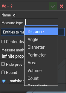

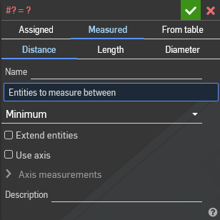

    Unfortunately, that functionality isn't available yet. Occasionally, I'll put down two lines, dimension one and make the other one equal to the first to give me that functionality.
    For what you need, you can create a Variable and select the option for Measured. Otherwise, the Measure Value custom script adds even more functionality.
